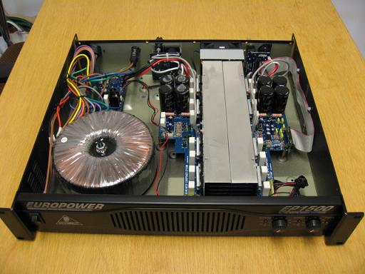

The EP2500 is a close brother to the the QSC RMX2450, and teh EP1500 is close to the RMX1450. The build quality is as good as the QSC's. I have schematics for the EP amps if anyone wants them. Schematics are available for the QSC amps as well for those who'd like to compare.

Tapco transformer is much bigger, and it has two fans.
"assuming that's top to bottom, Tapco, QSC, Behringer?? "
Yes: T, Q, B.
"but sometimes its the bits you can't see that count, like clip limiters and protection. "
Yes, but the schematic for the Tapco is IDENTICAL to the QSC. So is the basic Behringer, but it has different protection circuits.
The caps look bigger on the Tapco but they are the same µF, just 80V vs the QSC being 63V. A bit of safety margin for high line voltage conditions, plus the bigger can size allows it to run cooler for the same ripple current (for longer life).

Next time i have my camera at my friends house i'll pop open his EP2500. From what i remember the transformer is not that small. I think in the first round of EP2500's they used a smaller transformer, but now you get one as big as the Tapco's.

Well at least Behringer seems to save on transformers sometimes, I don't know about the others.So there seems like there is no rule (at least not without exceptions) about transformer size among manufactures of these amps.

I know this thread is years old. But, it closely matches my problem.
I am working on an EP2500 that is clipping in one channel. I have a schematic (Page 1 of 3 pages) dated Dec. 7, 2004. The amp has a build date in 2001. And, guess what? The unit is missing many of the front end (IC4 and 5) components. Also, most of the components are not numbered in accordance with the schematic.
Anyone have a schematic that matches my unit?

maybe they're SMT's under the board? i've seen a couple amps like that.... IIRC some of the Behringer amps have SMT op amps.
First time I serviced a Behr EP something - forget if it was 1500 or 2500, probably 1500 - I went nuts trying to find certain parts on the board for a channel. it took me a while to actually look and realize the boards were not mirrors and some of the channel circuits were all on one board.
SO if you can;t find certain parts, try looking on the other side of the heat sink.
The limiter is IC5A for one channel, IC5B for the other.

I have looked and looked and looked. I have used a mirror to look under both PCBs. I have used a magnifier to peer deeply into the soul of the PCBs. And, I cannot find the ICs.
I cannot reconcile the part number (T12, D37) differences between the schematic and the PCB. I am beginning to think that there are two different EP2500s; The one I have on the bench and the one in the schematic.
Anyone out there know where to find the ICs?
