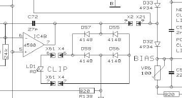

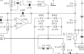

one clue i was able to find in the schematic is a difference between the two channels, and how the op amp connects to the bias network. one side goes through a connector, the other one doesn't. if i can't attach both pix to one message' i'll put the second one in the next message...
the previous one is the one that connects through a cable, this one has the IC on the same board as the rest of it's channel (so this channel is where the chips are located) if you can find the cable that goes between the amp boards, you should find the chips

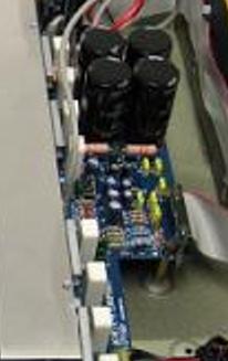

looking at the pic on the previous page, it seems the amp board on the right with the wide ribbon connector going to it has a few more sq in of real estate. are the chips in the vicinity of the large group of yellow mylar caps?

Yea, I have looked with a magnifier and cannot find a single IC at that location.

I am beginning to think very strongly, that Behringer had 2 builds: One like mine without the ICs and one with as shown in the schematic. I just wish there was someone out there that has gone thru this before and could settle it for me.

only other place they could be is the F/P board that schematic is rev G, so there may have been an early version without IC's, unlikely as that is. usually a design that fundamentally different wouldn't share the same model or series...
