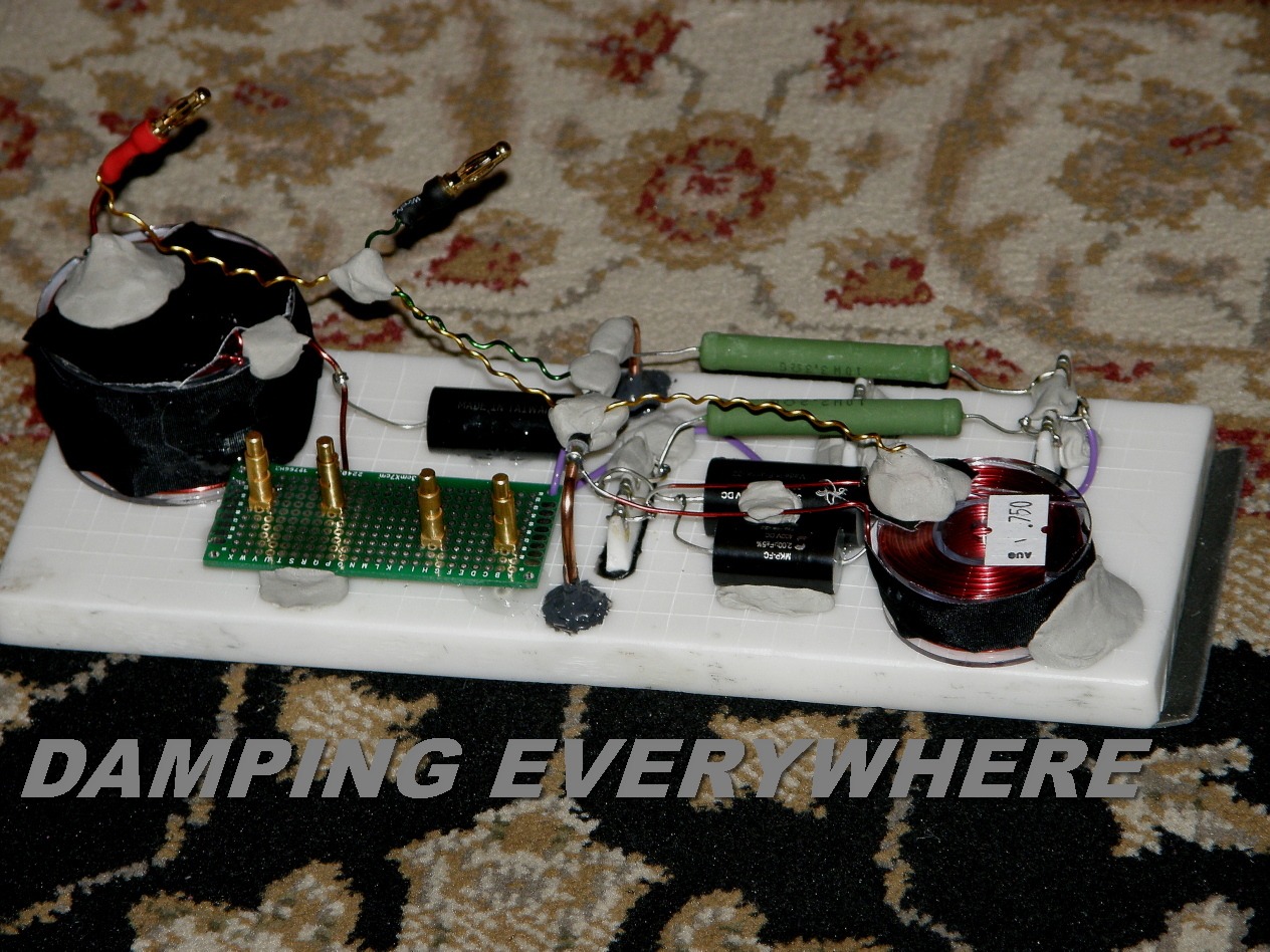

I don't recall how it happened, but I ended up with a bunch of Mapleshade single core 'plus' version of speaker cable. So much so, that when I built this last set of speakers, I decided to use it throughout the build, including the crossover. Now, if you have never worked with this stuff, it takes practice. I am supposing that the thin insulation on this maybe 20 ga. wire is enamel, so it has to be gently scraped off unless you don't care about the silver plating. And me being me, after that is done and using some mechanical connections (strong spring-loaded brass posts), a film of De-oxit is applied. I take so damned much time on stuff like this that I really think that therapy would be cheaper.

Dude! That is therapy! Nice work too.I don't recall how it happened, but I ended up with a bunch of Mapleshade single core 'plus' version of speaker cable. So much so, that when I built this last set of speakers, I decided to use it throughout the build, including the crossover. Now, if you have never worked with this stuff, it takes practice. I am supposing that the thin insulation on this maybe 20 ga. wire is enamel, so it has to be gently scraped off unless you don't care about the silver plating. And me being me, after that is done and using some mechanical connections (strong spring-loaded brass posts), a film of De-oxit is applied. I take so damned much time on stuff like this that I really think that therapy would be cheaper.
