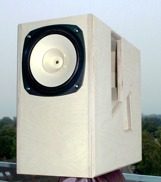

this is the smallest cabinet which I've run a 1772 stand alone - FWIW, this cabinet has a curved reflector panel per Fig.6 of
Karlson's last Acoustic Transducers patent
it has been run in the tiny Karlson 8 from 1955 where it needs a woofer/sub
http://youtu.be/yWnKpr4coPE

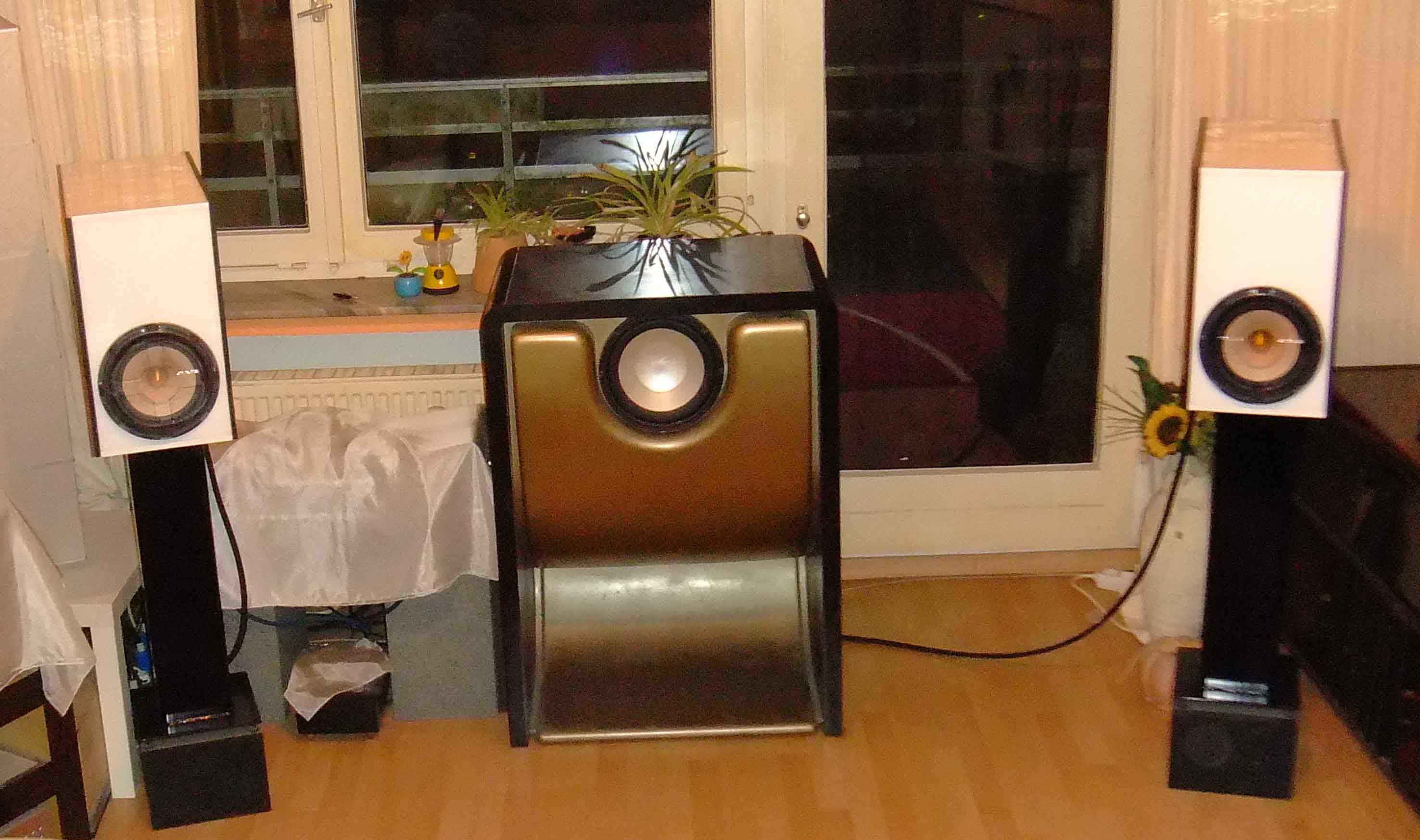

Schalmei SAT
Hello,
my Trumpet, Horn and SCHALMEI satellite.
and a few double horns work superb with the TB
Hello,
Thanks you two.
I know the wife will not approve the Karlson.
But the SCHALMEI satellite looks like it could be something interesting... although, looking at the plans, I'm not sure I'm ready for such a construction!
