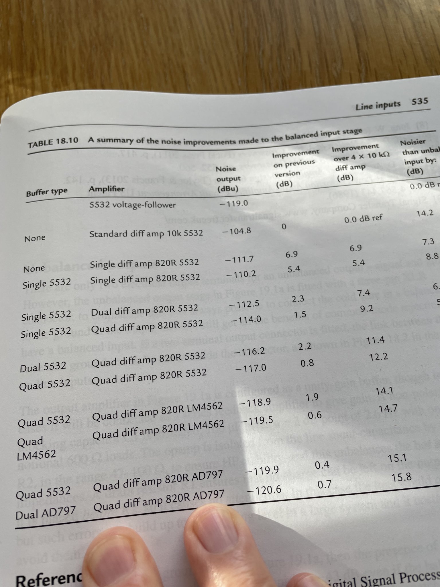

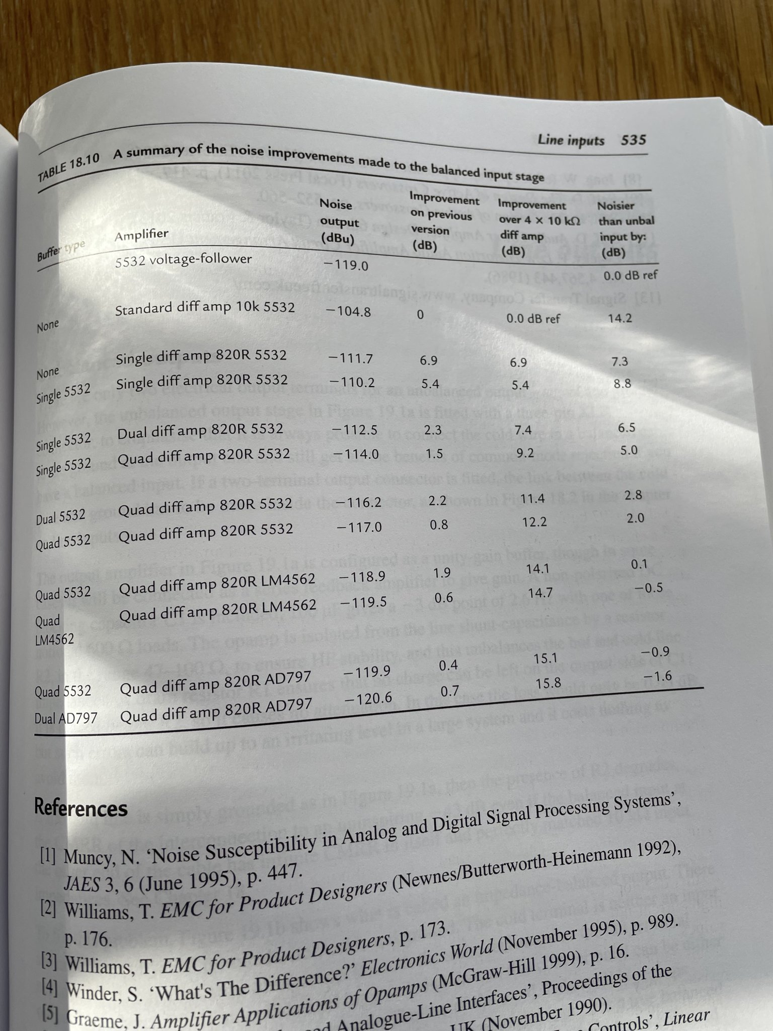

Chris - I think you are confusing intuition with subjectivity. Intuitively it feels like adding active components must add noise right? I felt the same way to be honest. But once you follow the logic and the math it all starts to make sense.
You will find references to this technique in “The Art of Electronics” on page 495 where they use 5 transistors instead of one to reduce noise in a moving coil preamp.
The measured data and corresponding circuits are as shown below. From “Small signal audio design” by Douglas Self. If you have an interest in line level signal circuits and your participation here indicates that you probably do then I can strongly recommend this book.

Many amps have far lower input noise power than a resistor already. Take the JFE150 JFET, input voltage noise 0.8nV/√Hz, input current noise 1.8fA/√Hz, both being about 100 times lower (40dB lower) than a 444k resistor (which has the same ratio of voltage to current noise). To have lower voltage noise than a JFE150 a resistor would need to be less than 38ohms, to have less current noise it would have to be more than 5 gigaohms... All ideal resistors at the same temperature have the same noise power spectral density.Are you saying you seem to think, active devices are somehow by adding further active devices are lower in noise than a resistor ? 🙂
So active circuitry can be made to be far far quieter than the resistors, and allows resistor values in an attenuator to be much smaller (and thus have less voltage noise than the original passive atttenuator which is constrained by the source impedance.) The AD797 opamp's input FETs are similar in performance to the JFE150 if you want an opamp example.
