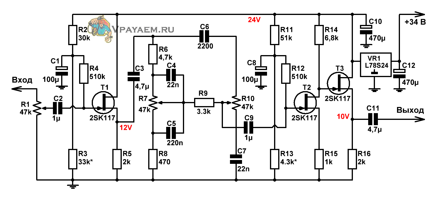

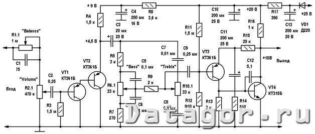

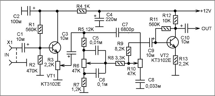

The most flexible approach is always active volume and tone controls, Baxandall topology is the obvious choice as giving good performance allowing both attenuation or gain without loss of headroom, and good channel matching through the use of linear taper pots. You can still do this with all through-hole components too, even now.
Having gain is important, some programme material is at a very low level, if you only have attentuation you are scuppered!

i disagree, adding active circuitry just invites reactance and noise detracting and blurring from capability of the source. The task you are attributing to active volume, is not thinking outside of the square , where passive resistance can be arranged and can be made adjustable. Describing a circuit that does this for lower volume imagine a L pad providing 25 mega ohm series resistance on the series element at zero volume, and not relying on the shunt element at all for achieving silence at zero , The shunt element commencing at 1.25K at zero then largely at lowest volume does not interfere with the source impedance. As volume progresses it just gets better for such a passive, with then also ability to adjust the shunt element upward further as music taste dictates at any volume setting.
@Chris Daly adding active devices does not necessarily add noise. In Doug Self’s book on small signal circuits there is a section on “how to attenuate quietly”. In this he demonstrates that at typical signal levels and circuit impedances you will improve the signal to noise ratio by 15db by using op amps rather than passive circuits.
This is solid, repeatable and measurable. His sample used a 5532. There are quieter opamps than this now.
