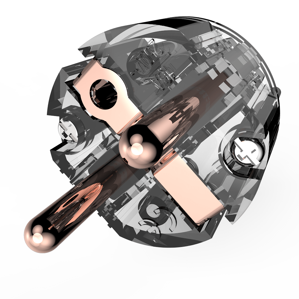

We are working on it. Schuko plug from Viborg - should be a drop in fit. Circuitry inside has been designed to be compatible with both voltages.

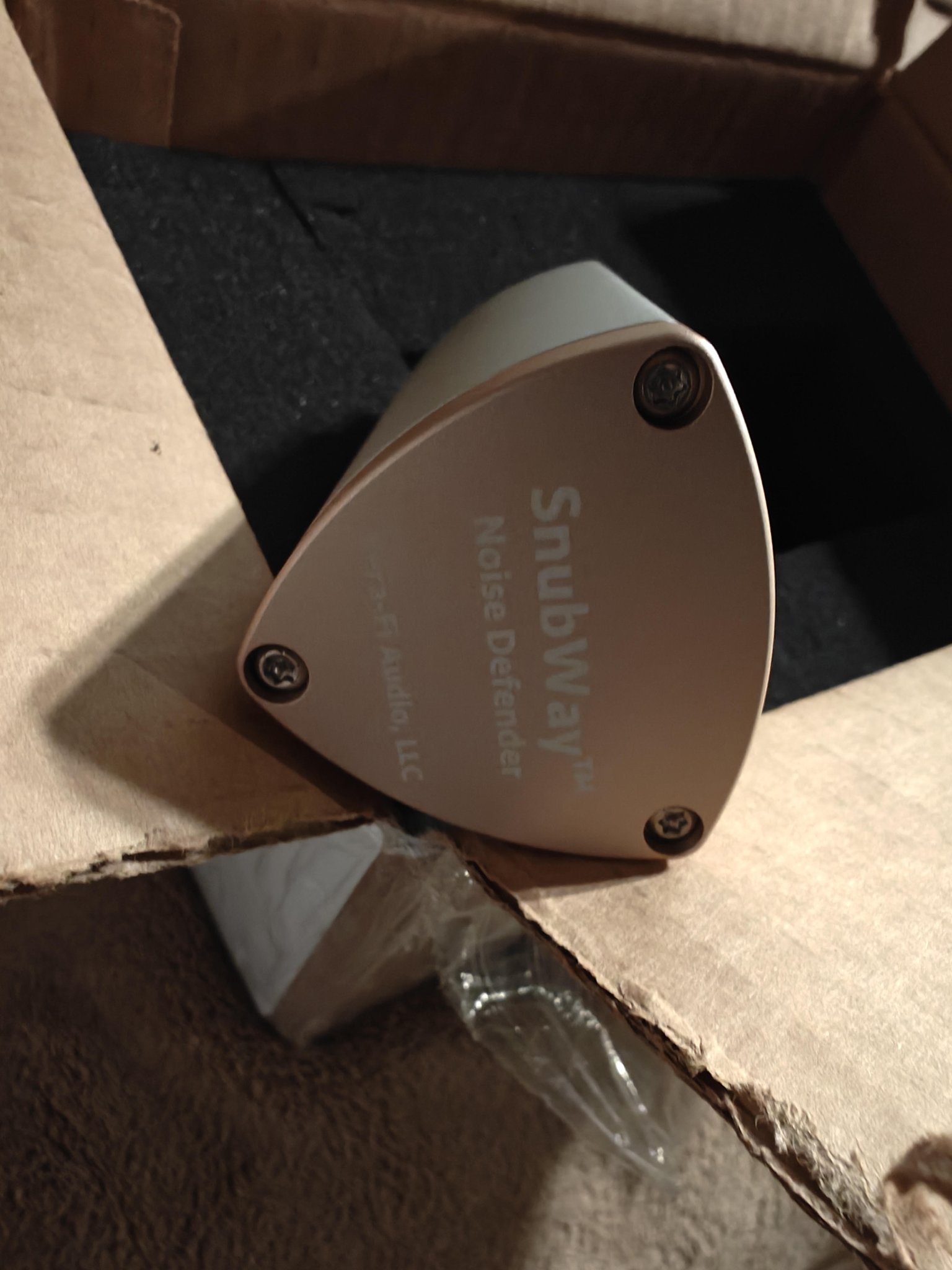

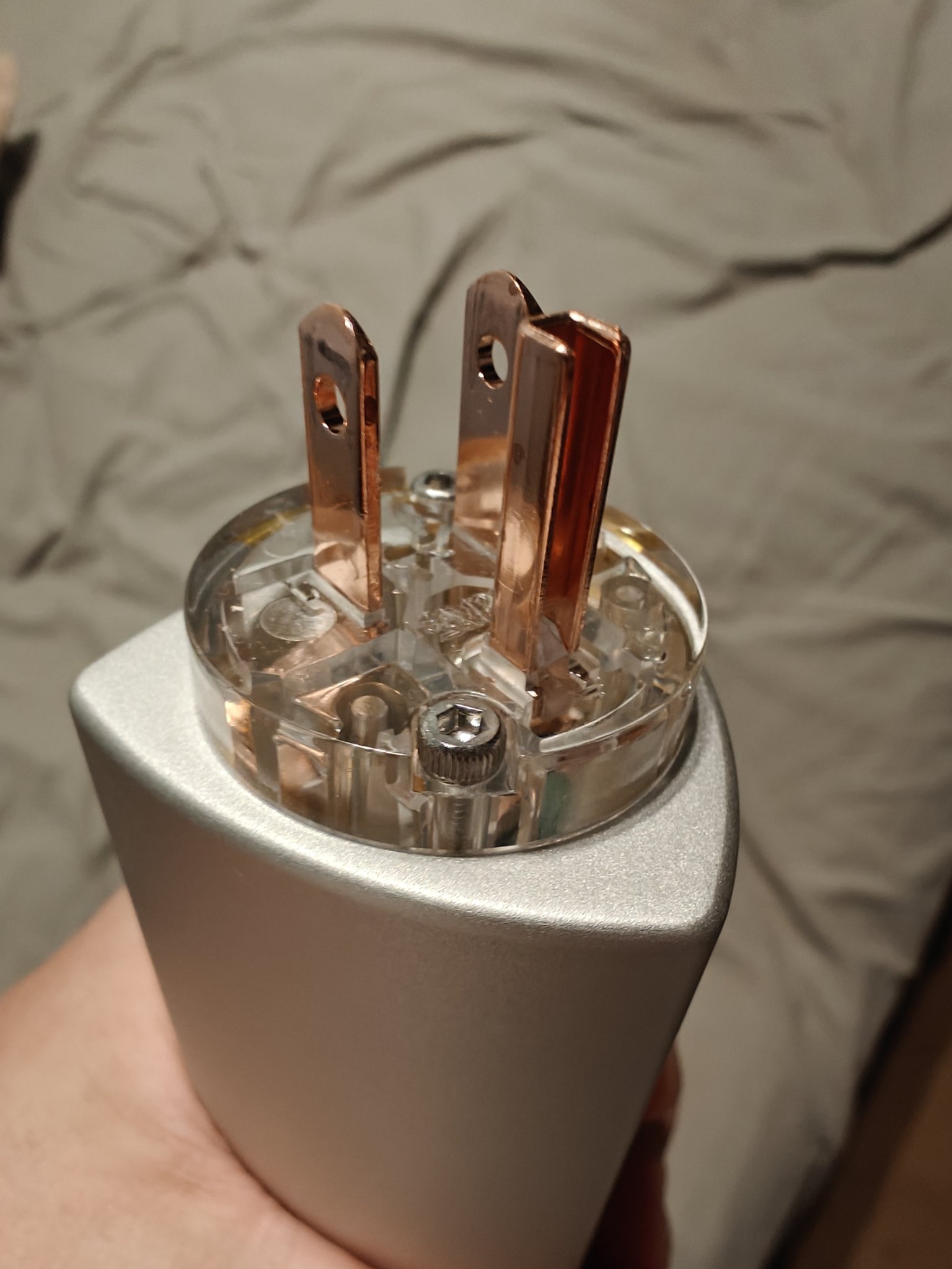

snubway arrived today! wow it feels hefty and solid, the case is nice and thick. the prongs are shiny and polished and look like copper
Those are solid pure copper terminal blades on the plug from Viborg.
I love how it feels in the hand. I wish car shift knobs would be made like this.

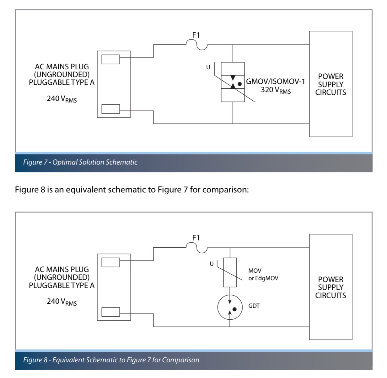

It looks like you have an MOV in this. Do you have a fuse and a thermal fuse? Both are required for UL1449. Were you planning any US safety approvals?
It’s a combo MOV + GDT. We were only planning on getting CE. All requirements to meet code are followed (Y2 and X2 caps where appropriate) and the case is grounded to the PE GND pin, plus creepage requirements are met. I believe there is a non-replaceable fusible link (large SMT resistor) on the L pin.
You are in a metal case so its not a big issue but first, GDT across the AC line is not a good idea- once they flash over they continue to conduct until the power is removed. On MOV's there are fault conditions in power circuits that can cause them to sit and cook until they catch on fire. (Both are issues from experience). The thermal fuse is to disconnect the MOV when it overheats. If the two devices are in series that works but the protection is at a higher voltage. PM me if you want to go deeper into the murk of Surge protection etc.
Its the law of unintended consequences. Its not a big issue in a metal enclosure. Its difficult to start a fire that way, however not impossible.
GDT ( Gas Discharge Tube) I assume

The hybrid GDT/MOV or “IsoMOV” product from Bourns essentially has a GDT and MOV in series so that the discharge in the GDT is self terminated by the MOV. This was exactly how it was designed to be used across L and N of mains input. But thank you to 1audio for pointing this out.
From Bourns datasheet showing equivalent circuit.
Are your caps rated for 900V? Its not much protection at 875V but also won't react unless something serious hits.
