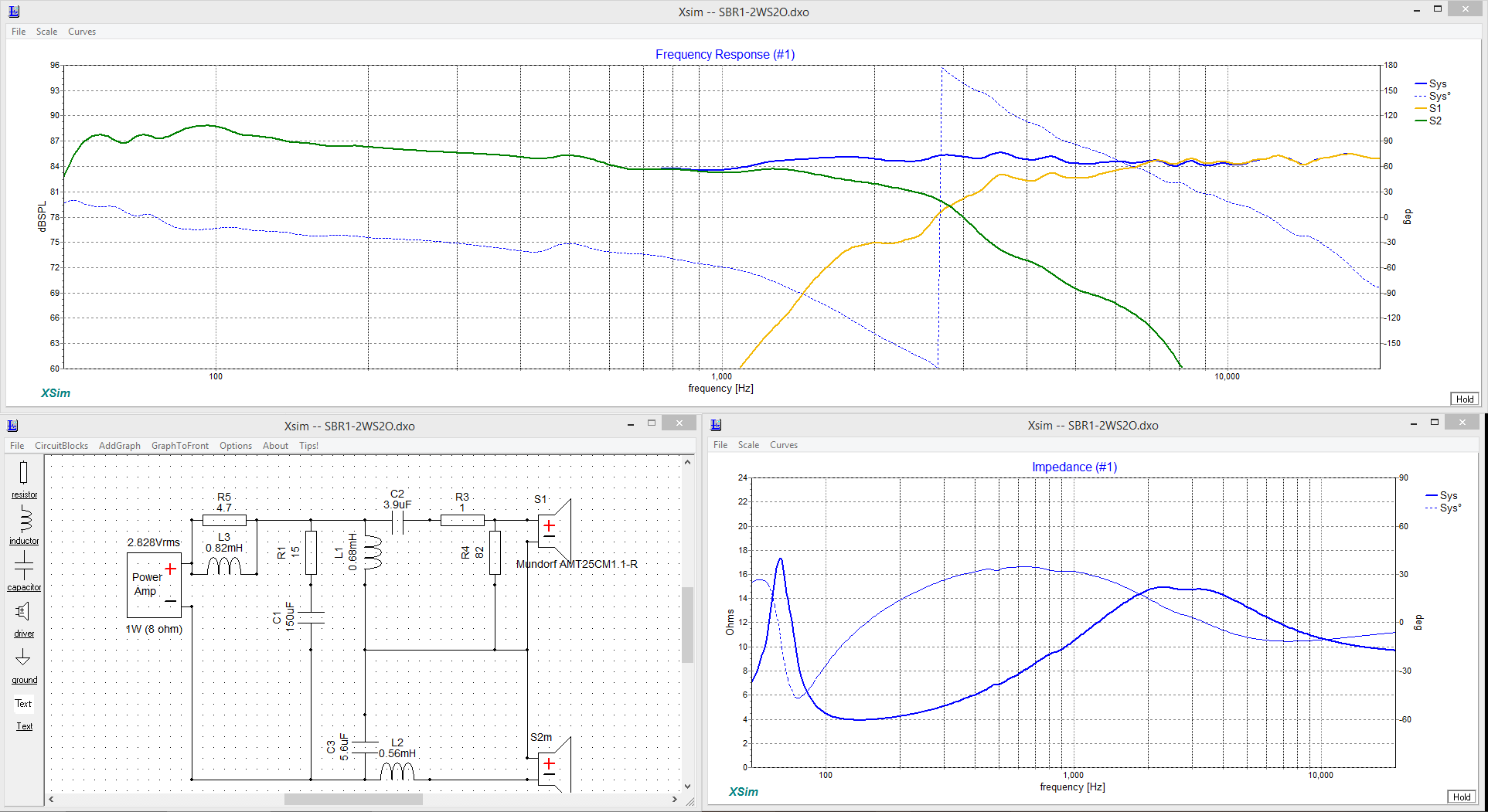

I'll took a go on this crossover (after all the fuzz) to see where it brings me. And considering all things, i don't see the problem actually...
Here is how i would do it (assuming the measurements are on point). A second order serial crossover with BSC (calculated on a guessed baffle width of 25cm) and zorbel, and an Lpad to tame the treble a bit. Included is the XSIM project
  • SNR1-2WS2O.zip
    SNR1-2WS2O.zip
