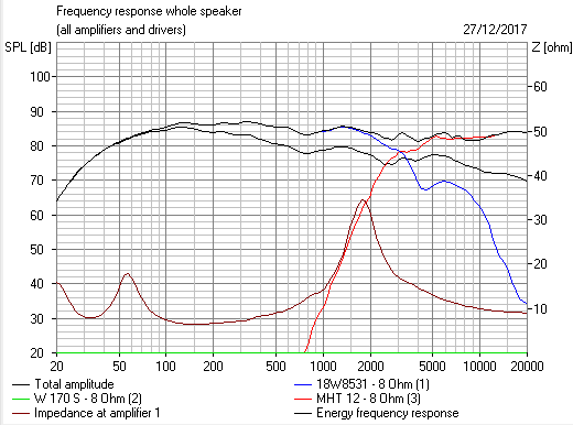

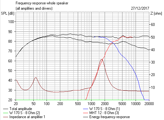

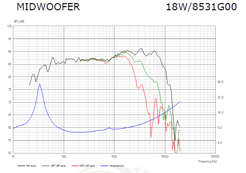

We had a thread a while back about merlinx76' problems with the ZRT 2.5 Zaph design. A poor and overly simplistic and low filter with a difficult 18W8531G00 driver, IMO. And I DO have the FRD and ZMA files for this driver direct from Zaph himself.
631747d1503519019-zaph-madisound-zrt-2-5-a-scanspeak-18w-8531-g00-png
Erik mercilessly trolled it with his opinion that the 4 ohm 18W4531G00 is great in an MT. It didn't help at all, because that is a very different animal from a poorly implemented 2.5 way. 🙄
Now I am having to suffer his gibes that only I and Troels Gravesen find the 18W8531G00 difficult. It actually isn't too hard if you have the right idea. But, TBH, I'm not sure Erik has the right idea at all. 6dB slope with a 4kHz notch? Really? Best you can do? 😀

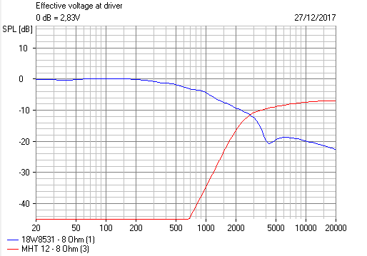

I brought your name up here out of respect and completeness. I really don't feel I have mercilessly trolled you or anyone else. I have been just as stubborn about my opinion as you are of yours, and as I have pointed out, I strongly suspect there has been an undocumented engineering change as the spec sheet and the drivers I have in front of me (sounding great) simply do not match.
As for the 1st order electrical that you point out, that proves my point that this driver is easy as cake to use. If this driver was nearly as difficult as described by others who do not have the drivers in hand such a gentle slope would never have worked.

No, you still aren't listening, Erik. 😀
The Scan woofer might work OK on a 6dB, but actually gets much harder on 12dB or even 18dB. We are, after all, not in the business of building LGWAG speakers. We want to be able to play Mendelssohn's Elijah!

Happily, I feel confident a 2.5kHz+ crossover is possible here. Impedance takes a beating, but that is what happens with ill-behaved drivers that force you to depart from optimal values. TBH, I think a Peerless 830874 or 830875 would make more sense. The poly dustcap works better than anything paper. More damping, you see.

If you`re talking about the Scanspeak + Mundorf project subject to the thread (sorry, got confused a bit and flu`s taking the upper hand) - I still use the 4 ogm version of the woofer crossed at 2.5Khz and I don`t like it. It beams like hell and moving slightly offaxis (like at 30-40 degrees) changes the sound. I am too lazy to rework these and don`t see any future in upgrading them either so not bothering for now and will not bother with them, but as a summary - this woofer becomes directional above 2Khz, quite a bit in my opinion and its cone/suspension is too heavy to be used even up to 2Khz (majority of other 7" drivers hld similar MMS). It ould be great if used as a channel filler, inbetween a quality large woofer and a coaxial CD loaded horn or helped by an upper midrnage dirver, like a 13-16cm Supravox or one of the newer Satori mids.

Perhaps the beaming issue is why Troels gave up on using this as a mid-woofer and why I completely avoided the issue? 🙂 I never attempted a 2.5 kHz crossover point, so have no idea how it would sound.

I'm guessing Troels is unhappy with what he perceived to a colouration just under the crossover point of his design, rather than the frequency response.
Easy/difficult is subjective.
When we have worked with many drivers, we would have many references, benchmarks and standards. If we worked with $600 drivers and it doesn't sound any better than our $500 drivers then we would normally think that it is a failure. (OTOH, the opposite is true). TG has also higher standard now regarding sound neutrality than he did long time ago.
If 3-way will improve the sound considerably, why the 2-way floorstanding? Two-way like Erik's seems to me a better option as bass response is so impressive. But lower crossover point will be easy if the tweeter is changed.
Looking from the SNR-1 bass response, if only we can believe it 100%, Erik has no midrange hump around 700 Hz. This is possible but only measurement can tell the truth.
But speaker design is not about how to put the drivers in their comfort zones. More important is that both drivers must work in synergy. This is difficult, especially in marrying such a woofer to an AMT.
What this thread lacks is quality measurements.
Gated measurements from 1-2m with gate set at <300Hz would clear things up. Measurements posted here are not measurements at all but simulation from Xsim.
On axis and of axis (0, 15, 30, 45 and 60 deg) measurements are needed to be able to see anything. These are too low resolution aproximations of real measurements.
And it is not even noted how the measurement curves were derived and under what circumstances/settings, neither is mentioned what setup was used and whether it was calibrated or not.
Cheers
He will not post these even if he has them because they will reveal what is known as a Klingon Bird of Prey sonogram. The chosen crossover frequency (not sure why) is too high for the 18W and the AMT has high dispersion there. Besides, the transition from an MMS of 18gr to an AMT will be audible, as noted by a post above. This is why on the posted simulations tweeter level is recessed by a whopping 5db (no wonder why they were described as warm sounding because its the woofer that dominates) and on these measurements the woofer appears with much higher smoothing than the tweeter. The asymmetrical crossover used I would be curious to see how would do in the vertical plane. And then 88db from this woofer indicate low bsc applied (evident by a small 1mH coil), if these are to be placed close to a wall or used with a sub - fine. They present a moderate load to an amp - about 4ohms at 140Hz and phase at -15 degrees.
I don`t see impulse and step response either.
