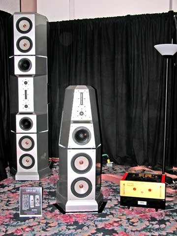

Great stuff noob, sounds formidable with 4 x 15" starring at you.
Surely you jest? A single 15" with a bit of EQ sounds better than the 800 or Sophia?
If that's true then I guess I need to stop work on everything I'm doing right now and get building something with Lambda's 😀
I think it would be fun to clone these guys next time:
I think the idea of this project is that when it's finished, there won't be a need for a "next time".
