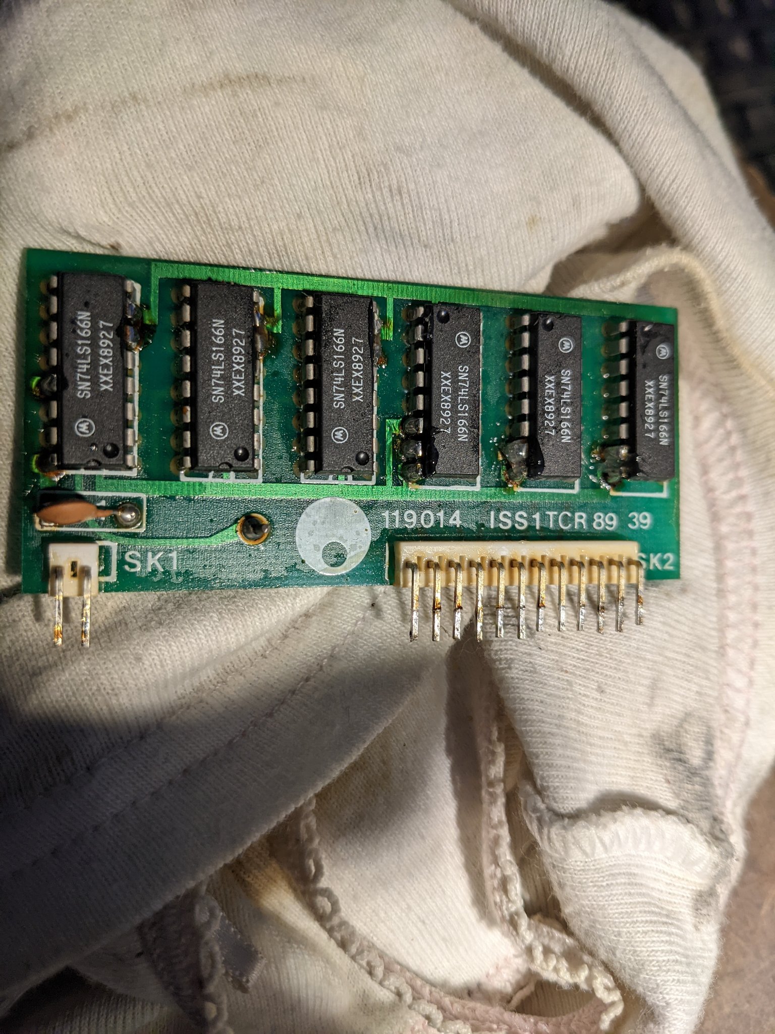

SN74LS166N shift chip why does it fail?

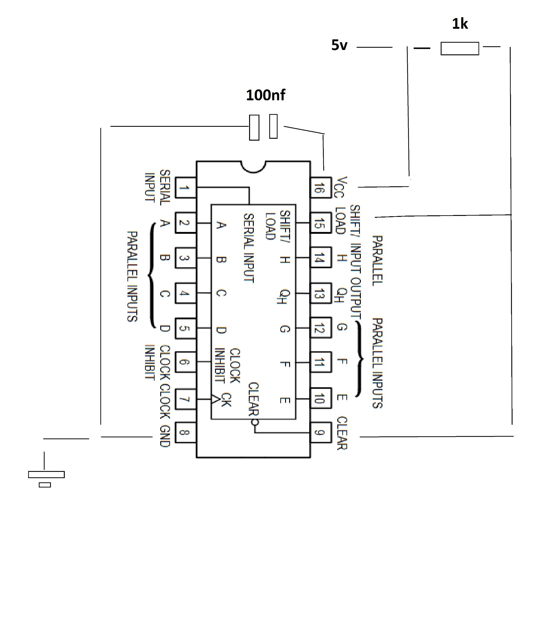

Thanks for the info. Assuming I left A-H as is, would the design below work or would pin 9 and 15 need their own resistor as in diagram #19?

Also with a decoupling capacitor each. The inputs are internally protected, so you could tie pins 9 and 15 high by connecting them straight to the +5 V, without any resistor.
Inputs A...H would have to be connected to ground or +5 V, or some to ground and others to +5 V, whatever is convenient. It doesn't matter which go to +5 V and which to ground, but they should not be left unconnected.

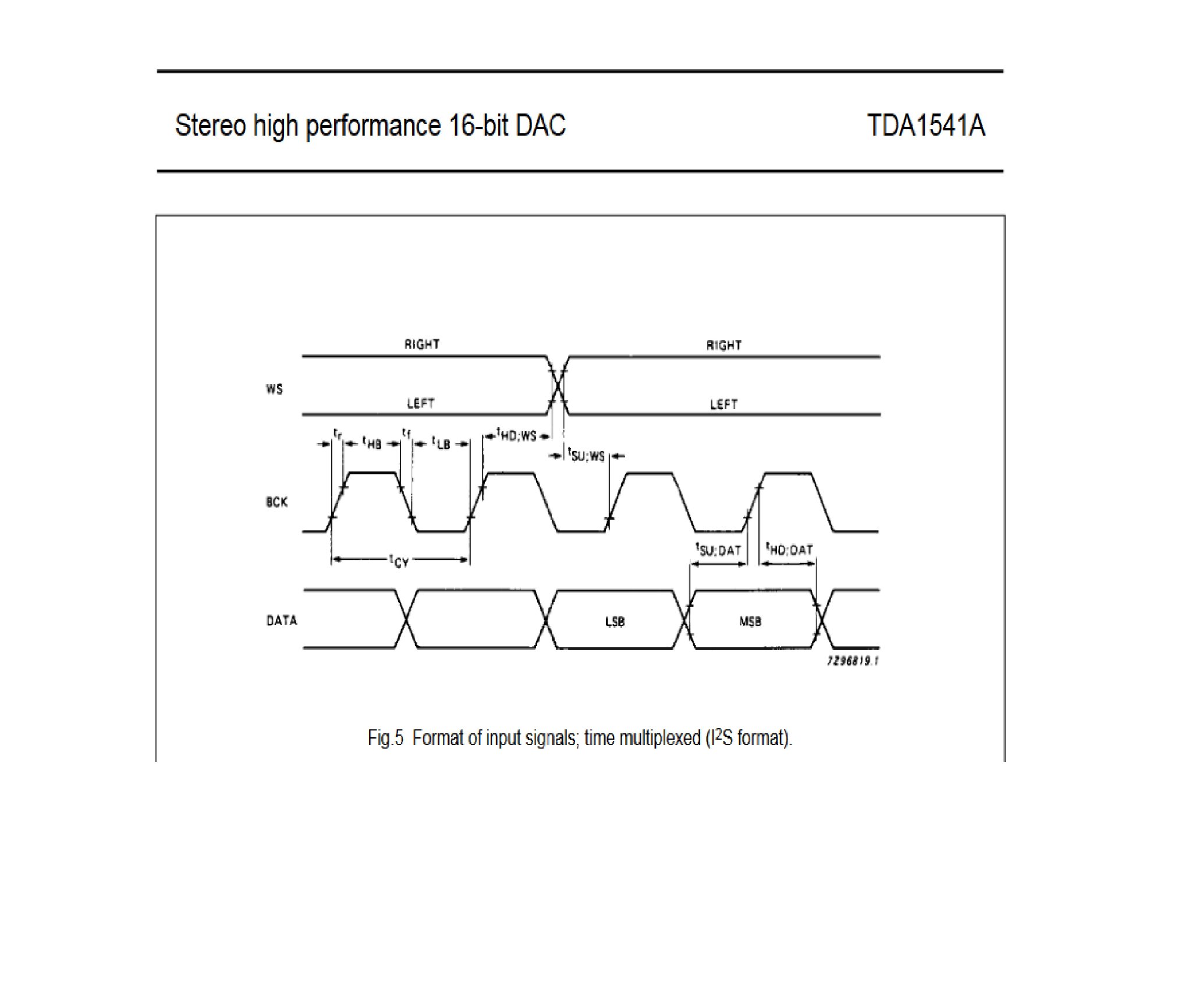

I'm not sure if current is of concern here. The lines that go through it are I2s lines from the oversampling chip. 3 data lines I believe. I'm not an expert so please don't assume I am correct.

Honestly I'm not even entirely sure what its purpose is, I just know that the CD2 is a very smooth sounding cd player and without these chips the sound is less smooth. And I do believe some people in the Ultimate DIY TDA dac thread have implemented a different version of this but its vastly complicated.
Thanks to you guys I do understand why it could have failed. I have found and attached my board from a while back when I did one. You can see it only has one single ceramic decoupling cap 10 or 100nf can't remember.
