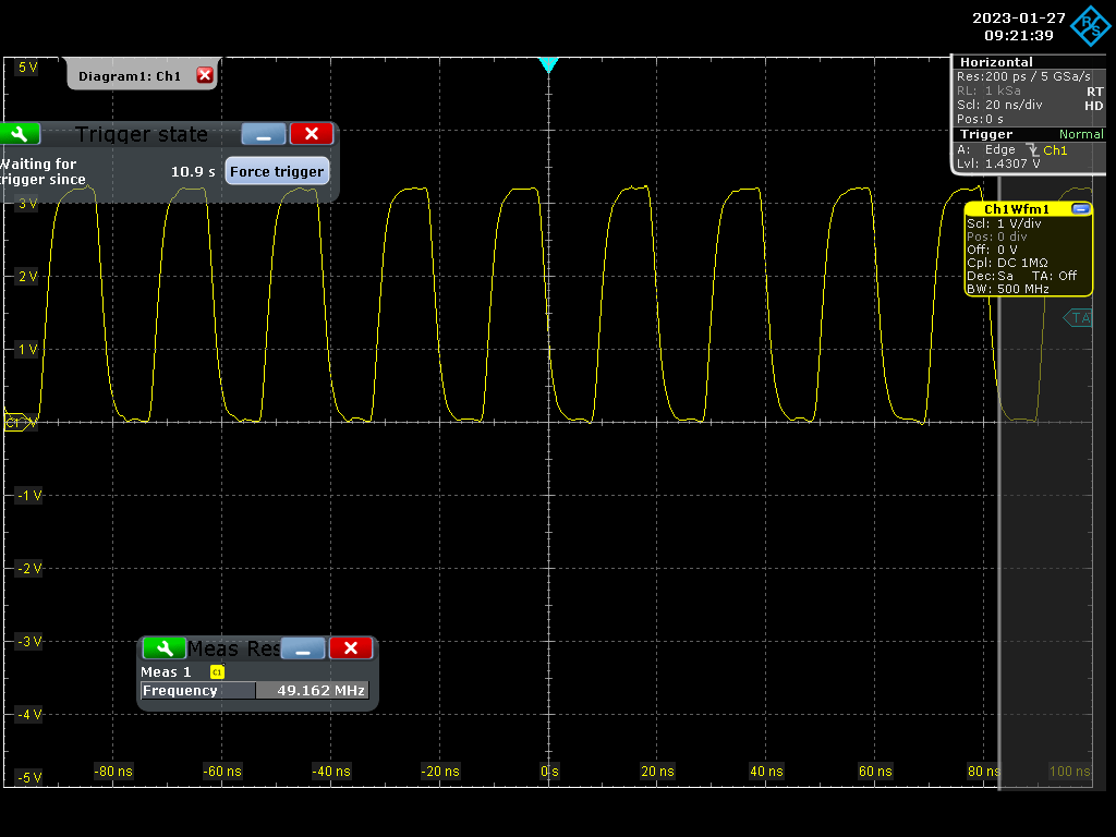

I then stared looking around the IC with the scope and I see that when the IC warms up, the clock on pin 10 (49MHz) starts to jiggle and it actually interrupts as seen below. The 24MHz clock coming from the TCXO goes to pin 2 of the IC.
Good clock:
Bad clock:
So it is clear that the IC starts malfunctioning due to some temperature issue. The IC temperature is around 51C (measured with a FLIR camera) so it is not that hot. I think it is probably broken and I think that when they removed the markings from the package (probably by laser) it might have damaged it. Or it is just a bad sample (lucky me ).

Just a short update. I ordered the IC and I will replace it once it arrives. I did another test and indeed the optical and coax input work just fine when the USB doesn't. SO this IC is only used for USB playback. I guess that the clock is generated differently for COAX and optical. I just want to add that I also measured the Vcc voltage of this IC and it is 3.28V. So this is definitely ok. Not an issue of over-stressing the IC. It does seem though that the problem is getting worse as time goes by. Now even if I cool it down, it won't work.
I received the IC and I managed to replace it today. BINGO!!! It works just fine. It plays without any interruptions. I looked with the scope at the 49MHz clock that is used by the ES9038PRO and it looks a bit better than with the original IC. I also uses the hot air de-soldering station to heat the IC up to 70C and I did not get any interruptions. With the previous IC, when I did this, it almost instantly stopped playing. Now it works just fine.
So I think it's safe to say that the problem came from this IC. It was either damaged during production when its markings were removed, or it wasn't a genuine part. I replaced it with a SI5351A-B-GT that I got from DigiKey (https://www.digikey.ro/ro/products/detail/skyworks-solutions-inc/SI5351A-B-GT/3679847) but it can be found at Mouser as well (https://eu.mouser.com/ProductDetail...nc/SI5351A-B-GT?qs=p9T7GgSe1IEO%2BMfC/KPFfA==). I will keep listening to the DAC for the entire weekend and I'll report back if I see any issues.

This is the 49MHz clock that is used by the ES9038PRO DAC IC when playing 192kHz sampled audio.
