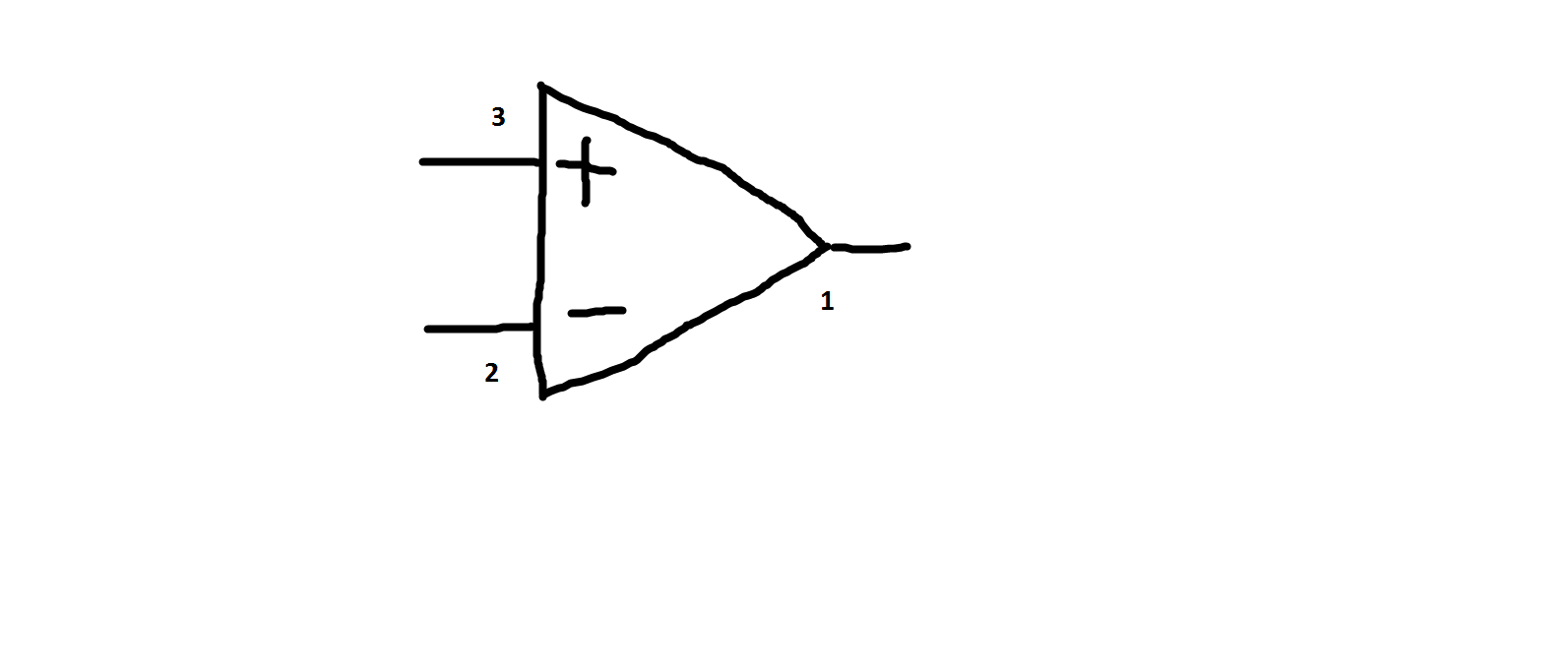

You should be able to get an idea of the circuit by drawing out the opamp and its components. You only need look at one channel, so that's say pins 1,2 and 3. Draw it out.
I see you have asked in the other thread.
I'm struggling a bit I can read which resistors are coming off each pin but after that I'm a bit stuck...

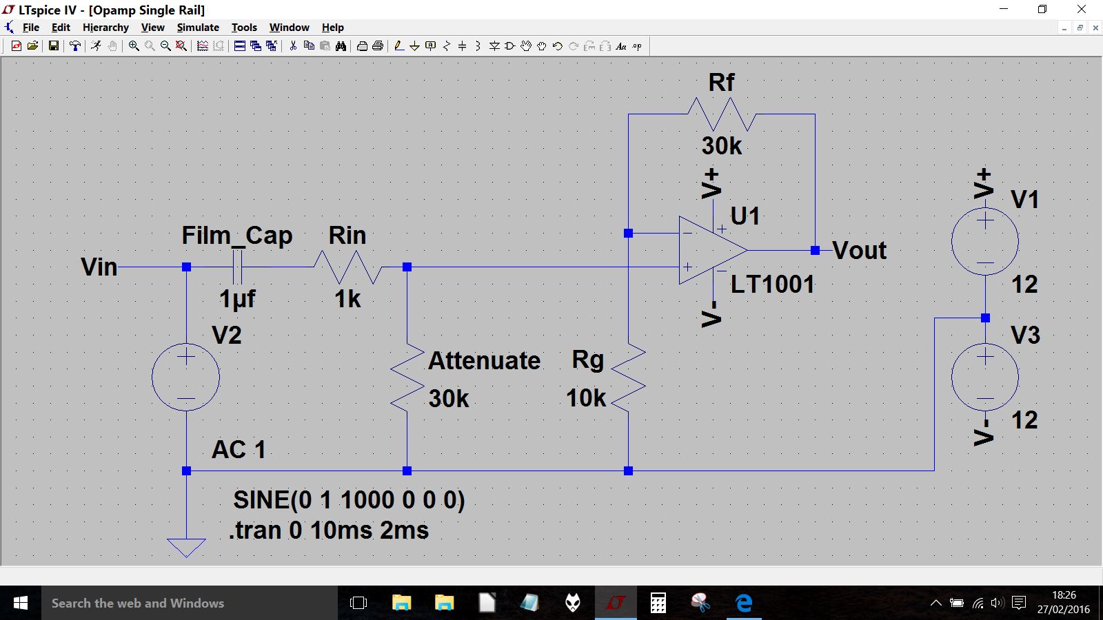

Not quite. I think you had the opamp pinout wrong. Looks like the signal comes in from the film coupling cap on the right via R20 (1k) and sees 30k (R19) from the noninverting input to ground. The remaining circuit is it's a noninverting amplifier with Rf = R17 = 30k from output to inverting input and Rg = R18 = 10k from inverting input to ground (values are a bit high for my taste, btw, those would contribute about as much noise as the opamp itself).
BTW, it's a good thing the OPA2604 is socketed, on +/-12 V it generally is not a particularly good performer save for RF immunity.
Assuming my reading of things is correct, you could put in like 1k for R17 for near unity gain. For the opamp, something not too fast and generally well-behaved would be advisable. I might try a lowly NJM4560, 4565, 4580, or 4556A. Less sure about the FET input side of things, maybe AD712? AD8620s are also nice but would require an adaptor board.

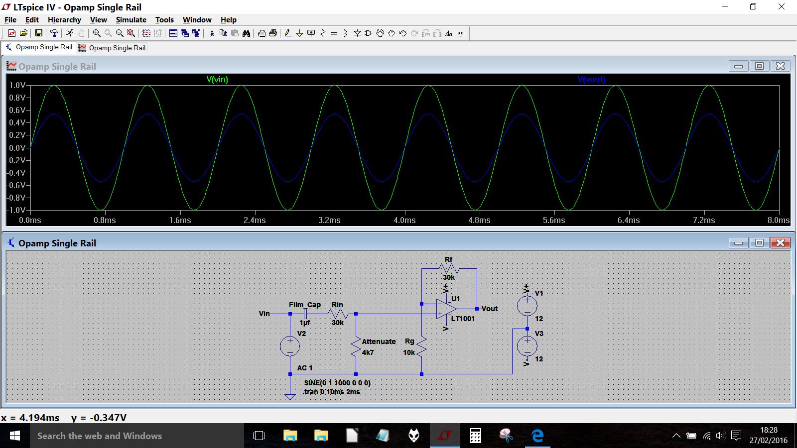

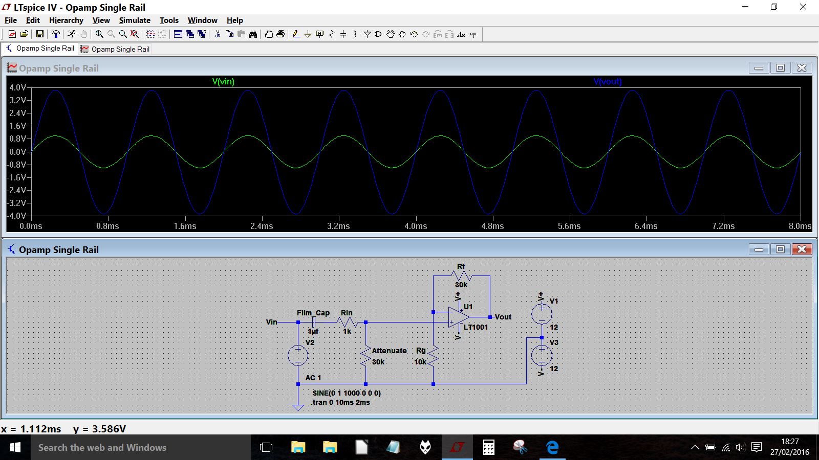

This seems to be the configuration you are describing which has a gain of four. The input voltage as shown is 1 volt peak to peak. If you look at the following images you can see the effect of the component changes on the gain.
Personally I suspect simply altering the input attenuator could be the way to get the best overall result. Noise isn't really an issue here and there can be sonic benefits to running an opamp with gain rather than with 100% feedback.
Is that how they are marked or is that what you measure ?

Rf is the one that connects the output of the opamp to the - input. If you short that resistor out so that it becomes zero ohms... and that's not the same as no ohms. No ohms means it is removed and we mustn't do that. Shorting it allows the opamp to function with a gain of unity (gain of 1).
Quick test you have the correct resistor... just short pins 1 and 2 (for one channel) and pins 7 and 6 (other channel) together.
If that is still to loud then we need to look at altering the input attenuator instead.
