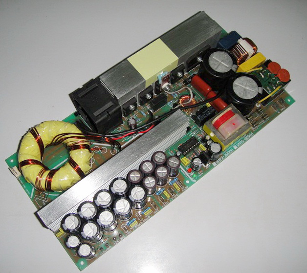

greetings need some help i am trying to make a half bridge smps 3kw
based on TL494 for a class d audio amplifier i have T63 round torridal core and
EE65 CORE smps working freqency is 70khz dc output rails are 90 0 90 dc +/-
i have managed to make the smps work need confirmation of primary turns and
WIRE GAUGE to be used on T63 or EE65 CORE hoping you can help out picture of smps attached showing T63 CORE😕

Hi FQR
greetings its a simple half bridge smps cloned from the picture above i cloned it from
the pcb today theres no schematic given by detex audio i wound T63 CORE USING 20 TURN
for primary pfc is way above my head just trying to learn basics of smps

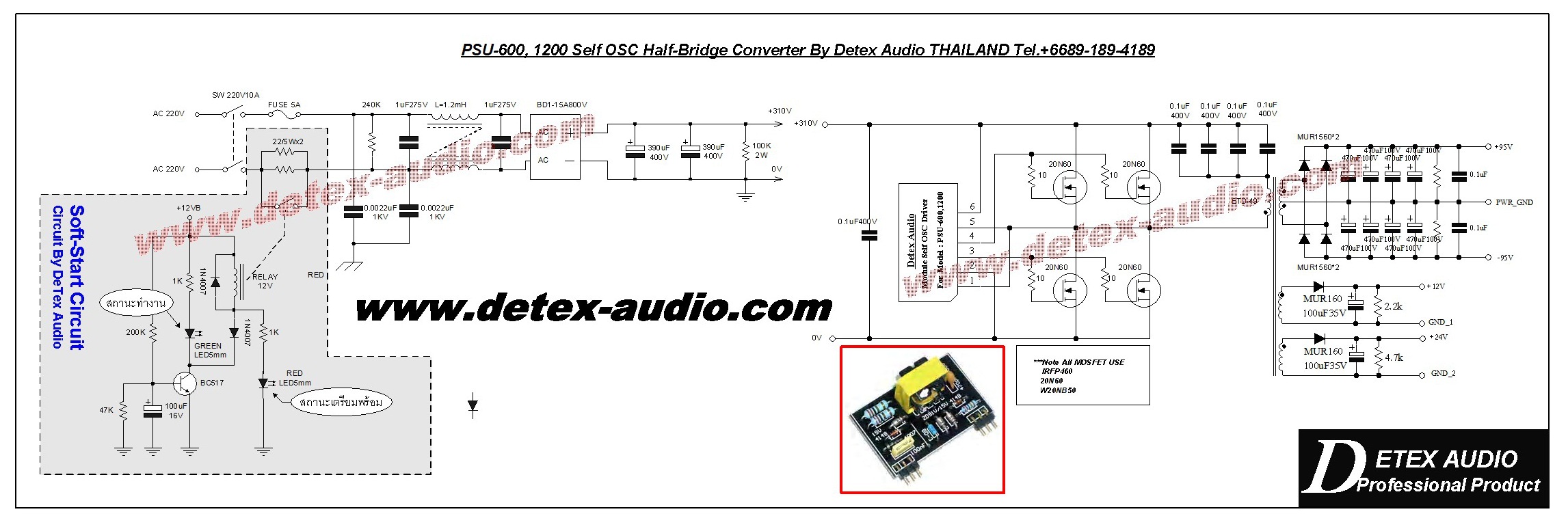

greetings this schematic is 1200 watts self osscilating the picture of smps posted is
TL494 with gdt high power version is with igbts i have the igbts 80 amps 600 volts but pcb has to be designed for igbt protection

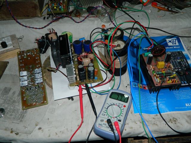

I should read more accurate. You made it with 20 turns at primary? Then, why you asked dimonis for primary turn count? Or did you mean secondary? Confused...
The schematic i posted is a resonant one. Not really good, but kind of resonant.
You already made some switching supplies. I think, we talked past each other, probably you know much more, than i thought.
And sorry, my web Connection fluctuates, so my answers are often for your last post, because i can´t load the actual, the new one, at the right time... :-(
If the primary is 20 turns, then you would need 2 x 12 turns at secondary for bridge rectifier giving 90+, ground, 90-. Because the halfbridge switches one side of the primary between V+ and V-/ground, but the other side is fixed at half this voltage. So input voltage of 325V is halved effectively.

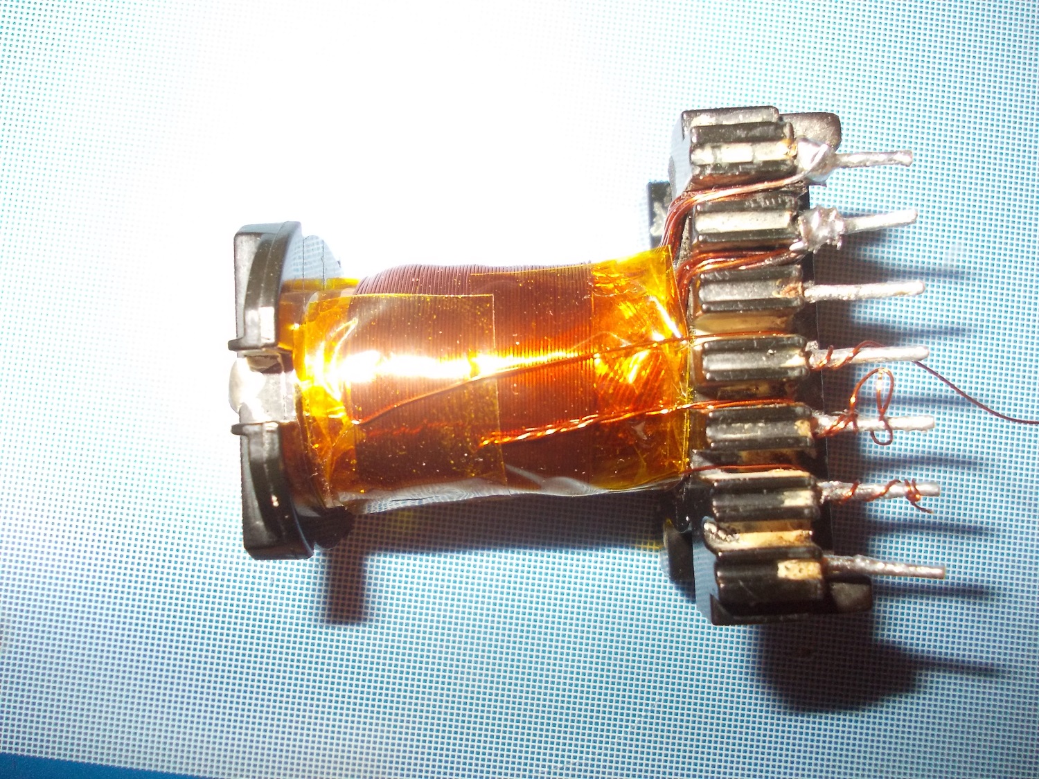

my smps is off center tap using ee55 ferrite core, and am using sg3525 at 47khz, power transistor irf3205 ultra fast diode is rhrp1560. i used gauge 22 for the secondard 1 wire in hand 74 turns while for the primary still gauge 22 16 wires in hand 2+2 turns, my ee55 ferrite core has no air gap, output capacitor 100uf 400v. if i load the dc-dc converter output the mosfet get very very hot. please i need your help to stop the heating thanks.
You forgot to mention the most important data: primary current and voltage, but i guess it is for car battery, 12 V nominal, and about 50 A.
In center tapped push-pull topology the most important source of loss is primary-to-primary leakage inductance. When you switch off MOSFET1, then some of the flux (Iprimary*Lp1p2leakage) can be relaxed only through MOSFET1, creating a voltage enough to open Zds (Avalanche diode inside the MOSFET). Power loss is somewhat more then Ip^2*Lleakage*fsw. Lleakage is tipically 20-100 nH in a good design, so for example 50A*50A*50nH*50kHz=6W is acceptable, but if you don't optimise layout and transformer winding, you can reach 500 nH, which means more than 60W loss at 50A.
But there are many other possibilities to ruin efficiency. For example: input choke. Give a chance to find it by posting details about your design! 1st: actual schematic (not basic design, but the really built circuit!). 2nd: results of measurements (minimum: input voltage and current). 3rd: photos.
General rule: the error is always where you don't search for.
In case, SMPS was designed and crafted correct way. But due to one of, or even several, reasons below, this is not our case :In center tapped push-pull topology the most important source of loss is primary-to-primary leakage inductance.
