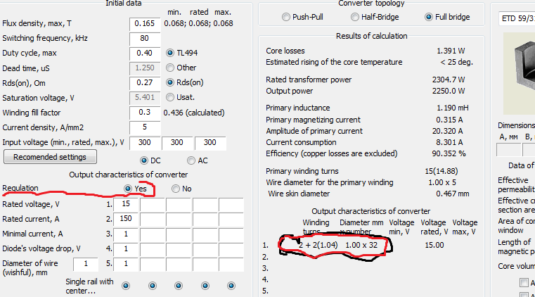

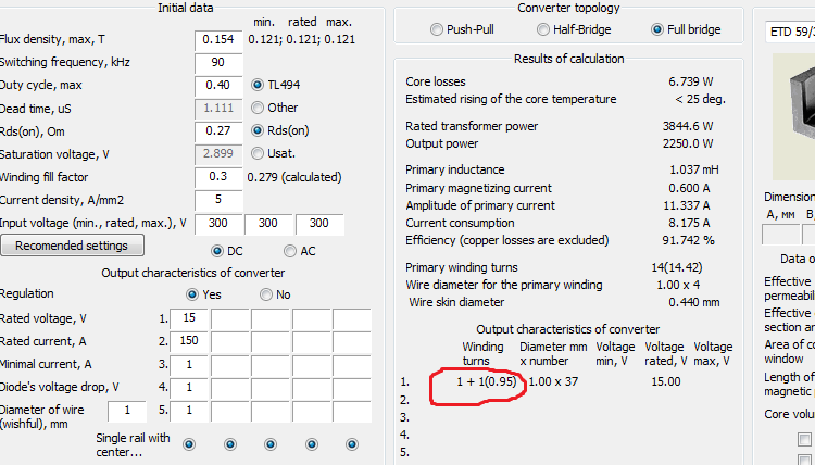

Here it is and I wonder if winging fill factor has something to do with it
I think ,no , it's because of too small turns of the secondary , discreet 1 or 2 , you cannot wind 1,5 turns 🙂
If you choose non regulated output - every thing would be OK 😉
Not exactly the secondary , i'd say ,the duty cycle which the transformer can provide with such turns.so secondary is limiting the power, because of one less turn?
ok, i understand, thank you!Not exactly the secondary , i'd say ,the duty cycle which the transformer can provide with such turns.
