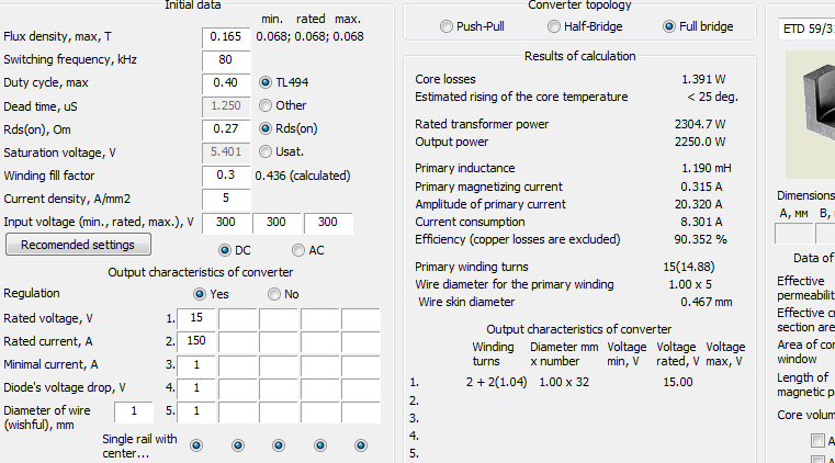

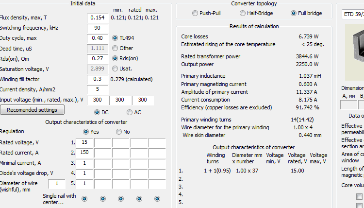

I find some non linear increase in what core power is rated at given freq.
let's say, at 50k it has 2kw, at 55k it has 2.1k, but at 60k it jumps to over 3kw
for now, I can't be more specific... how is this possible?

Can you provide a screenshot of your research ?
I will post in few hours, screen shots, so you will be able to see
no, its offline, etd59 and so on 😉
Here it is and I wonder if winging fill factor has something to do with it
