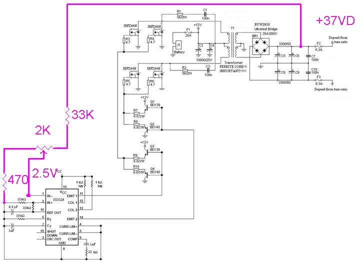

MaXiZ said:
Ok explain me how i should modify my schematic to make this! :)
and perhaps you would like to use the current sense on the LM3524 next. At any rate, here's how to control the pulse width using the error amp.
voici:
What the 2.5V means is that is what you see there when the circuit is regulating correctly after adjusting the potentiometer jackinnj showed you in his circuit. You adjust the potentiometer to get the 37.5V on the B+ output.
The picture you just showed shows the current limit resistor and how it is used. It goes between the sources of the power mosfets and ground.
