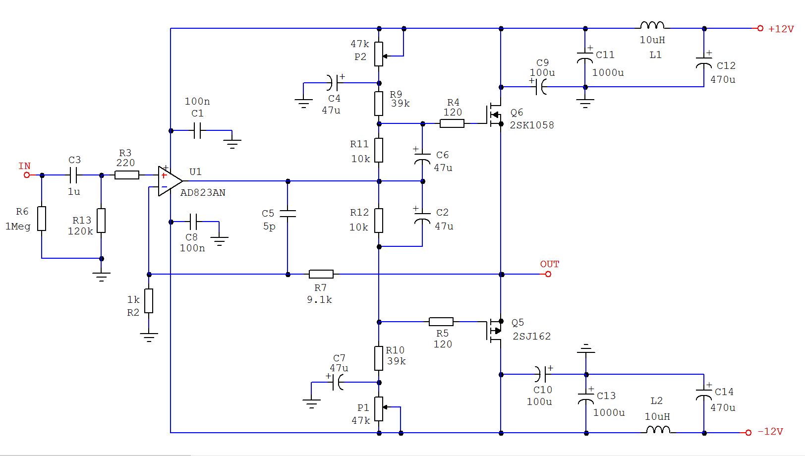

Just to test it I chose the composite topology - OpAmp at input and source follower with Lateral MOSFETs at output. AD823 was my choice because it swings rail to rail. Also it has JFET input (low offset, high Zin) and later I discovered that it sounds really nice in this combination.
To extend the voltage swing of the output stage I bootstrapped the MOSFETs' Gates with C2, C6 so the amp clips at 23Vpp with 24.4V power voltage (the rails are actually 12,2V) which translates into 8W @ 8R i.e. 16W @ 4R.
Output MOSFETs are biased through voltage dividers (P1+R10)/R12 and (P2+R9)/R11.
Biasing starts with max. value of pots (lowest bias). Pots are turned slowly and alternatively (like described in F5 manual) until we reach (depending on your heatsinks and speakers) Id of about 0.5 - 0.7A and DC offset at the output of 0mV (put 0R1 serially in one of the power rails and measure 50-70mV accross it. Remove it after biasing). We use Laterals without source resistors so we can exploit their square law transfer characteristic and the exact bias current value is not that important but you can play with it.

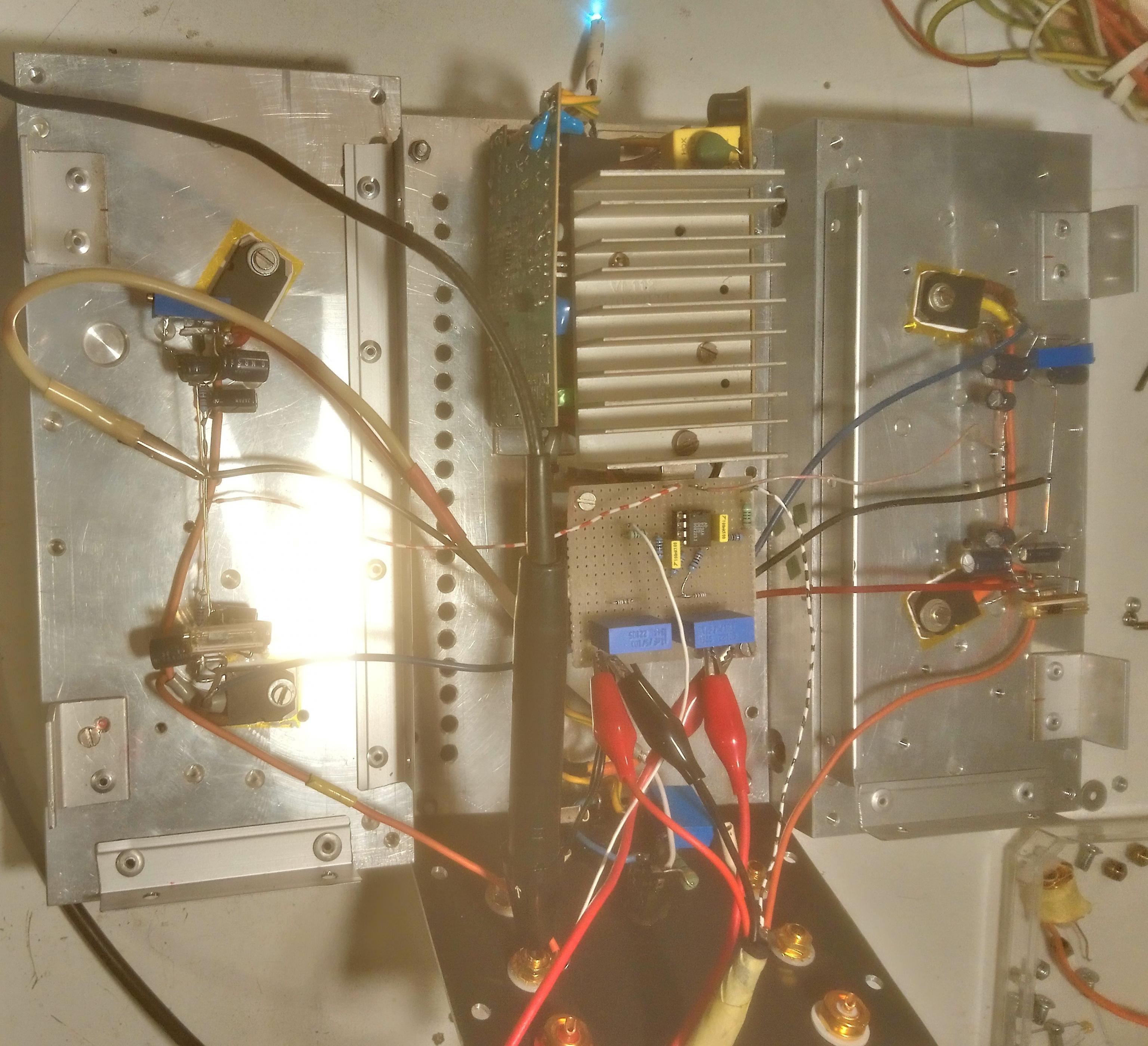

DC offset is very stable, thanks to OpAmp's feedback loop which includes MOSFETs (meaning very low Zout i.e. high damping factor too). The pic shows MOSFETs and voltage dividers as point to point build on the heatsink and the chip is on the perfboard by the PSU so I adjusted the bias and the DC offset before I powered the chip and it stayed stable after inclusion into feedback loop. C5 (SMD) is soldered directly between the chip socket's pins. All electrolytic caps are 16V Japan made NIC (NRSG series - very low impedance): NRSG Series Page

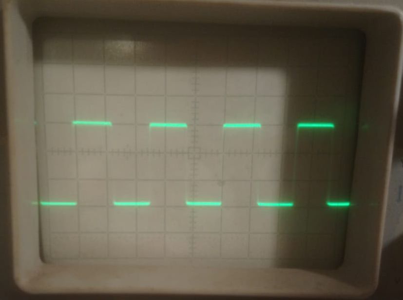

- Square wave 15V_pp 20 kHz @ 5R load (5V/div, 20uS/div)
- Square wave 15V_pp 20 kHz with 100nF pure capacitive load (5V/div, 20uS/div)

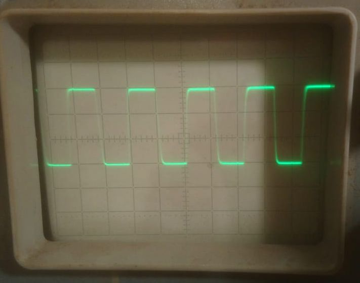

- Square wave 15V_pp 90 kHz @ 5R load (5V/div, 5uS/div)
- Prototype build (when put together the amp measures 22cm x 22cm x 10cm - heatsinks are 22cm x 10cm x 4 cm and they go to about 20 degrees C. above the ambient temp.)
- Schematic diagram (every channel has its own power rails filter)

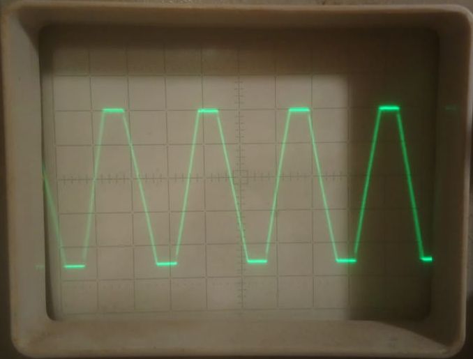

- Hard clipping of 20 kHz triangle wave (5V/div, 20uS/div)
