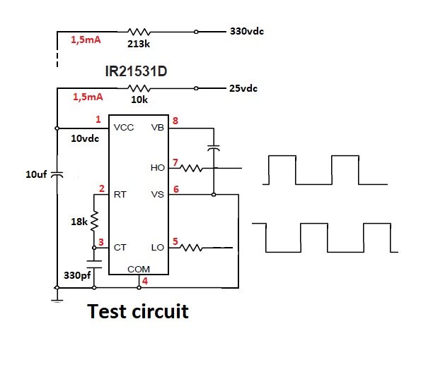

I attached the actual part of schematic that needs
to be checked.

First I assembled on a breadboard a test rig
that supplied the IR21531D from an external DC supply across
a 10k resistor to the IC pin 1.
Slowly rising the ext supply voltage showed
that the IC started working normally at around 21VDC.
At that voltage the remaining voltage (dropped by the 10k resistor)
to the IC supply pin1 was 10vdc which means
the IC needs a minimum of 1,1mA to start its normal operating pulses.
Rising up the ext supply from zero to 21vdc:
The IC vcc pin follows the rising voltage from the 10k resistor
then stop rising at around 9vdc. Then it starts to oscillate
(sawtooth) from 8.5vdc to 9vdc and behaves this way
until (keeping rising) the ext 10k resistor current reaches around 1,1mA.
Then the IC starts to behave correctly.
The 2 output (pins 5 & 7) were showing complementary pulses
with normal timings.
-> This is the normal IR21531D behaviour.
Instead of an ext 21vdc and a 10k resistor feeding
the IC vdd pin, the MarkBass SMPS uses 330vdc and a 270k resistor (R78)
which gives around 1,2mA to start the IC.

I just tried putting a 10vdc ext floating supply to the IR21351D supply pins before
powering up the amp. There are voltages coming out of the switching transformer
but around +/- 5-10vdc instead of +/- 50vdc.. Is-it the transformer primary shorted ??
And using my external test circuit connected to the 330vdc -> 270k supply resistor of the amp
my test circuit works fine and is not stuck at 9vdc.. The voltage rise until the IC stabilizes..
no problem. So the supply part of the amp's IC seams to be ok but not when the IC
is connected to its 2 mosfets (even if they still test good).
I finally found the problem !!!!! C68 (1uf/250) was open !
This was preventing the transformer TR1 from getting the full push-pull drive
from the power mosfets and thus not generating feedback DC supply (D21 12v zener) to take over IC5 supply.
That's why IC5 vcc was never supplied well enough to keep up.. I'm very happy !
