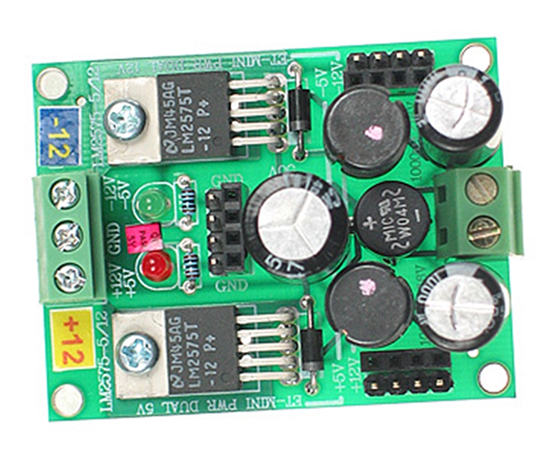

I found this 12v+/- module which looks just might do it. If the SMPS offers more advantages & less noise/problems,then I will pursue that path, otherwise, I'd stick to my trusted linear supply! It's just that I want to experiment to see if SMPS are workable in analog circuits!
Cool - the LM2575 is limited to about 1A, and the flywheel diodes look to be 1A rated. The inductors are fairly small, too. It should be fine for small-signal analog circuits, maybe with some additional LP filtering.
Yes,It's more than adequate for my needs, as I need only a little over 100mA/rail However, I find the circuit below to be one of the most quiet & flexible psu I've worked with! I will just omit section A when connecting to a SMPS.

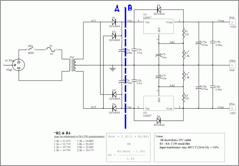

I have missed the point of this thread, why replace the transformer + rectifiers with an SMPS unit? For 100mA at 12V we are talking a very small transformer, such as VB3.2/2/9 - BLOCK - TRANSFORMER, 3.2VA, 2 X 9V | Farnell UK or perhaps a size larger. The transformer solution is virtually noiseless compared to the SNMP and much safer in terms of large voltages appearing at the output. Unless you want to power LEDs or something.

I have missed the point of this thread, why replace the transformer.... .
Well, I hope you read my 1st post? It was just I was thinking aloud about SMPS not being so common in analog circuits & hence thought perhaps some one might be able to educate me on this!
I don't have much experience with SMPS other than using these in lap-tops, peripherals & in digital musical equipment. These are always slim, light weight & very quiet! On the other hand, I found linear transformer circuits relatively easy & fun to DIY & to work with for semi-noobs & kitchen table wizards alike! However, few things I've come to know with these are that;
1. Some of them exhibit a loud acoustic vibration
2. Fairly expensive vs cheap SMPS.
3. Quite difficult to obtain precise +/- rail on split supplies.
4. can be quite expensive designing highly filtered & almost noise free units!
5. Only around 50% efficient & exponentially falling with increased heat with power demands!
SMPS too have their quirks like,
1. High swithing noise!(specially in cheap units)
2. An unfiltered output may cause glitches in digital circuits or noise in audio circuits
3. EMI/RFI produced due to the current being switched on and off sharply.
4. Requires additional filtering.
Q:What effect will this "switching cycle" in SMPS have on analog circuits?
Q;How safe is SMPS in small anlog signal equipment?
