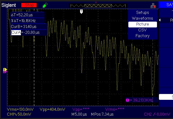

I'll bet you're hearing the beat frequency between the two class D amp outputs. How to determine if this is the case:
You still have only 2 amps connected to the supply, right?
You can probe the output of one amp with the scope channel 1, the other with the scope channel 2, and measure the frequency of the class D switching ripple on both, should be a couple hundreds of kHz.
Then do the thing that makes the noise, and measure the frequency of the noise.

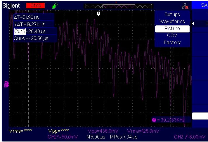

If my hypothesis is correct then the frequency of the noise will be the difference between the two switching frequencies.
DO NOT short the negative output of your amps by connecting the ground clip of both channels of your scope to the "OUT-" of each amp! Put the ground clip on the ground, and use the scope in AC mode so it ignores the VCC/2 DC level on the amp output.

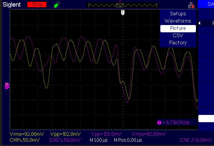

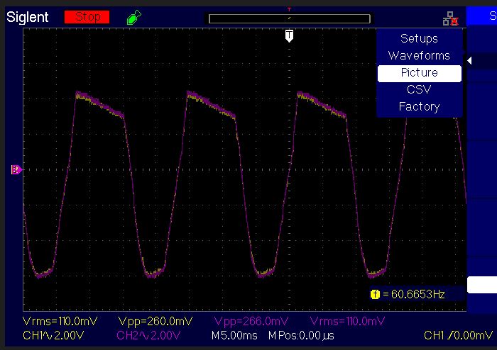

Hi peufeu, thanks for all the tips. I took some readings tonight and I did not blow up the amp or my oscope, but thanks for the warning, (I have made that mistake before poking around a guitar amp with 2 probes. I am attaching some pics. The first is what I get when both amp inputs are shorted and probes are on + speaker terminal of each amp, (probe grounds attached to safety/earth ground.) Pic. 2 is a composite of the two waveforms at the resolution of switching, I believe just under 200kHz. I notice that they start to align after a couple cycles. Pic 3 and 4 show a close up of each waveform, with cursors measuring 10 cycles. According to my math ch.1 is switching at 191.6kHz and ch.2 at 192.7. The delta is 1.2kHz which is about double what I am hearing at the speakers, but may confirm your hypothesis. I hope to get to the other tests tomorrow.

Now attention is off the PS and on the shared input signal ground I thought I would connect a simple RadioShack ground loop isolator. Problem ostensibly solved. No audible noise at speakers with 2 class D amps and stereo input from iPod. I have yet to try this with a source whose ground is also connected to earth ground, as will be the case in final implementation. Combining the collective contributions of all posters, it seems most likely that the differences in switching frequency is inducing currents that make their way through the signal ground. I know, this was stated at the start and throughout.
