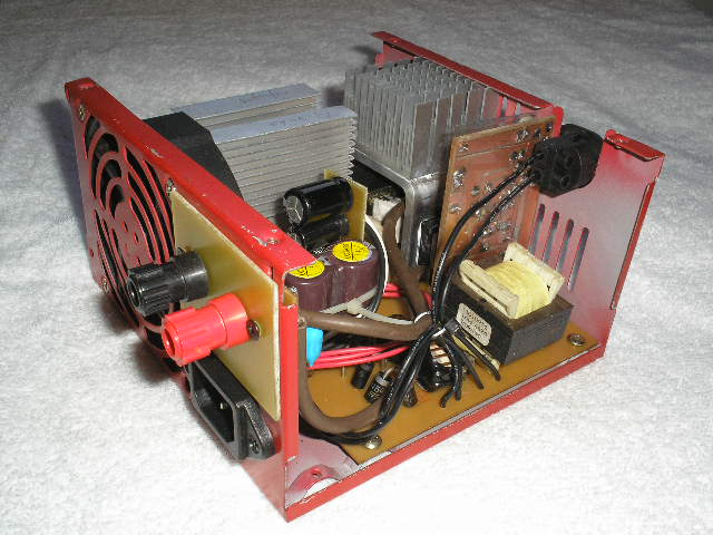

another picture
Hi
I will build the Rod Elliot SMPS protection. Wait for news.
CHACALPOWERS

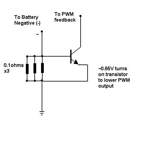

Hi
I don't think you can go without full current going through let say transistor, which would with resistor limit output current to set one, but!!!: Transistor would dissapate heat as would resistors. This is with no influence to FB, then you can use circ above and one more, current sensing by trafo...maybe some other way to, but can't think of any now

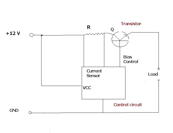

I was thinking on the same line. The reason why I didn't want to control the SMPS feedback for current limiting is because I am not an expert to do this. My idea was, passing the whole 12V output through a transistor set up outside the ATX PSU on a heat sink which normally is configured to be conducting with negligible voltage drop across and little heat dissipation. But the base bias is controlled by a simple circuit which actually monitors the currentflow by some mechanism (which I can't figure out how) and restrict the main transistor bias once the current flow exceeds the limit. So the transistor acts as variable resistor and will dissipate heat only when the current is excessive unlike a pure resistor. The other advantage that once I make this circuit, I can use it with any PSU irrespective of the voltage to limit the current, which adds a lot of flexibility. I shall try to post my idea as a diagram in a later post

Current limiter
I am attaching a diagram to show my idea of external current limiter circuit. But I don't know how to make the control circuit. The resistor R can be of the order on 0.01 ohm (can even be a loop of wire as a resistor) so that even at 20A the voltage drop is only 0.2V and heat of 4W. that voltage drop is sensed by the control unit which then restricts the transistor bias and choke the input current. I want to know if it is practical or just a blunder.

Hi
No no not like that, it would be much easyer to make interface with FB then this... I was thinking of...same thansistor as you do have, resistor goes from C now to E. then you use PNP resistor that goes with....ah just see the pic, pic is good for 100 words 😀
BTW what you were thinking, that is so called high side driveing, you would have...it is more difficult
Yes, something of this kind was exactly what was in my mind, really this is much more simple. I assume the circuit is pretty reliable.
