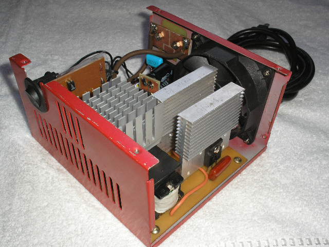

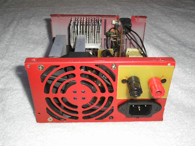

Hi
I was really trying to avoid drawing schematic, this board are so small, every pin has multiple connections to others all over the place...but if nothing else could be done...
Funny thing is that if worked, until the one time after I have checked secondary with scope. Also dead time...it is a bit large, and I don't really know how to change it in TL. But startup is first to be fixed...ooo jea no apparent blown or black components. All I hear now is some low freq like pulsating freq. comming from somewhere in primary side
