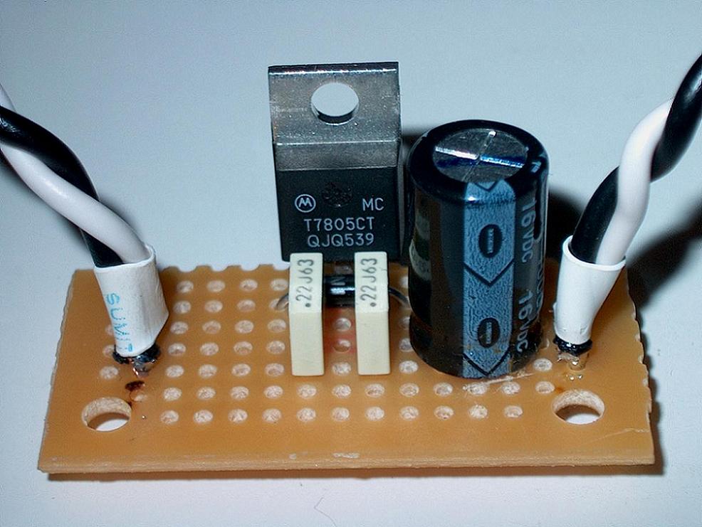

I just finished the first of the three 5v supplies I need and I am very satisfied with how it turned out. Under a full load of 1.5 amps it only drops 10 millivolts.
The space between the input wires on the left and the small white cap is for a 47ohm resistor if I decide to use one. I didn't have any laying around so its jumpered with wire for now.
