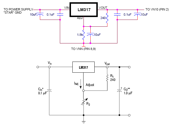

Ok, another question 🙁 . Tripaths circuit has the ground and Vin reversed from the standard LM317 circuit because it uses VNN which would make ground positive for the 5v supply.
That doesn't sound very safe for how I intend to use it. Would it be ok to use VPP instead and use the standard LM317 input scheme?
Attached is an image of both circuits with tripaths being on top.

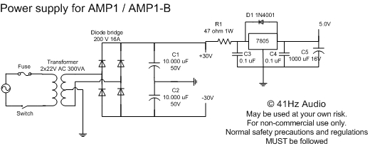

Seems I let my anxieties get the best of me again, the answer was as simple as just taking a moment to look at the 41hz website with my eyes a little wider open :bigeyes: .

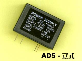

Little devices like the attached pic can help you get rid of the transformer. If you get a 7.5V or 9V one and use it with an LM7805, it's very small.

soongsc, I'm going to use an SMPS, so in the pic just imagine everything to the left of the +/- 30v gone and replaced with it.
I really need to slow down a bit, I just ordered 6 LM317's off ebay, then I found some LM317LZ's which are a TO-92 package that handle 100ma that I thought would work perfectly. This was all before I saw the 7805 regulator circuit on 41hz.com, so after seeing it I bought 6 LM7805's.
Now, I'm sure your saying something like "did this guy forget to take his meds today", but its not over yet. After ordering the 7805's I remembered I had some regulators somewhere but I had no clue what they were. I found four of them after a short search and low and behold their some nice Motorola T7805CT's that I verified to work in about 30 seconds hooking it up with two jumper wires to an SLA.
So after all my rambling and questions the answer to my problem was as close as the website for the amp, and my own junk drawer :dead: .

I think we're on the same boat. I have an AMP2 that's supposed to come in soon, and I just got two 48V SMPSs that I intend to put in series (two of these turned out more expensive than the kit itself. :xeye: ). I'm also trying to figure out what to do to get the 5V. Most SMPS that I looked at had that kind of output, but not with the one's I got. So I'm just going to get the little AC-DC power either the 7.5V one or the 9V one and hook the LM7805 to regulate it. All I need to do is check the max input voltage of the LM7805.
