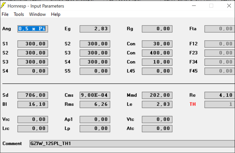

HR calculates Qts or Qts' based on the inputted driver's Re, Qes, Qms and any added series resistance (Rg). Unfortunately only Qts is displayed in the Driver Parameters, so have to do the calculation to find Qts'.
HR has a TH Wizard, so might want to try it with your driver's specs to see how it compares to what you did.

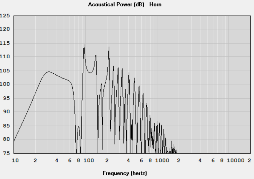

Here is why i use one octave per TH:

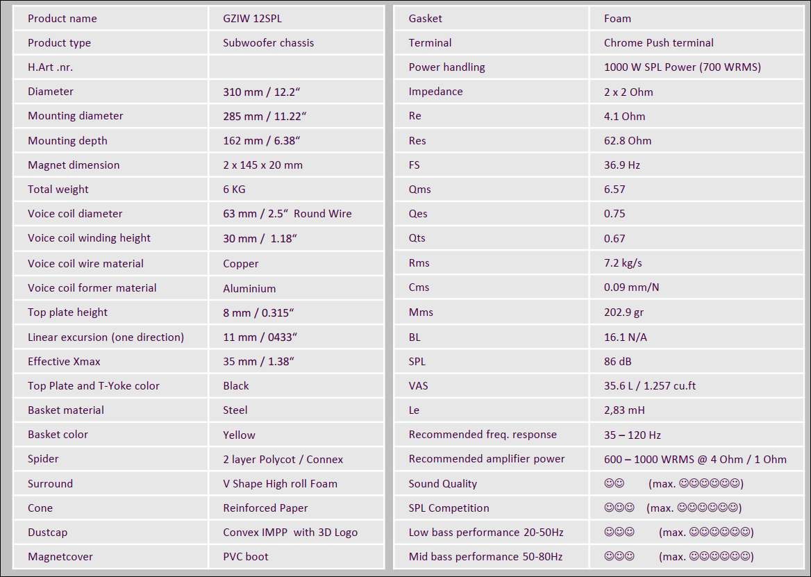

specs are:
inputs are:

I try to avoid that horrific thing above first octave 30-60. And there is something to start with it: huge nice drop from 70 to 90. So usually I cut as digital 60db or more from 50 and let midbasses do their part.
My question asked on dummies behalf is:
In right column of specs is given Rms as kg/second. HR talks Rms being about "newton sec/meter"
Are those the same thing?
Other similar question is about specs' Mms vs. HR Mmd. Are those related?

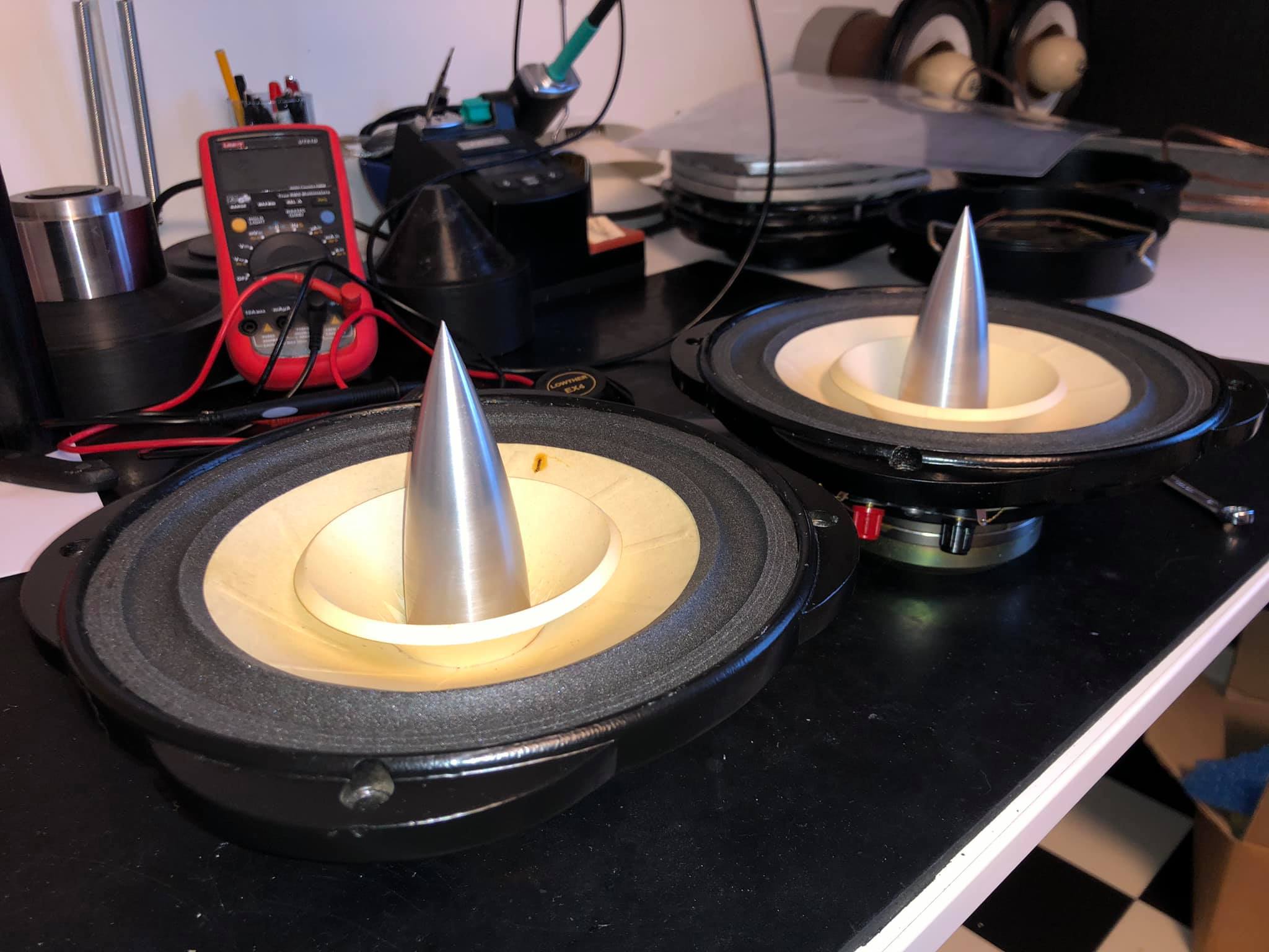

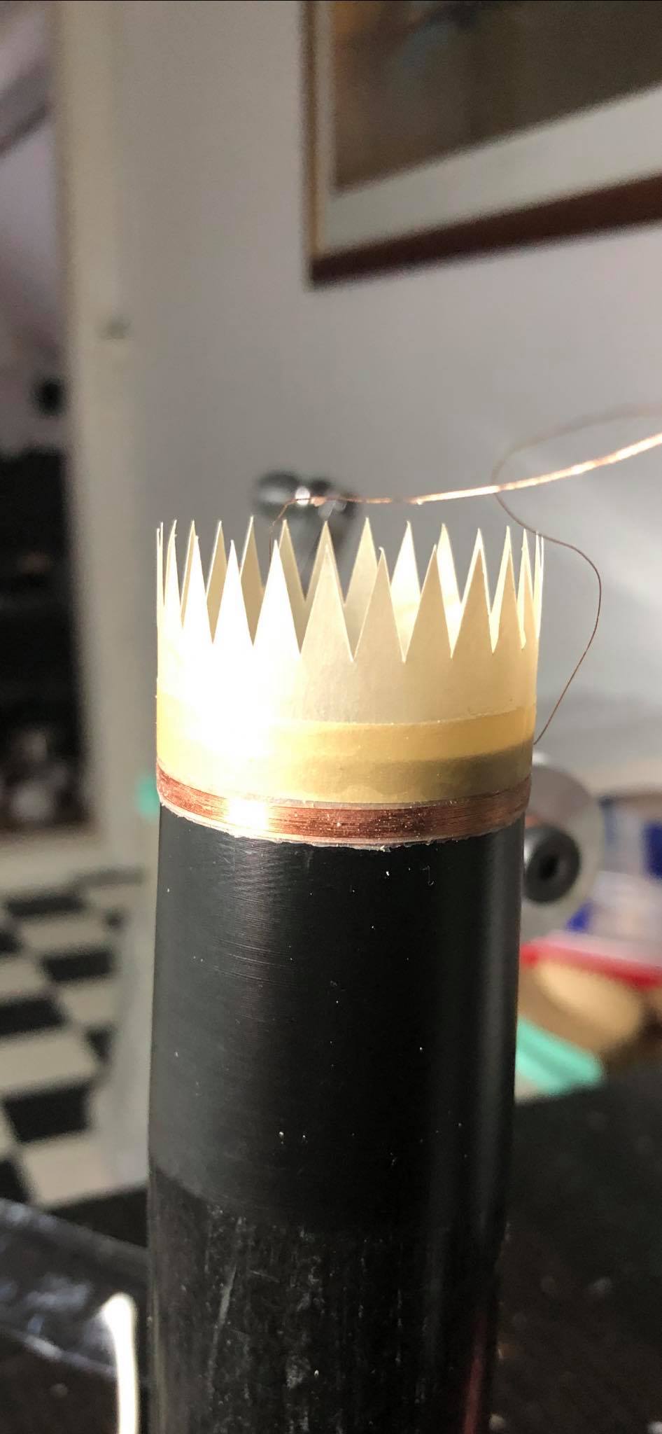

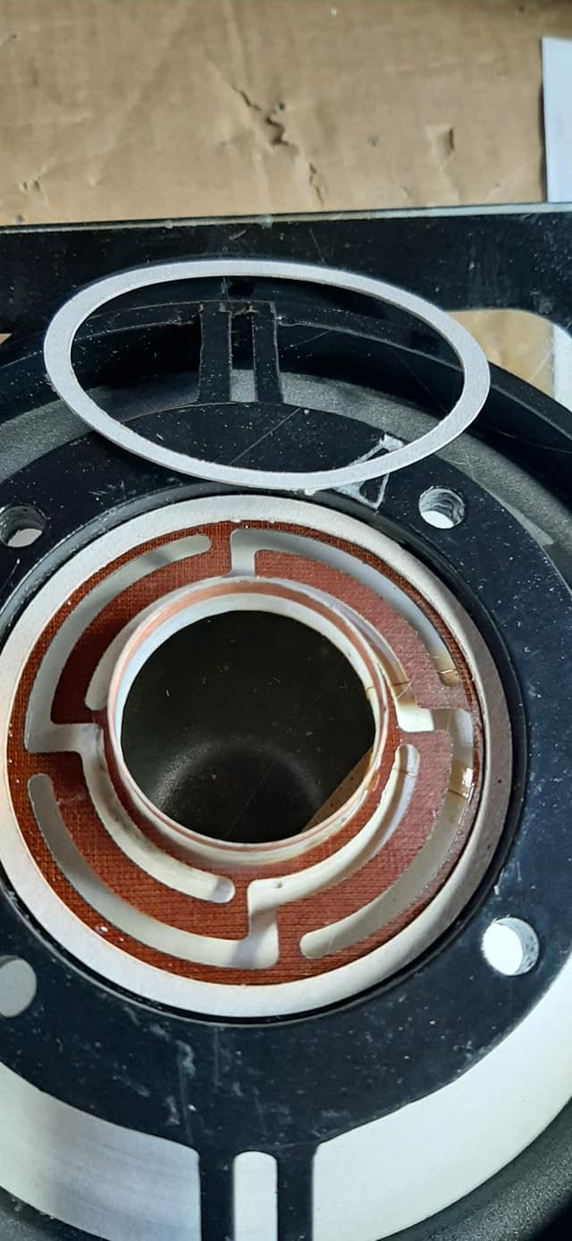

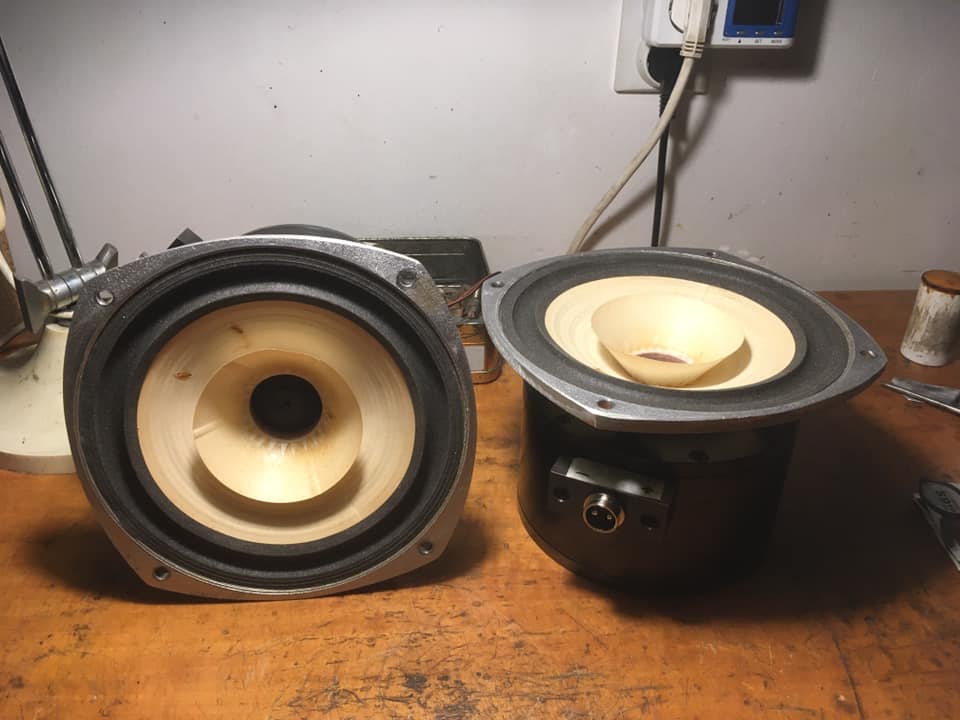

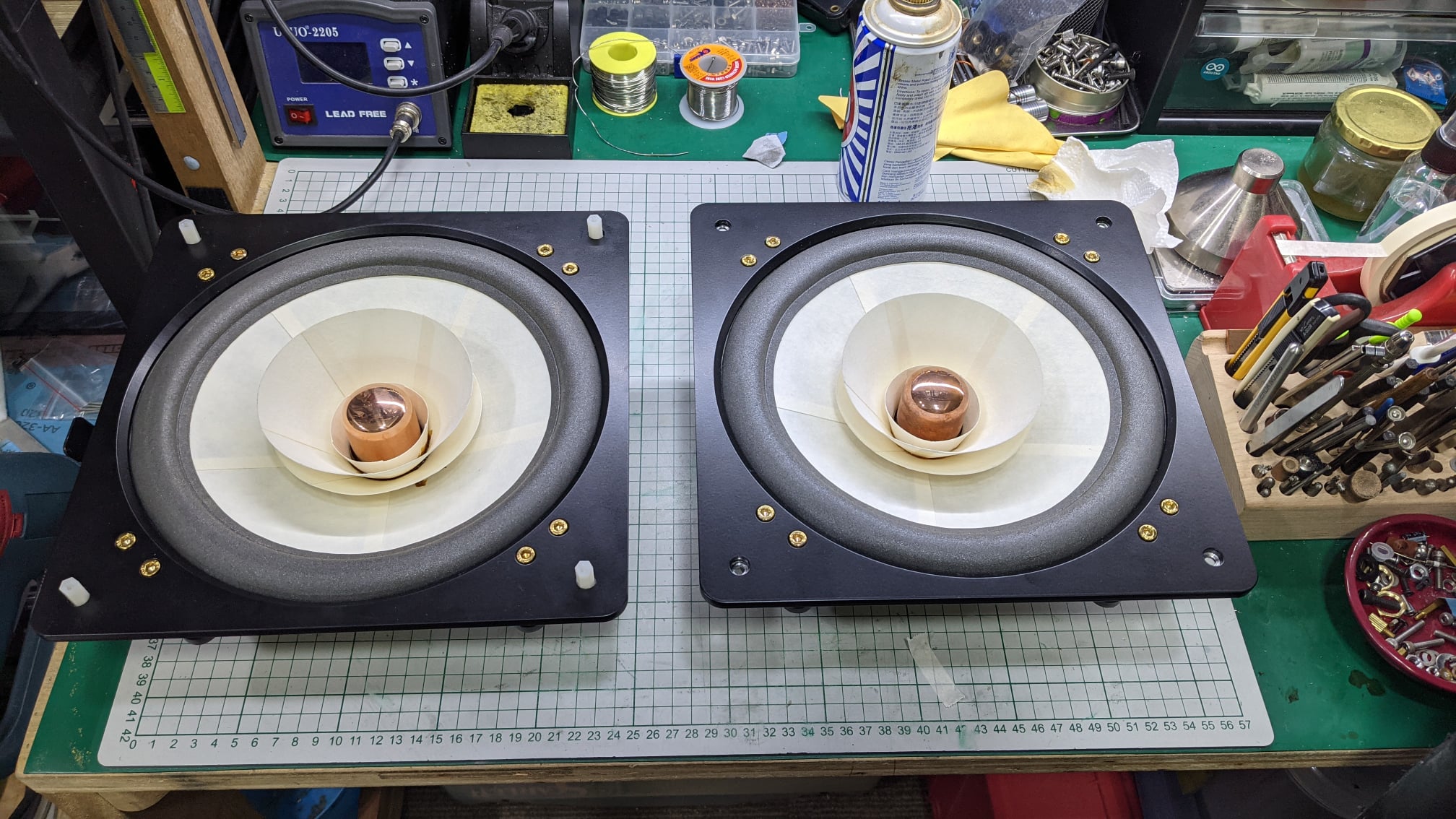

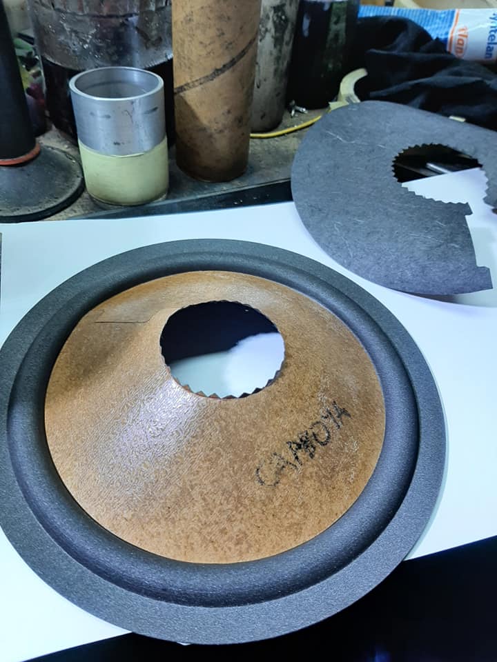

Contact Zolt on the Lowther modification forum on facebook. Here are my PM2A:
Nice to see a member of the Lowther Modification Group. Yes excellent custom made cone, damper, surround, VC, field coil by Zsolt
Its a group of hardcore custom driver makers which focus on Lowther and other fullrange, which also include some woofers.
