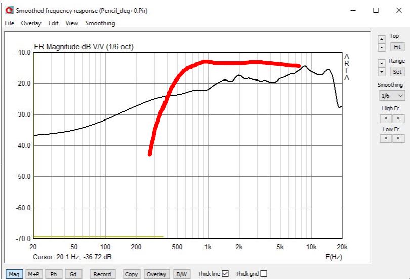

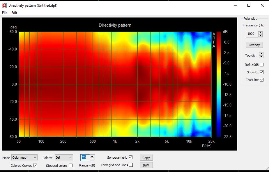

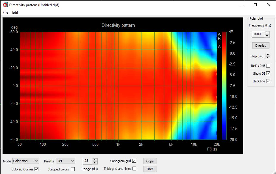

I've been doing a lot of testing myself on improving the directivity and I think a solution can be found in a front horn design that reduces the throat size. Here's a Scanspeak 10F comparison between horn and non-horn configurations. There radiating diameter of the 10F is 76mm. This horn throat is a vertical slot that's 45mm wide x 76mm tall. The horn loads the driver down to 250Hz. I suspect a horn with a 1kHz cuttoff might perform better for upper treble performance in off-axis.

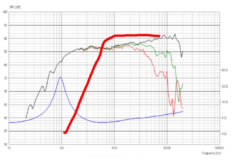

The driver has very little breakup in the upper treble. Right now I'm thinking of doing a shallow front horn with a 600Hz Fc which should sum flat with the driver's natural rising response. It would be a nice pairing with something like the Fostex FW208HS which I'm also really liking for small room listening.

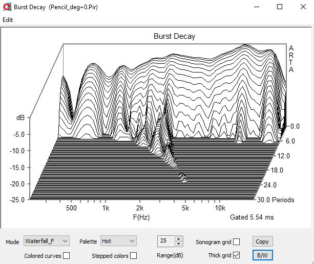

Shown below is my prediction on the response in a front horn. Also my own burst decay measurements in ARTA for the Thiel 10F/8424-G02 showing subtle breakup at 19kHz (very good!).

This is my own measurement of the 8424G-02 on a narrow baffle. Again the response looks ideal for horn loading. The burst decay plots look better than most compression drivers short of something that's beryllium. Maybe it's the fibreglass cone/dust cap that's very effective here I'm not sure. I certainly like the sound as well. Very lively similar to Fostex but without the aggressiveness, and not overly damped like some other drivers I've tested.
