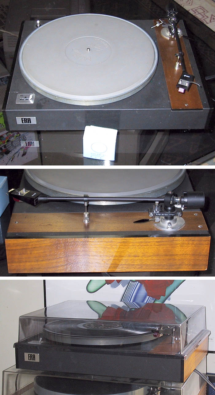

...ERA mk6...
Back in my hifi retail days we sold a ton of those. We cleaned out the Canadian distributor at a real fast price, something like 100 units. Most went out the door with Grace 707.
