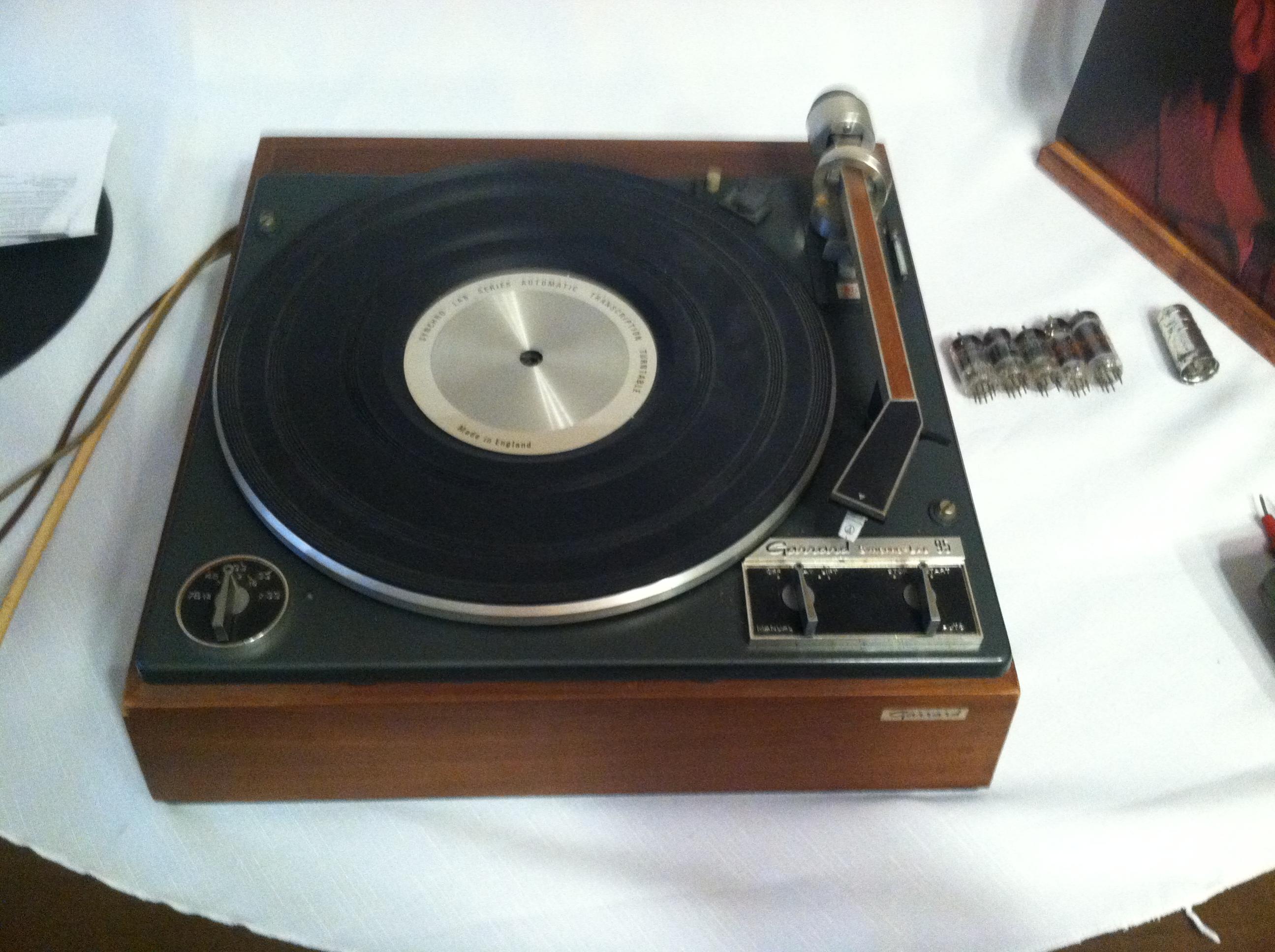

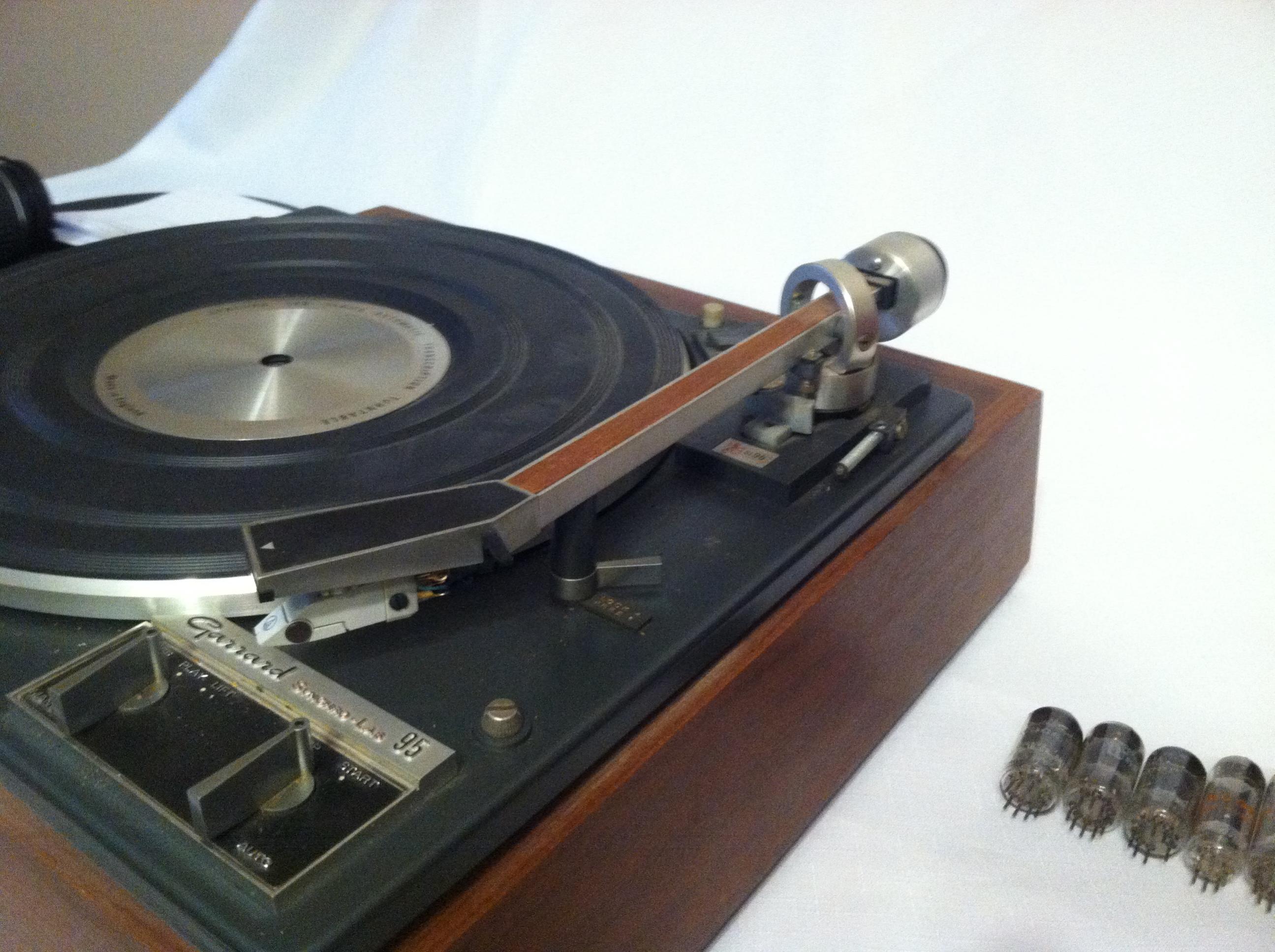

Galu - It's not that difficult, patience is the key. I'll be glad to start the SL95 (pics) when this one's done! It's in much better cosmetic condition than the 50 was.

I bought the 95 strictly on its looks. Monetarily, it's not worth much. I probably paid more than it's worth, but I just couldn't turn away from it.
Thanks for the encouragement. I'll use my DSLR instead of phone for decent pics and start a thread. I'm hoping it won't require complete disassembly, but it's likely to have old grease underneath things that can't be reached otherwise.
I put it in an opaque plastic bag so I couldn't see it and curiously open it up and test it out. Gotta finish the 50 first, I just don't have room for two projects inside the house.
