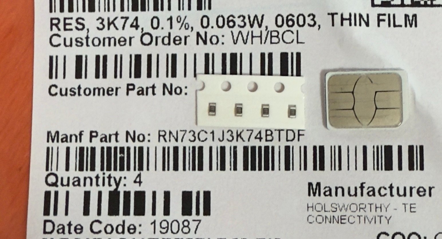

Thanks, I got a handful of values of Holsworthy TE Connectivity resisters, they are 0.1% 10ppm/*C, don't need quite that tolerance but won't hurt and seemed a good place to start, I'm not Atari buying in millions, just 10 of each value. I'll look out for Susumu next time.

They've arrived. Photo on the label from Farnell. Nano SIM on the right for size. The SMD resistors (o 🙂 ) are the four little black rectangles below the four dots on the white strip. They must have to employ young people to make these, nobody over the age of 30 will ever see these with the naked eye !
Those are 0603 size, that is LARGE (in current production environments) 😱 0603 is about the smallest I use in manual soldering like pull-ups and 100n decoupling. But industry is already past that for years. When I was still designing electronics for a living 0603 was the goto size (except large capacitors), passives in digital were typically 0402. And for phones 01005 was becoming usual.
