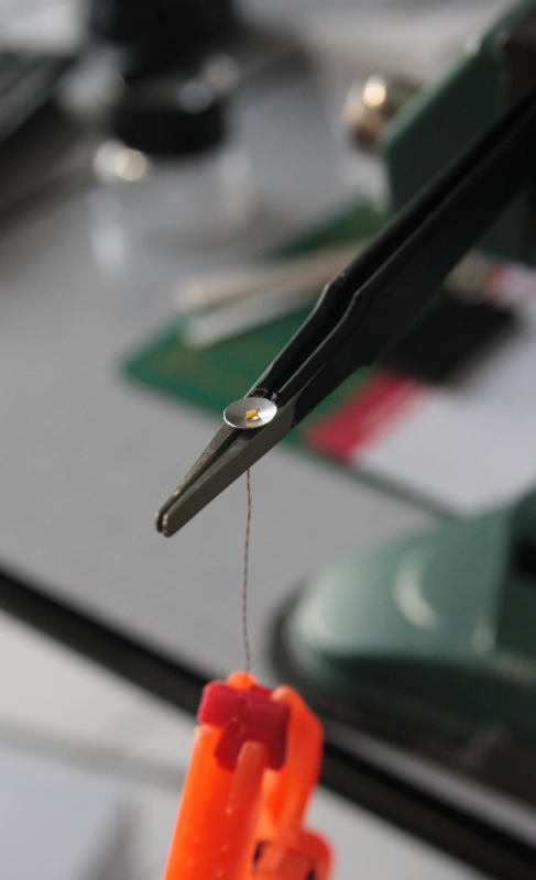

Manufacture and placement of SMT components is fully automated, only the P&P machine camera ever has to see them... Anyway 0805 is far larger than a full-stop, unlike the 01005!!They must have to employ young people to make these, nobody over the age of 30 will ever see these with the naked eye !
I've bought a new solder station which should keep the tip temperature within bounds, plus I've got some old 60/40 solder I'll use which only need about 180C to melt. A tiny tip, some Stannol 0.5mm solder and a magnifier and I should be good to go 🙂
Boy, it's difficult but it is achievable. I've managed, using a lot of flux, tinning the board first then holding the resistor down with tiny tweezers whilst applying a dab of heat. Using lead solder and a lower temperature seems to help too. Then cleaning the board with solvent, it doesn't look too bad but very difficult to get it straight. I've got some off cuts of carbon fibre and I'll see if these can be used as a guide, maybe a sliver of cf against the the adjacent component will keep it aligned.
