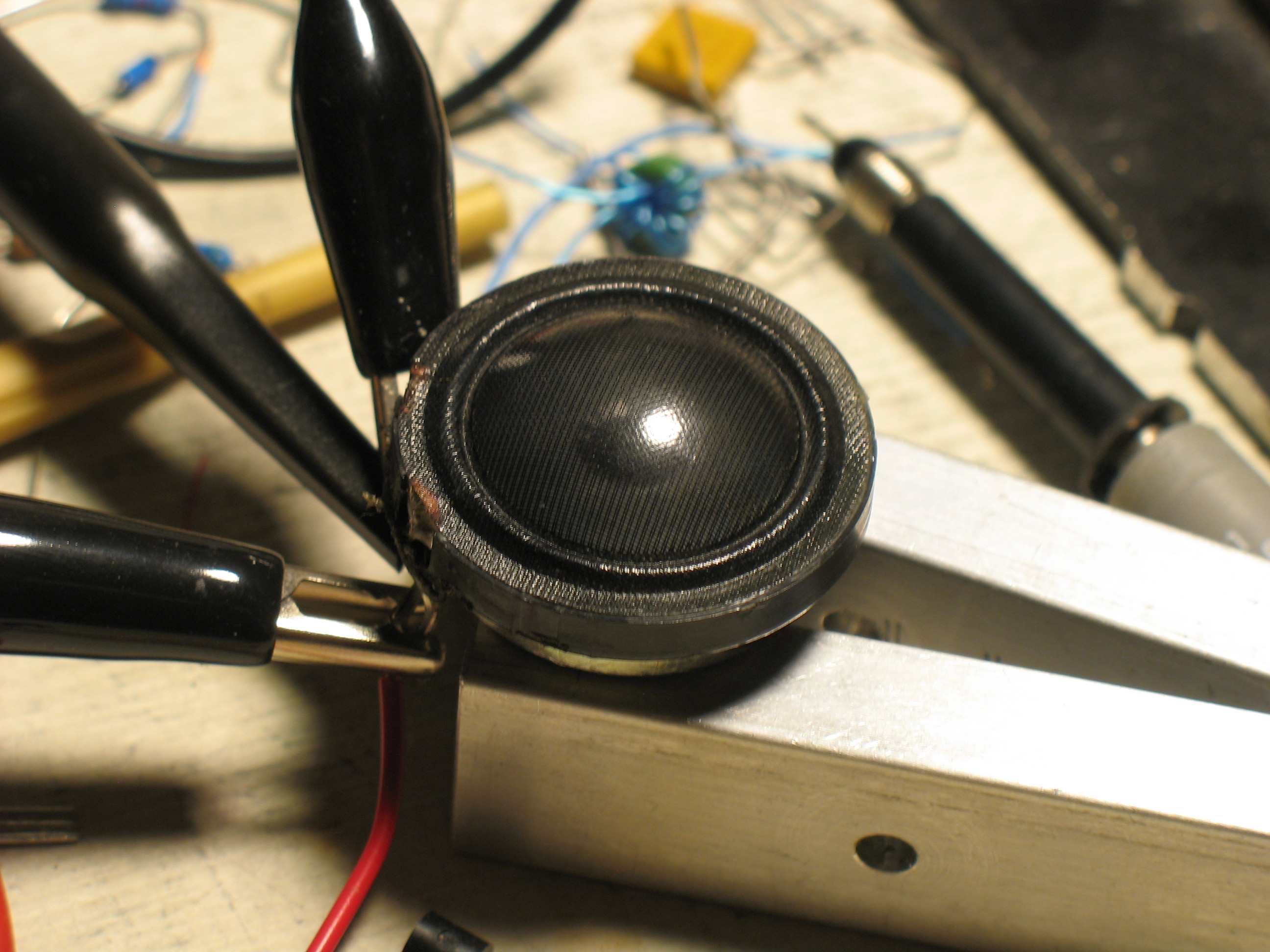

Alright. I grabbed a Dayton ND20FA and bored a 13/64" hole in the center of the magnet structure, then ran a countersink a little more than halfway into the pole material on both sides. I had to completely disassemble the tweeter to get it done. Put it back together, after quite a gap cleaning job, and with the bottom of the tweeter suspended off the bench with some blocks I got 575 Hz resonant frequency.
This is something I've been wanting to do on my own anyway..
I also got a chance to seriously inspect the construction. I noticed the coil former was not glued quite colinear with suspension travel, in hifi terms you could call it way off.
A simple plug is probably cheaper than a cylinder magnet, possibly the reason for using the former aside from the fact that it wasn't to be a vented design anyway. The pole material, judging by leakage, is still highly saturated and the removal of a small volume of material in the center probably will not reduce gap flux very much. The gap is pretty large, probably too large to run without ferrofluid. I didn't measure.
Long story short, you might be looking for a vented neo tweeter. I've never seen one so can't recommend any production models. The ND20FA could be redesigned with one but maybe the lead wires would have to come off the coil more at a tangent than somewhat perpendicular as they do. They are tinsel at least. Power handling would be further limited. Ferrofluid wont help trying to hit minimum Fs. Of course lower Fs means less efficiency.

I was thinking maybe Ed had an actual application for a 500 Hz Fs tweeter at around 20mm diameter. You'll never get one of those little mylar tweeters to resonate that low unless you drill a bunch of holes around the suspension and then it will probably have severely limited excursion capability.
FWIW I replaced the ferrofluid with whatever grade it is that I have and the Fs didn't move much at all, it's just much lower Q.
I doubt it would be very linear for much drive level in the ~1kHz range, if that's the idea. By eye the coil seems to be about as tall as the gap. It would be impossible to actually measure this without total destruction.
The OD of the diaphram frame, which can't reasonably be minimized, is about 30mm.
If 20mm is a more critical design driver you could possibly start with the 5/8" dome. Though if you need more than 2 I don't think modification would be the way to go.

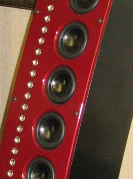

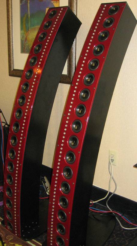

I think Ed was dreaming of Don Keele's CBT array. Don uses little silver inverted dome drivers for his tweeters. They are made for laptops and have good x-max and an Fs near 500Hz.

I think Dave has picked up on the pedigree.
Pano has shown where they are used.
A ~6' CBT uses 70 of them...seventy...per side.
I don't want to even consider what the straight line version that uses delay lines would take to develop!!! 😱
