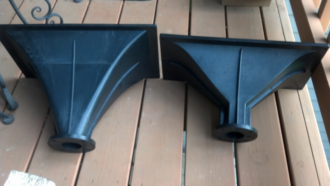

Here’s an LTH142 fitted with an SB65WBAC25-4 driver. It’s about -3dB at 500Hz.
Pretty compact as I was making a “Bookshelf horn” with it. More info here:
A Bookshelf Multi-Way Point-Source Horn
Here it is crossed with two 8in woofers in a point source horn:
The Faital Pro LTH142 is 350mm x 240mm and is probably one of the most compact horns that will reach 500Hz when used with the SB65WBAC25-4 driver.

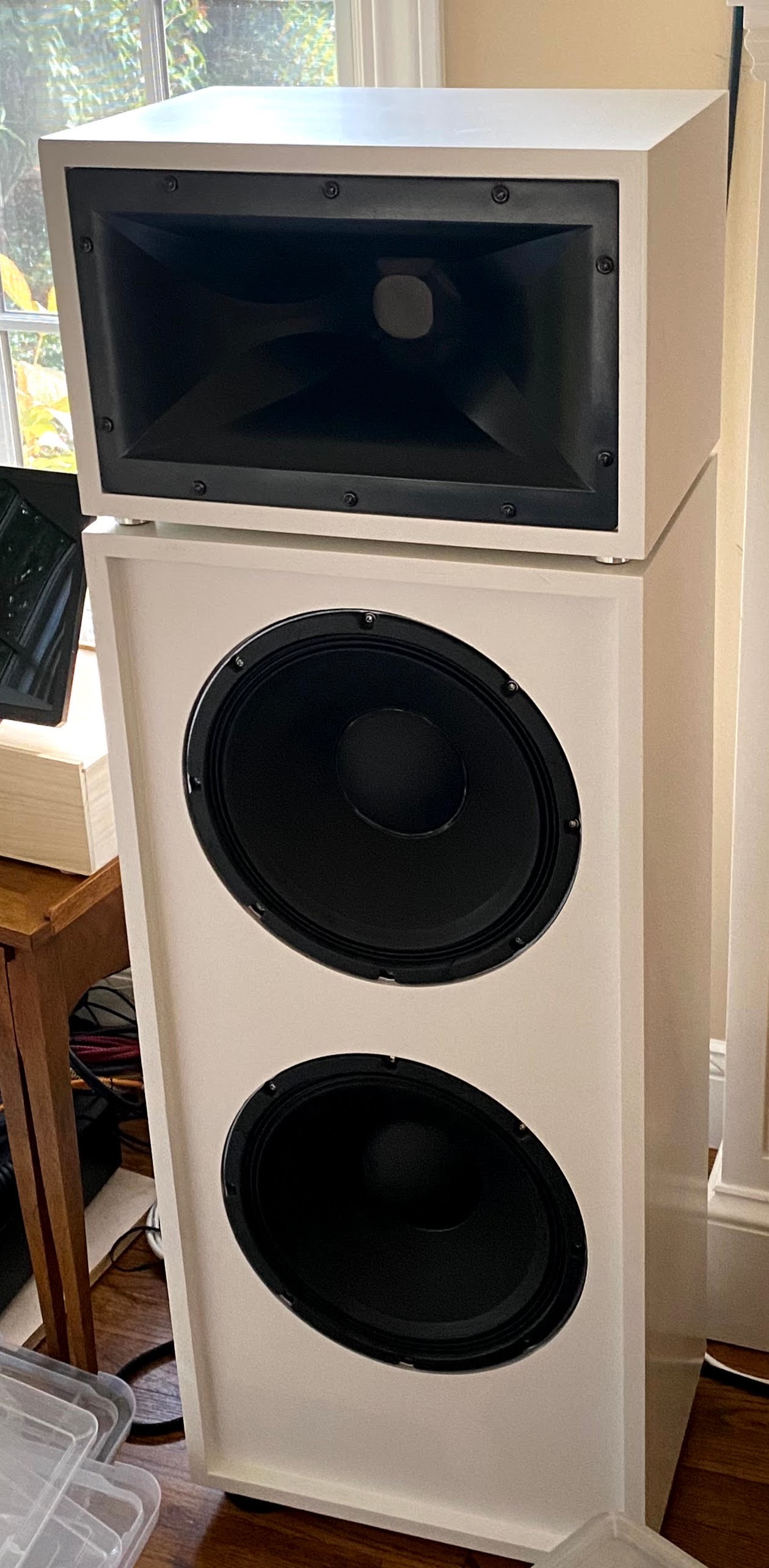

K510 Build
Since there is a lot of discussion about the K510 on this thread I thought I’d post my almost 2 year build that’s finally nearing completion. This is a K510 on top of a separate sealed bass bin with 2 12 Eminence Kappa Neos. Active crossovers with FIR filters built in rePhase. Originally built in May ‘19 and unfinished until I painted them in November. Only thing left is grills based on Fender Tweed fabric.
Final tuning is awaiting an extra IcePower 1000asp module which us all I’m short for having 4 amp channels for the bass bin and moving to a 2.5 way crossover. DSP is custom using the Reaper DAW and a Motu 8 channel audio interface. Started with a miniDSP 2x8 that I found too noisy. Filters are based on the recommended DSP settings for the KP 904HF, which is the pro bundle I bought from Klipsch containing the horn along with the k691(B&C de750) CD and metal stands.
When I finish these I put together a build thread.

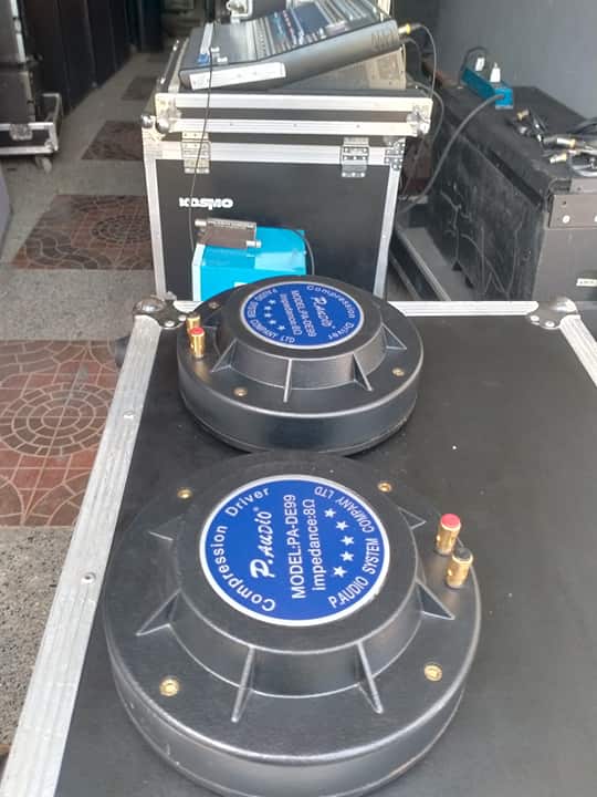

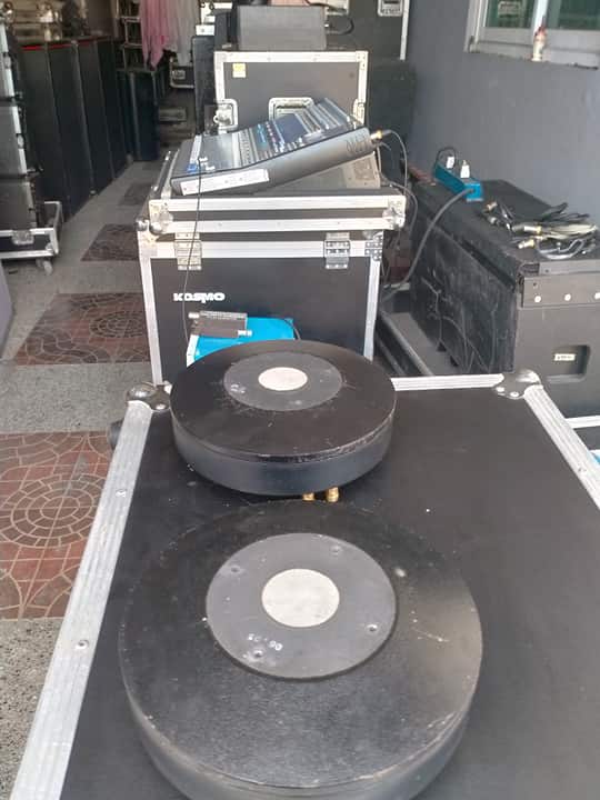

Dear hornwannabe,
Could you please share a little more information on the PA-DE99 (pancake) driver that you have?
What is the throat like? Is there a distance between the phase plug and the driver exit (like in 2447)? The dimensions for the exit i.e. 1.5" or 2"? It would be really nice if you could you please post some closeup photos of the PA-DE99 throat and phase plug. I'm asking this because there is not much information available on this affordable driver.
Thanks in advance.

Here you go.Dear hornwannabe,
Thanks in advance.
Used this adapter to mate the CD to the Horn
https://www.parts-express.com/Eminence-HA14-2-1-1-4-Aluminum-Horn-Adapter-290-5626
