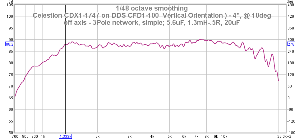

I guess you want a pic ( right? )
Here it is;
This is a Celestion CDX1-1747 which very closely traces the CDX1-1745.
These 2 models are just about interchangeable ( from a trace perspective ).
See ( the raw, unEQed curves on the PRV, 152i clone waveguide );
Worldwide, everyone seems to make that horn.
I bought it under the Sammi ( Korean ) banner 20 years back.
It offers nice ( on axis ) flat response with good lower end loading.
Altec compression drivers ( IME, being ancient designs ) respond best to horns with exponential curves ( like this horn ).
This is a horn ( perhaps ) best listened to in the vertical orientation ( a la Bear ) > I wouldn't use it in the horizontal orientation.
Here's an ancient trace;
This was done with an non-calibrated test mic / so the HF above @ 9K is about 3db too hot.
This confirms my expectations 😉
Thank you for the plots!
The DDS is certainly not bad, the slightly rough top octave is probably caused by anomalies at the throat.
The original QSC 152i waveguide was designed to work with Celestion drivers. Your measurements confirm it.
The main difference between the Celestion CDX1-1747 and the CDX1-1745 is in the suspension/damping of the diaphragm.
