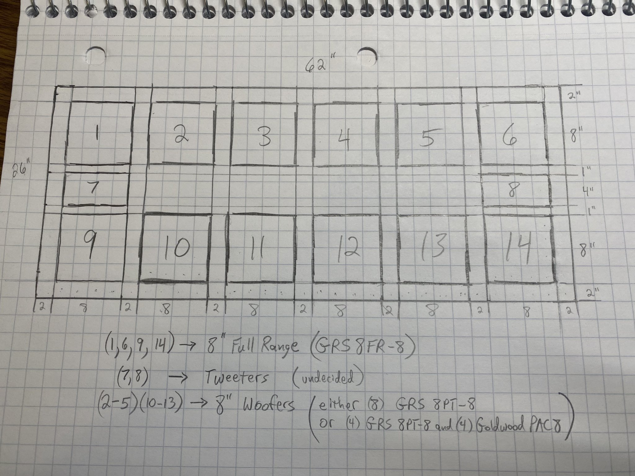

Those super-tweeters may have different brand stickers, but they are essentially the same. The same goes for the "Pyle" tweeter. Yes, I have personal experience with those tweeters and super-tweeters (with different stickers) and I stand by my opinion.Do you have personal experience with those specific super tweeters and that specific horn-loaded tweeter? I mean no disrespect, but the reviews and comments on PE seem to imply the Pyramid super tweeters could be crossed as low as 2k (although most prefer 4k or higher) with good results. As for the Pyle horns, the comments seem to imply they are more like midrange and lack high end. The specs on those list frequency response topping out at 15k, and I've personally never seen a tweeter spec top out anything less than 20k. By design, I'm sure the dispersion of the horn is superior as you state.
Driver capable of 15 kHz is tweeter (not midrange!), by definition. Contrary to popular belief, 15 kHz is completely satisfactory for reproduction of high frequency spectra of any type of music - especially for the intended application.

As a line > W F W W W W F W . They are not against the cabinet and are not adjacent.
Using a passive crossover is not likely to provide enough cut to mid bass frequencies to sound good. Keep in mind many 6 inch woofers can play to 5khz loud.
The fullrange / mid tweets may sound better if not placed next to each other.
Picture says it all about what I am currently thinking. Recommendation was to put full range and tweets farther away from each other, so I have those moved to the outsides. I figure 4 full range and 2 tweeters should be sufficient to play plenty loud if crossed high enough so as not to stress them. Maybe have the woofers 80hz - 250hz? 500hz? I figure if the full range were high pass at 250hz-500hz then they won't be stressed and can essentially be used as mids all the way up to 4k-6k above which any tweeter I wind up with should be happy to play without getting stressed.
The only reason to use the PAC8 subwoofers is because I already have 4 of them. If I was to use four of those and 4 of the GRS8PT-8 woofers, then what would be the suggested location for each of those groupings? Spots (2-5) for one group and (10-13) for the other? Or (2,5,10,13) and (3,4,11,12)?
