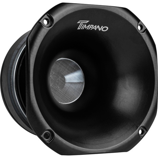

Found these ... super efficient 105db, good power handling, reviews are favorableYou need a single horn loaded tweeter capable of matching total SPL (about 97-100 dB/2.83V/1m).
Find one that suits your budget. Eminence may have some.
https://www.parts-express.com/Timpano-Audio-TPT-ST2-Black-4-Super-Tweeter-Pair-294-3083?quantity=1

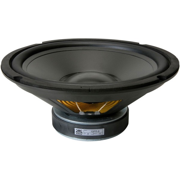

I was thinking something more like this...a quad of ten-inch woofers, GRS 10PR-8 woofers, wired series/parallel for eight ohms. A ultra sensitive horn loaded two-inch diaphragm tweeter, Timpano TPT-DH2000 , use two amps per channel (Four channel amp)...so one can dial back your tweeter if need be. Arrange the quad of woofers in a square & the tweeter in the center.....eight ten-inch woofers in total...fairly cheap setup.
