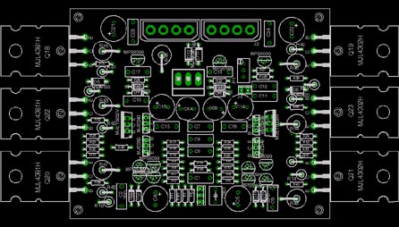

Smaller Leach Amp V1
Re: Daughter of Leach, Lite

See attached layout of Leach Amp, with plastic packs for a lite version. PC board is 80x100mm, or about 3.2x4 inches (half the size of the original, with no wires to the output transistors).

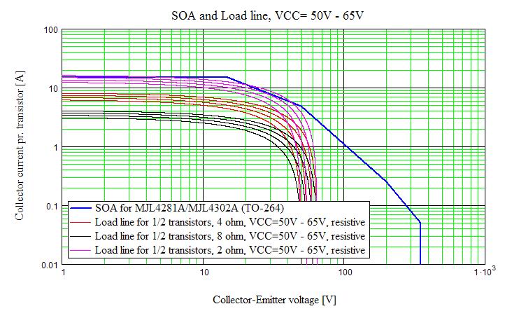

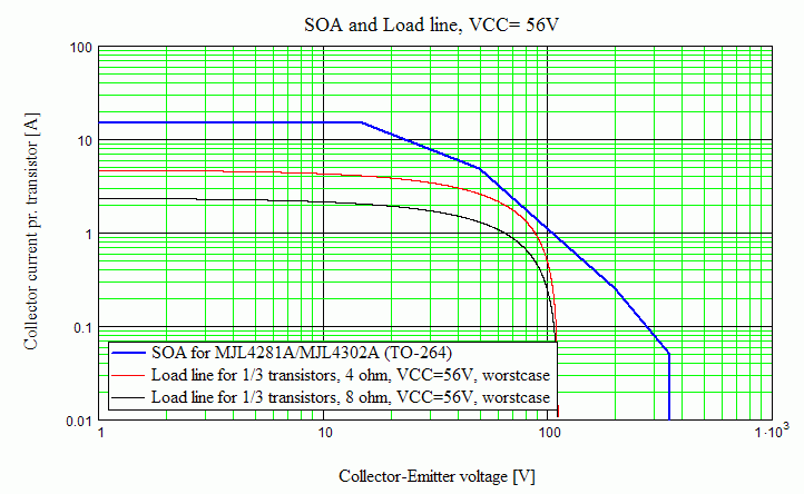

JensRasmussen said:
Here are my SOA calculations
Worst case as per Self + Slone
\Jens
Jens, I had seen your graphs for the 3 and 5 pair cases, this one for 2 pair is excellent, very nice work. It does seem that using the MJL4381 and MJL4302 at 55 volts, 4 ohm reactive load the load line just touches the SOA curve. Are there other devices in the same package that would have more margin (such as the MJL21193/4)? I know you looked at many.

Resistive loadlines vs. SOA
Don't push 2 ohms at higher rails than 50V! and keep the output cool!!
\Jens

I guess a lot of people have done nice layouts of this amp. Here's my latest incarnation, with the triple output pairs.
Ten pounds of stuff in a five pound bag is what I call this crowded design, but it does fit in the max board size my freeware PC layout package will allow. They say 100x80mm, but that seems to apply only to pads. You can put bare board beyond that for mechanical clearance or support, which I did. I had to cheat and stand the power resistors vertically, that was my only option. Constructive criticism welcomed.

Hi slowhands,
Really nice compact layouts.
What components (if any) is off the PCB in the two layouts? I like the idea to be able to use 4 or 6 outputs on a boad of that size, it makes it easyer to find/make a suitable case and heatsink.

This is a double sided board with plated through holes and ample pads for soldering the output devices. It is slightly larger than 80x100mm, still about half the size of the original. It contains all components except the 6 output transistors, the 4 thermal sensing diodes, and the output Zobel network (R50/C25) which by design are mounted remotely.
This layout follows the Leach Amp design almost exactly, including using the same reference designators for all parts so that you can reference Dr. Leach's tutorials on the amp easily. To update this design to readily available plastic packaged output devices, the following enhancements were made:
- Added third output transistor and associated resistors; proven by many builders.
- 2N5415 parts changed to MJE350 and 2N3440 changed to MJE340; proven by many builders.
- Removed C19 and C20.
- Added optional input DC blocking cap.
- Added optional input ground resistor for ground loop reduction.
- Changed P1 to Multi turn cermet pot.
- 4 Fast rectifiers changed to ultrafast (that is, 1N4934 replaced by MUR120).
I do advise that the wiring of this system is critical if you wish to have optimal performance. You can introduce noise, distortion, or instability with a chance misguided choice of connecting or routing of wires.
This is because there is no such thing as "ground" in the real world. Every "ground" connection carries measurable current over a wire that has finite reactance that can be significant. Careful routing and twisting of cables is needed to minimize these effects. In particular, there are very high pulse currents flowing in the power and output wires that can radiate noise into the input wires or other circuits unless care is taken. These problems are very difficult to track down or observe, so it best to simply prevent them by using exquisite care in the wiring.
Central point grounding should be used in the wiring of this system. All wires labeled from the board labeled "Ground" should be returned separately to a single low impedance point connection, which I call "star ground". All wires from a connector should be twisted to ensure minimal coupling to other circuitry.
In particular the input ground and power ground must be returned separately to star ground, even though there is a connection between them on board (R51). The output ground wire is a shield, which returns to star ground (NOT to the speaker binding post ground). Note that the output Zobel network (of R50 and C25) is mounted on the speaker binding posts per Dr. Leach, and there is a SEPARATE ground return from the binding post ground return to star ground.
I use a copper buss bar between the main capacitor ground lugs for star ground. I drill holes in the buss bar, spaced equidistant from the cap ground terminals, for the star ground connections. I use a separate hole for the transformer center tap wire (which carries amazingly high alternating current pulses), a hole with a screw for power returns, and a separate hole for input returns.
If local law requires that the chassis be connected to safety "green wire" ground in the power cord, do so. It is my understanding that the USA and Canada so require. However, be cautious in adding a connection from star ground to chassis ground, as this is a prime noise source. Some makers have a switch to allow you to make this connection optionally, or to float the chassis. Other builders make this connection with an assortment of thermistors, resistors, bridges, capacitors and other circuit oddments. I leave that decision to the builder, personally preferring either no connection to chassis, or the switch. In a large system, floating is almost always best, but you should check.
In addition, all cables from connectors should be twisted for minimal noise coupling. This applies to the input wires, thermal diode wires, power wires, and output wires. The input wires and diode wires should be kept short, twisted, and routed away from the high current output and power wires. There is a ground wire with the output wires that is just a shield, and should run twisted with the output leads to the output binding posts, but not connect to a binding post; instead it returns to star ground. Again, there is a ground wire with the input wires that is just a shield, running twisted with the input wire but not connecting at the input jack; it returns to the star ground.
This may seem obsessive, but better safe than sorry.

BrianDonegan said:
Fasons might save you some space in place of the PC Power connectors. Just a thought. Easier too.
[EDIT] Nice job, btw!
Yes, they would save a little and I considered them. I went around and around on the choice of interconnects. What I ended up with does not fully please me, but I was somewhat limited in choices to what was in the library of the PC design program. All connectors are unique, polarized and multiply sourced (AMP and Molex, plus others). I wanted them to be idiot proof, because it would be easy to cook the amp by making a wrong connection, so I did not use Fast On connectors. You could simply solder wires to the holes too for the lowest cost and highest reliability. But on a proto, connectors are a must, so they stay for now.
