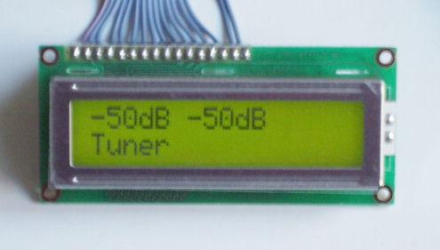

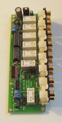

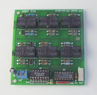

Thanx everyone who tried to help me especially AndrewT.
Does anyone have a good preamp circuit to go with the old and the new leach amps? also to run the leach super amp. I currently use a resistor/ relay network for volume and also have a selector board that has six inputs.
All i want to do is build the preamp into this, so i dont need volume control or inputs, just needs to be a preamp of high quality.
Any help again would be appreciated.

ps here are a couple of pics of what i am using.
yeah sound good but how do i transfer what i have posted to a new thread? Can a moderator move it for me? Sorry if i wasnt supposed to post it here, just thought that heaps of people on this post have a lot of knowledge of this particular amp.
Cheers
