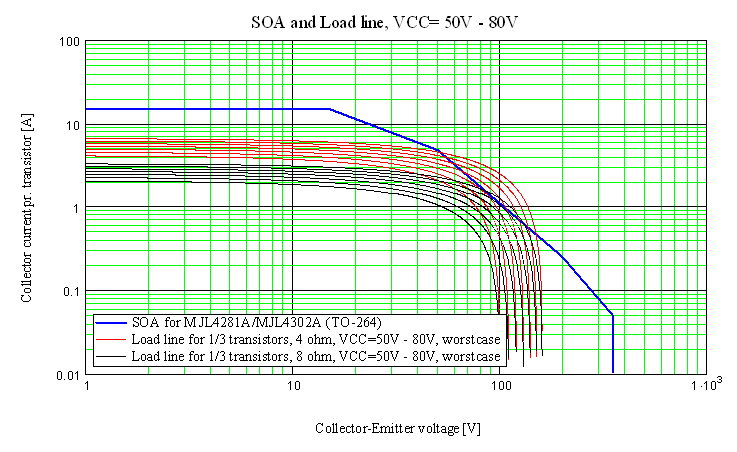

Jens graphs for the Leach manual alreay showed for a number of devices that a Vce of 100 Volts is a critical point.
The non-derated soa curve does about 1 Amp at 100 Vce.
At 10 Volts output, non-derated that would be safe for 3.3 Ohms with 3 devices.
If you go lower than 4 Ohms ps voltage will drop even further, non-derated a six-device output can deliver much more current safely.
If you derate the soa area for higher temperatures than 25C for the Die this would not be sufficient.

Non-derated the soa of an MJL1302 does 1 Amp at 100Vce, for 100-250 mS.
However, for a 10 mS signal it is more like 3 Amps per device.
For a 1 mS signal max current is 15 Amps or higher.
A 10 mS burst of 1 Amp at 100 Vce is 100 watts for 10 mS.
But that is only 1 Joule (watts is Joules/sec), equivalent with 1 watt continuous over 1 second.
Because it is a Sine wave in reality it is only half, so 1/2 watt based on 1 second.
(Integral square[Sinx] = 1/2 !! )
On top of that an output device is working half of the time, the other half it is resting and cooling down.
So 1 Amp for 100 Vce during 10 mS Sine waves translates to 25 watts dissipation for a 50 Hz Sine tone.
A number of people have posted on different threads to derate soa curves to 50 % (Die temperature = 87,50 C ).
A 20 Hz tone has a half Sine duration of 25 mS, at 50 % soa derating the 3 device Leach is easily capable of operation in 3 Ohms impedance.
At 50 Hz, half Sine is 10 mS. 50 % derating leads to 1,5 Amp per device.
Times 3 = 4,5 Amps, which is safe for impedances higher than 2,2.
And undoubtebly under 2 Ohms, because voltage will drop far below 55 Vdc.
Above 500 Hz(half Sine = 1 mS) , the current capability is 7,5 Amps per device at 50% derating.
22,5 Amps for 3 devices, and at 10 Volts output that drives impedances even lower than 0,5 Ohms.

Re: I'll post some graphs later tonight or tomorrow.
loek said:
Hi Jens, in post 67 you wrote:I'll post some graphs later tonight or tomorrow
Do you have some pictures allready for the 6 transistor version?
Thanks, Loek
Sorry for the delay,
Here is the graph for the 3 transistor in parallel version.
\Jens
The way i see a transistor is as a resistor with a variable resistance depending on the voltage at the base.
In that sense the power capability depends on the temperature of the transistor, which gives a margin till the transistor core reaches the breakdown temperature.
Its resistance determines the voltage drop from collector to emitter, Vce.
A high resistance means high Vce, a high current through a high resistance means high dissipation, means higher core temperature.
Both parameters too high and max temperature is exceeded and the transistor dies.
Now if you keep the temperature of the transistor low, the device can handle more heat for certain time periods before it fries.
And if the current going through it does this for a short period of time, the transistor is able too cool down before it is thermally attacked again.
That is why transistors handle more current for shorter periods at the same Vce value(resistor value).
If the interval is twice as short the current can be higher because at the end of the time interval the transistor die can cool down again.
So, if you stay at a safe temperature for the transistors by cooling them decently with proper heatsinks and assume they will stay below the 50% temperature SOA line they will live if at any frequency currents are not too high for a certain interval.
That currents do not exceed the limit for certain durations is what i've shown in the previous posting by expressing frequencies in time intervals, and checking how high currents can be for a certain voltage drop over the transistors collector to emitter.
The Leach amplifier has a built-in current limiting circuit that reduces voltage level to the driver stage if the output current exceeds the maximum acceptable.
Under normal operation parameters a 6 device Leach can handle a 64 Vdc PS easily.
