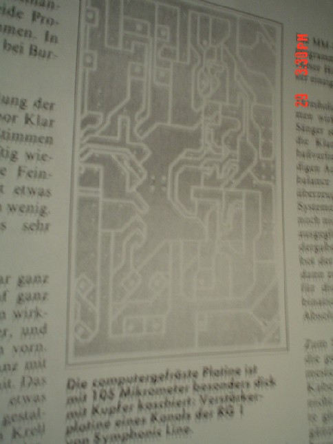

I realize that we all like overkill, but has anyone had a chance to look at the current capabilities of the 2 oz board?

Personally, i am fine with either getting 3Oz boards from Denmark, or 2Oz from the US if that will keep it a single order gb.
Going below 2Oz seems a bit silly after the work Jens did to widen the output traces.
Here is a picture of a 3Oz output board of the SL RG1(1986), i gathered 3Oz or higher is a standard with quite a few pro audio Co's for quite some time now:

Poking around Advanced's website I found that with the current design we should be able to get them to make the boards with up to 4 oz copper. I'm waiting for them to come in so I can find out how to get a proper quote.

Jens if you have done the layout properly 1 oz. will do if it comes to fusing the traces but you really don't need more than 2 oz. (= 70 um or 95 um) For handsoldering I shouldn't choose mare than 2 oz. My softstart has 95 um (minimum) and it's really hard to solder the realys and connectors and the traces are rather short... so don't make it hard to solder.
Hmm - do we really need to consider the heavier weights? The board is laid out so that all high current traces are quite wide. They look like 100 mils or better to me.
Bragging rights are cool, but if they come at the cost of difficult assembly and probable damaged components, why bother?

BrianDonegan said:I would be perfectly happy with 2oz by the sounds of it. Lets order some boards!!
Amen
OK - it seems that 2 oz is plenty (if not too much), so that is settled.
