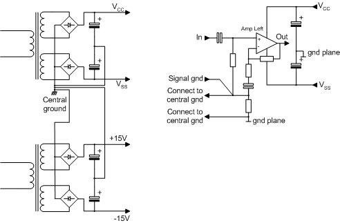

The ground plane is what you will refer to as dirty.
So to sum up the parts that refer to signal ground on the original board:
Input LP filter (already implemented)
FB caps (already implemented)
Zener diode decoubling and zener diodes (missing at the moment)
Could some one please confirm this from the original board (I don't have one)
The ground plane is power ground
There are two connectiones on the board that allow the two grounds to meat at the central ground. There is a 10 ohm resistor between the two grounds on board.
\Jens

To answer my own question about the ground on the original LEach PCB it looks like the ground to the zener diodes and their decoupling caps is in fact the power ground.
Look here: http://users.ece.gatech.edu/~mleach/lowtim/graphics/Compnt1.gif
\Jens
\Jens

re post 273 - ground connections.
My concern was to keep the signal ground free from all/any contamination and to keep the feedback signal accurate.
Any contamination on these will enter the amplifier path & come out as mush, distortion, noise, intermodulation products from sub & supersonic signals & maybe some others that are equally unwanted & avoidable.

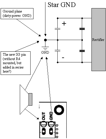

Hello all.
I've studied hard the PCB this weekend and didn't see any major problems (ground loops etc).
Thanks Andrew for post 254, http://www.diyaudio.com/forums/showthread.php?postid=641411#post641411
Now, to go to the core of it.
I like what Jens has done with the new SG pin. Allso Jacco has a nice thing going with the shielded NF cable thingy.
Afyer looking again at the board right now, i just came with this contraption (see attachment).
The ground plane around the input-vas stages does not have a great deal of current going around ( basically only C1 & C2 might drain some current through GND but that in the opposite direction, towards the power section) so no parasitic EM waves to disrupt the sensitive stages. And the voltage drop acros this GND section is too small (read allmost 0) to count on adding to the refference input voltage.
Therefore i thought of not mounting R4 on the PCB GND but instead use a shielded wire to the Master Star Ground with R4 inserted there. Both wires from this cable are tied together at MSG but only the inner conductor at SG.
Now this achieves (in my mind atleast) isolation between grounds.
Anyway, from my "meditations" it didn't had that much to gain over the current method (R4 on board).
Please put me to order on any thing i may have gotten wrong
