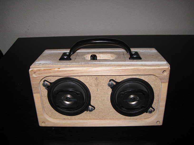

How about a pair of 3-1/2" coax speakers?
