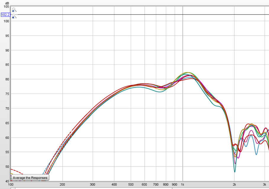

To rule out cabinet effects, try to measure on-axis and watch that peak when you move the mic closer/further as well as higher/lower. See if it stays put or shifts around. I don't know why the peak should drop like that due to anything in the ports -- directivity effects near that frequency should be happening from more near to the end of the waveguide mouth.
Bill, any chance that's a combination of a resonance (on-axis boost) and path-length differences (off-axis null) from the mid ports?
Dunno, maybe. Horn Response (not sure I have the same model from then) shows if the port is too small/too short/too close to the throat that can give a peak about there. Maybe try some modeling clay to "lengthen" the ports and see what happens?
Doubt an off-axis null could be there, though. It could only happen from the distance of the ports from each other (tweeter isn't playing!), you'd have to get about 5 inches closer to one than the other from being off-axis for that to happen.

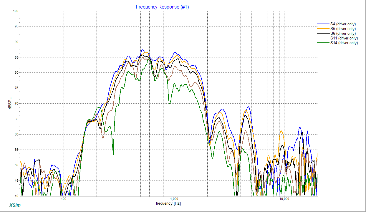

Yeah, looks like something off there. Here are some horizontal curves I have from a few years back (done indoors, unsmoothed, angles are 0, 20, 30, 45, 60).
What happens if you move the mic closer/further? (thinking cabinet edge diffraction maybe).
Do you have any absorption in back of the cone? I had a dip like that in my first Synergy proto and it turned out to be a reflection from the panel in back of the driver coming back through the cone and nulling at the mid port hole. Does the null freq correlate with the distance?
3ll3d00d - are you sure the midrange driver is sealed against its mounting surface? Maybe an air leak could do that (guessing)
i'm not sure how to verify that definitively but it certainly seems a very firm/tight/complete seal3ll3d00d - are you sure the midrange driver is sealed against its mounting surface? Maybe an air leak could do that (guessing)
I took some more measurements, different location as I had to do it inside but with the mic on axis and then moving both left and right & up and down (to an extent of about +/- 1m). No obvious difference in that hump.
so then I took some quick and dirty off axis measurements at ~40 and 60 degrees both left and right
it was a bit rough and ready but still no sign of a dip, just a softening of the hump.

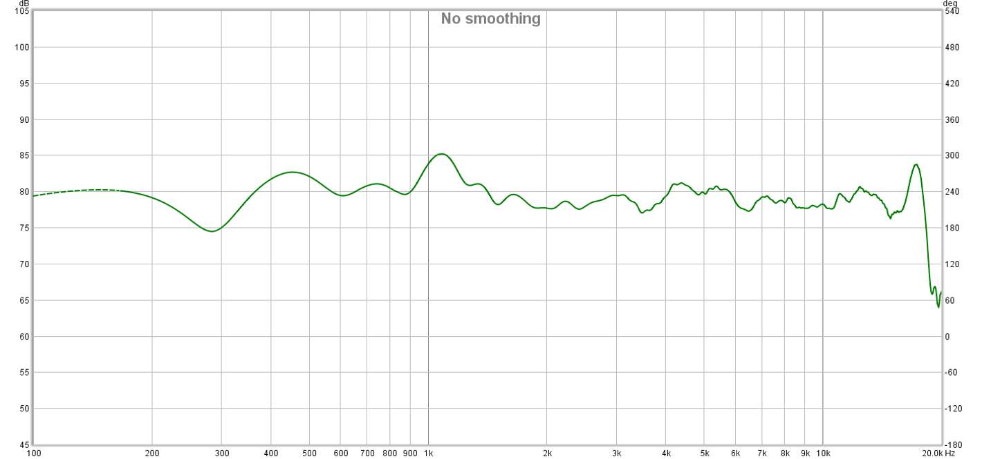

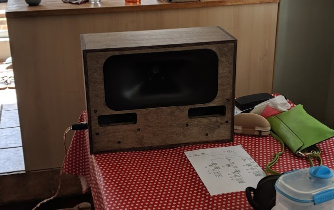

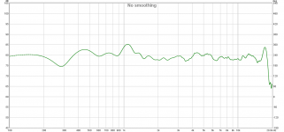

I finally got one one up and running
quick on axis FR in my kitchen to check it was wired up ok
and the xo I have atm (which was tweaked a bit from the original design as my measurements showed a slightly different response shape with that XO, particularly on the CD), sims maintain v similar directivity pattern to the original though which I figured was the thing to aim for.
I will be running this with DSP so decided to leave that peak for DSP to fix
need to get it outside to measure it properly but will need to leave that for later in the week
Sure, but the directivity won't be uniform below about 900Hz anymore. The woofer array trick depends on the woofers being spaced properly, which is why they are partly behind the waveguide and feeding through close-in slots.
