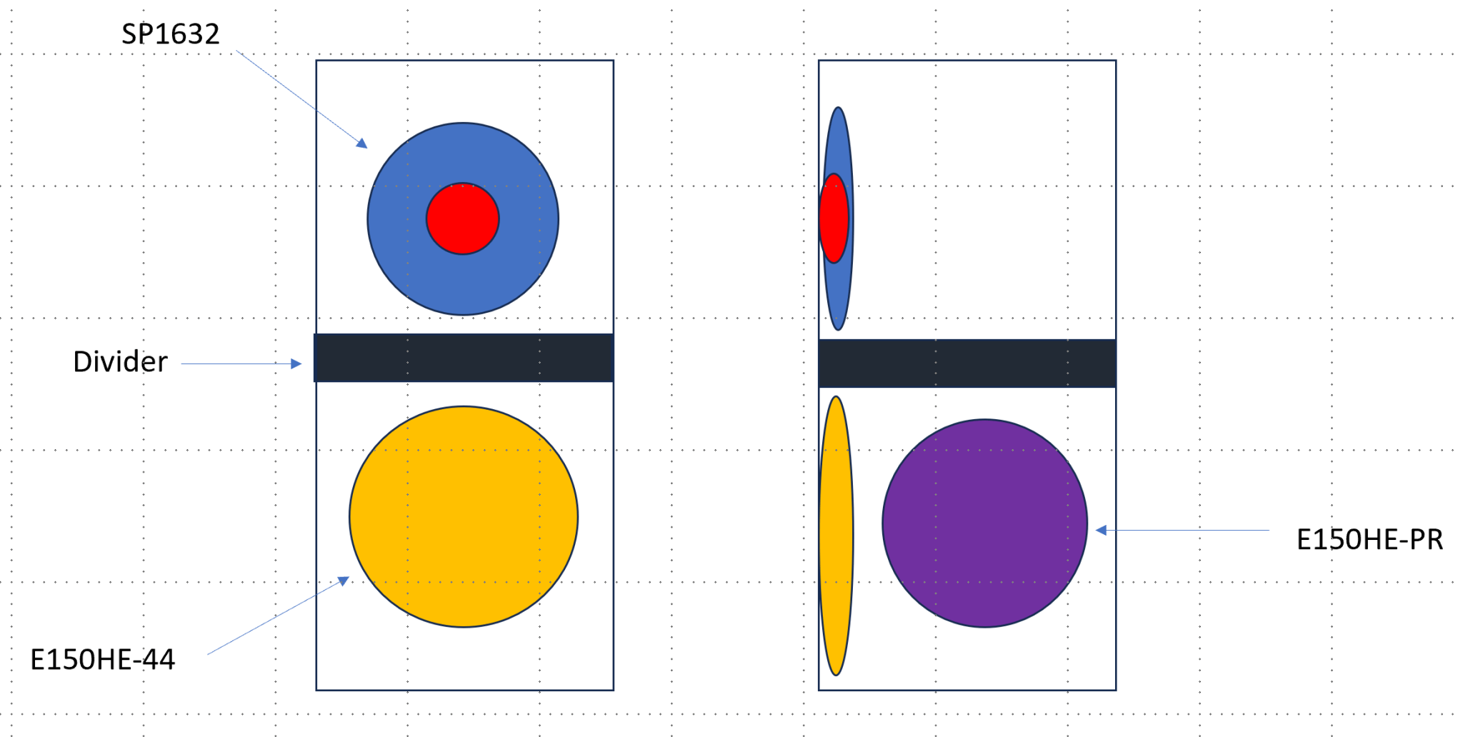

A pair of passive radiators in horizontal opposition would be one on each side of the cabinet.
The coax and E150HE-44 would be on the front side as closely spaced as possible, the cabinet elevated to ear height at your primary listening location.
My bad. I thought you meant as in "in the same enclosure."

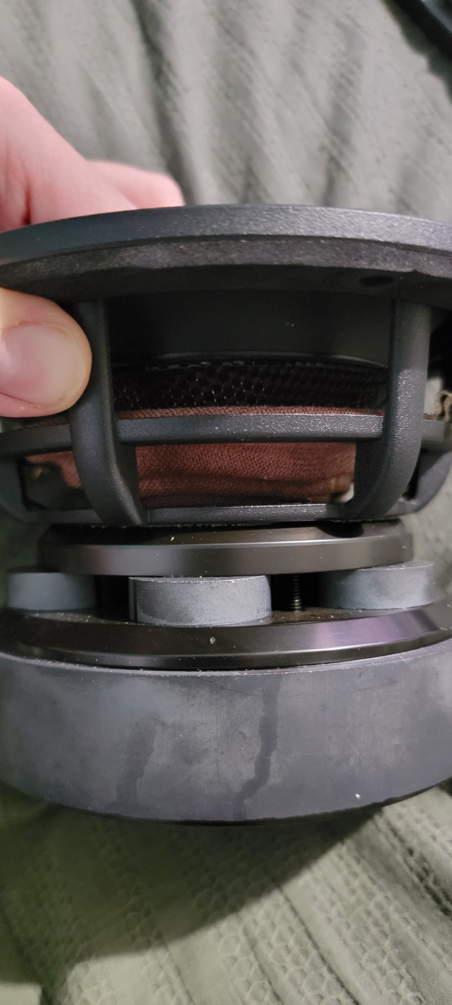

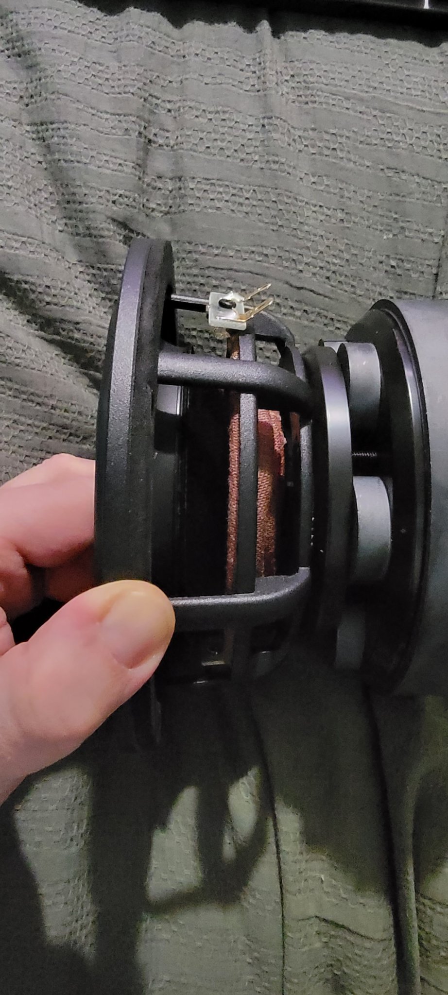

I gave Dayton a call this morning. Apparently for the E150HE-44 the Xmech/Xlim is just double Xmax (29.4mm). Additionally, I know we had talked about MFB before and asked them if there was a way to remove the dust cap (although it would void the warranty). It's just regular old epoxy. I thought it would be something different to adhere specifically carbon fiber, but it's not. That said, a little heat and it should come right off.

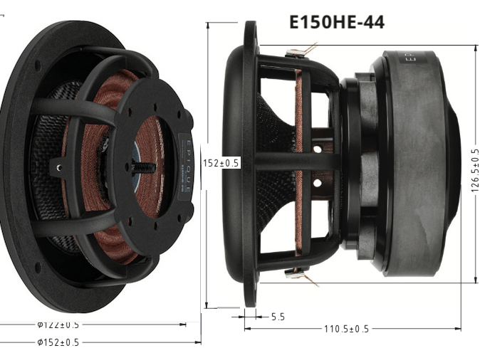

I find it odd Dayton rates the Xmech at just 19mm for the E150HE-44PR, but would then claim 29.4mm Xmech for the E150HE-44. It seems too convenient that Xmech would be exactly double Xmax, I've seen more or less, but never the same.
At around 29.4mm (one way) looks like the cone and spider would both hit the basket's magnet structure attachment ring, assuming the coil former does not hit the back plate first.
Anyway, push the cone in and out and tell us if the person you talked to at Dayton has the right figure.
That said, if the E150HE-44 has 29.4mm Xlim, the E150HE-44PR won't "clunk" until it's rocking almost 59mm peak to peak, over 2.25 inches, and you certainly won't reach that excursion with the TPA3255.

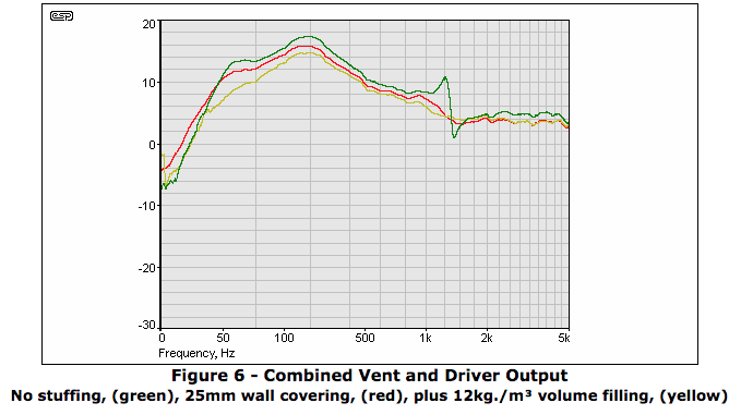

"Stuffing" is used on sealed boxes to increase the apparent volume.
Lining the walls of a vented or passive radiator enclosure to reduce higher frequency internal reflections and resonance may be useful, but stuffing reduces the vent/PR output considerably (3-4 dB or more), to the point where it would behave like a sealed box.
https://sound-au.com/articles/boxstuff.htm

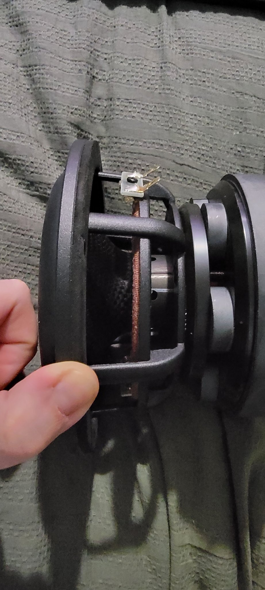

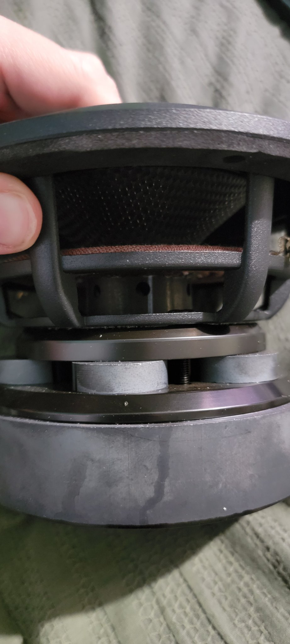

So it looks like the spider is hitting first. When I push it down, it doesn't feel like the coil is bottoming out against the magnet.

You didn't share the Xmech measurement in the push tests posted in #55, but appears to be less than 29.4mm

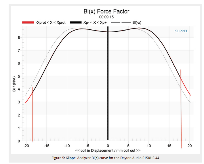

My statement "you will need around 80volts to push the E150HE-44 past Xmax in a box" was not a test recommended for you, it was based on a simulation:
https://audioxpress.com/article/tes...e-subwoofer-from-the-dayton-audio-epique-line
If you use 78/90volts sine wave into the series coils (1000 watts at nominal 8 ohms), I'd expect you would see the magic smoke in a matter of seconds, though peaks in that range should be survivable.
Only 45 volts at 2 ohms (parallel coils) would be required for the same.
Simulations are based on the Bl and suspension behaving linearly, which they are not past Xmax.
Past Xmax, the Bl reduces considerably while the suspension gets tighter and a non-linear amount of voltage is required for further excursion- for all I know it could take 180 volts to push the cone as far as you did by hand.
Oopsie 😅
