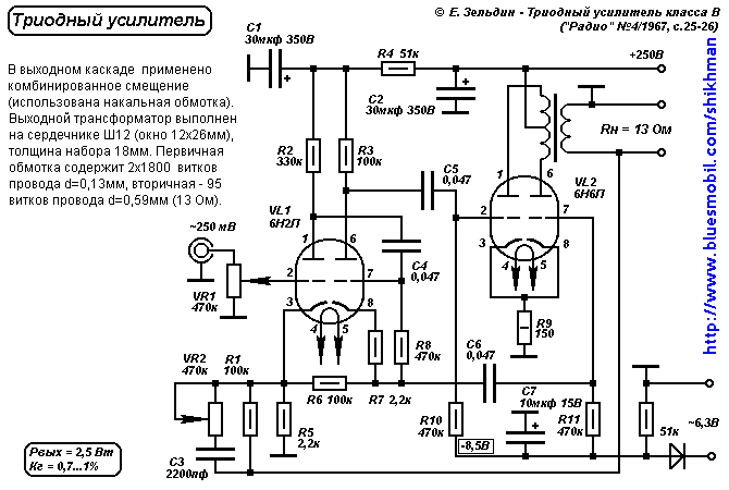

See attached diagram. I tried translating the russian text and was disappointed to find that it describes the OPT in terms of how to construct it. Core, bobbin, gauge of wire, etc. Except for the notation that the secondary has an impedance of 13 ohms.
But the general ideas are sound, I guess. There are a few 6n6p p-p designs out there. You could also search for 6h30pi designs, iirc it's in the same family.
6n2p is of course a soviet 12ax7.

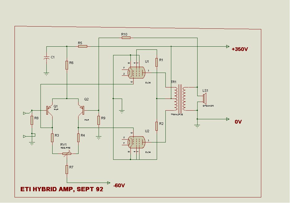

I'm thinking about how I want to drive the output tubes. I'd like some help to evaluate some hybrid options - using some SS parts.
Well, if you want to keep things really simple, then this approach makes a lot of sense:

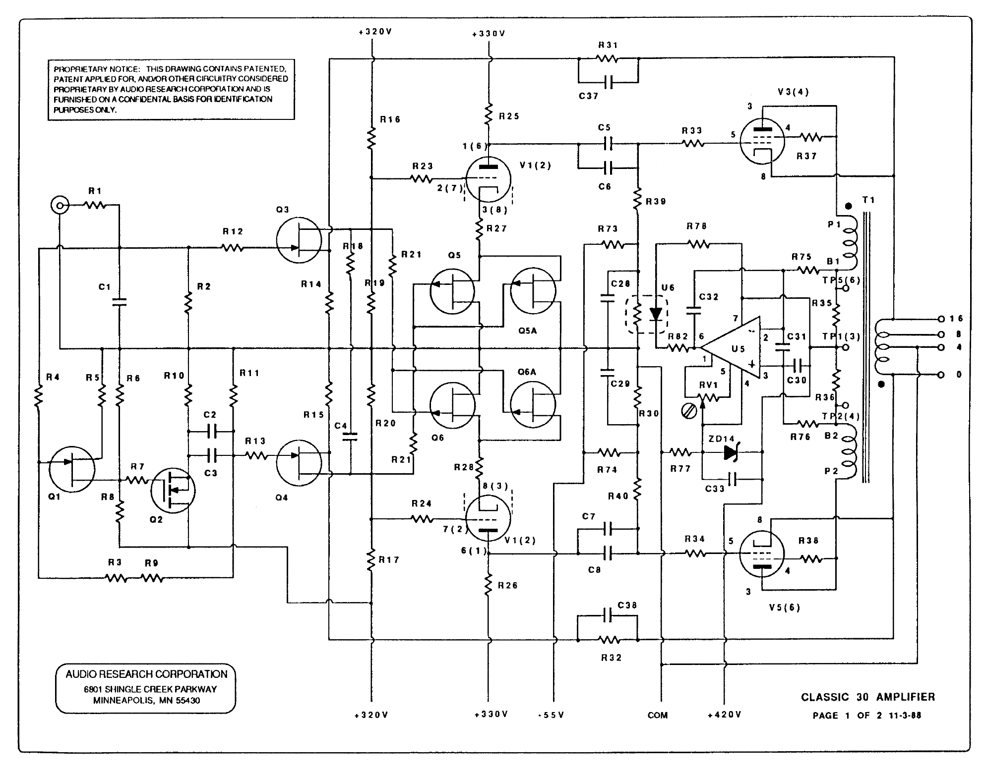

Does anybody have comment on the ARC Classic 30 design ? - why they chose their approach. They have a two-device inverter up front, then a JFET based cross-coupled phase splitter to some driver triodes - it all looks very complicated. Can a simple CCS loaded LTP be a better approach (sonicaly) ?
The ARC schematic is attached. I re-drew the inverter to make it easier for me to 'see it' and posted that previously in this thread. There are good reviews of this amp which is why it has my interest.
I know a small cheap OPT is not an option with cathode feedback, but it is the front end of the amp design they have that I'm looking at now.
I think they found a source toroid transformers, so decided to add some balancing opamp. Speaking of an input, it resembles Audio Research, where they inverted "phase" by a tube inverter stage with parallel feedback. I do not know, probably it come from so called "Transformer-less balanced input" where the fashion is to use an opamp to invert the "phase". They selected currents for driver tubes higher than could be delivered by JFETs they had in their bin, so they decided to parallel them.
Of course, I am guessing. 😀
They are using balanced feedback from the OPT secondary, returned to the sources of Q3 and Q4. This requires that Q3 and Q4 be driven by a balanced signal. That is why they have the inverter driving Q4, with Q3 being driven directly from the input.

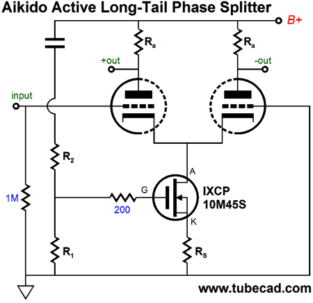

How about this solution to the B+ problem ?
More Aikido Active-Tail Phase Splitters
I haven't seen anybody actually use this approach. And when you modulate the tail of an LTP you create a Mixer, not sure if this is going to work ?
That's probably not a bad idea, though I was talking about ripple affecting the output stage not the phase inverter. However I would be concerned about the low drain-source voltage resulting in variable capacitance that could introduce excessive distortion at high frequencies. Not sure, I never played with that type of circuit before, or the 10M45S. Usually I would just use an RC filter to the splitter supply with a large C although in this case, with low B+, it may be more difficult to keep R high enough to offer much filtering so this circuit might just be the ticket, assuming you can get enough voltage on the FET's drain. This would likely mean having to use medium mu triodes. With high-mu triodes you probably won't get more than a couple of volts on the drain.
Just a R-C with source follower to power all your amp, that's it. Are you going to have a chassis? A heatsink! 🙂
