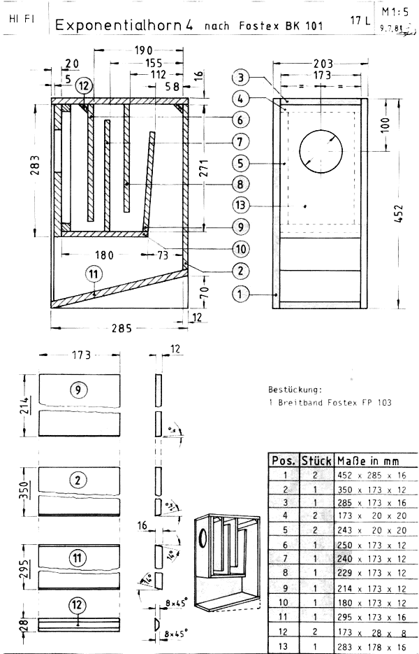

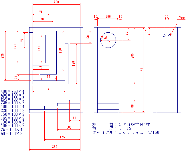

Another one , found in my digital library.
well it refers to a fostex T150, have no Idea what that is....
but what do you think of the design? How much does it help with the responce?

The design is called :" T150 " , supposed to be for the FE83 (older then FE83e)
Try Google "FE83e jp" pictures, you find a lot.
The Japanese love those little drivers and have alotof designs for them.
For the sound , I don;t know ; the CC is a bit bigger then my design, line lenght and the rest is about the same.
Most of the time the CC is chosen too big, and is reduced later to adjust the transition.
Scott can explain this better then I can, my English is not sufficient .

Depending on how low you want to go and how small you want it but the Fostex BK10 / BK101 is a design that can sing with a number of different drivers. Add a sub and you might not want anything more.
