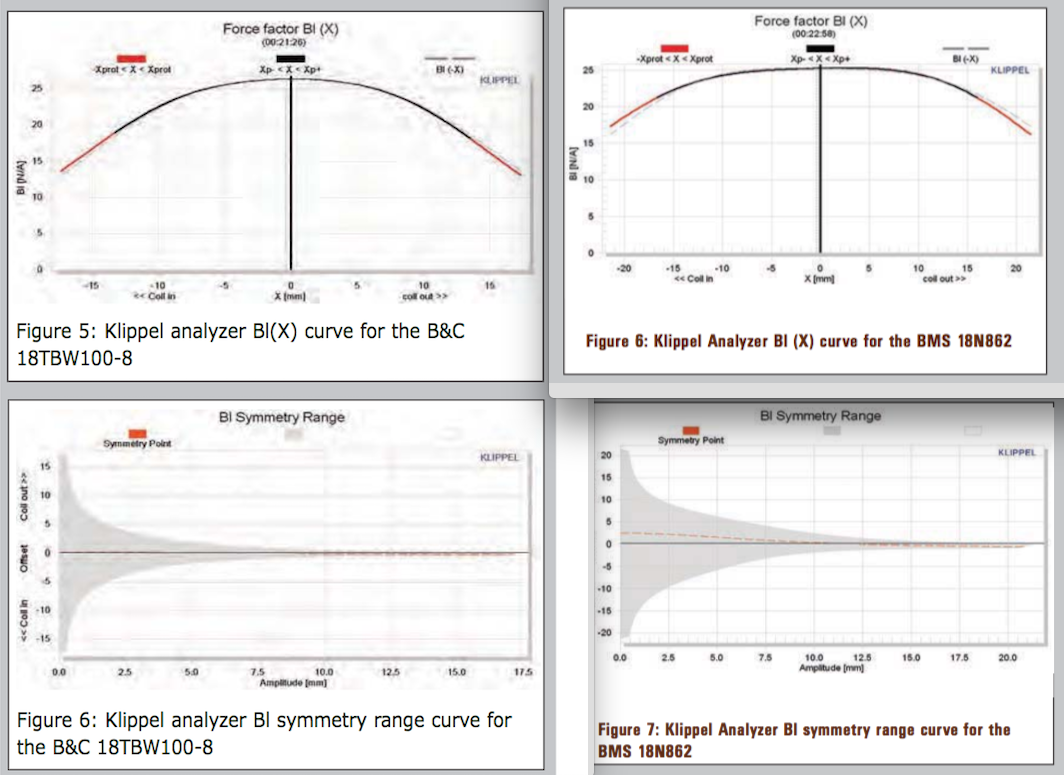

B&C does provides Winding Depth and Magnetic Gap Depth on their spec sheets, but Xmax is not derived from those numbers, it is measured according to the AES2-1984 standard, corresponding to a maximum of 10% total harmonic distortion (THD) with a sinusoidal signal.
The “Xvar” value reported by B&C is measured as when the magnetic field seen by the voice coil, or the total suspension compliance, or both, drops to less than 50% of their small signal value.
Xvar can be more, less or equal to Xmax.

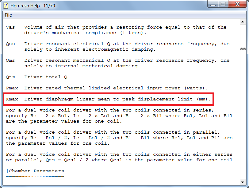

You are missing the whole point. You need to understand this as it is crucial for any discussion. B&C did not lie. They said 6mm Xmax. That's the absolute excursion, or in other words, peak-to-peak. That makes it 3mm to each side. You can add x% to it if you want but that does not add up to +/-6mm in any possible way. The simulation relies on said +/-6mm (or even 7,5mm) while the driver does actually only do the half of it!
Yes, definitions are crucial for any discussion, and you are mistaken. I made the same mistake years ago- no bull!You are missing the whole point. You need to understand this as it is crucial for any discussion. B&C did not lie. They said 6mm Xmax. That's the absolute excursion, or in other words, peak-to-peak. That makes it 3mm to each side. You can add x% to it if you want but that does not add up to +/-6mm in any possible way. The simulation relies on said +/-6mm (or even 7,5mm) while the driver does actually only do the half of it!
Xmax is by definition one way excursion, not peak to peak, a 6mm Xmax is a peak to peak excursion of 12mm total. You can measure excursion by placing a white dot near the edge of a cone, persistence of vision makes the movement easy to track.
Mechanical limitations of drivers are often quoted peak to peak ("travel"), though Xmech, or Xlim are also one way measurements.
Most modern PA woofers have Xlim around twice Xmax, and usually the suspension, rather than the coil smashing the back plate is the limitation.
Art
This is my understanding also. It is the definition used in Hornresp.

Yes, usually it's one side excursion. And to my understanding it should always be that way. But by no means that's the definition, it can be both, if you don't specify it. In my opinion these values should always have the +/- or p-p notification to be absolutely clear. There are manufacturers who give the p-p value like Seas (PDF) but also say it's peak to peak. B&C does not say p-p but they do not say +/- either. If you are unsure, calculate it yourself.

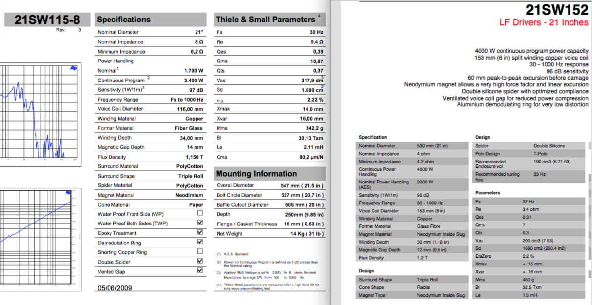

Now just look at the datasheet and calculate the Xmax yourself, as I said, be generous if you want and add x% to it. Please tell then how you come from the mathematically 3mm to 6mm or even 7,5mm.

4)Now just look at the datasheet and calculate the Xmax yourself, as I said, be generous if you want and add x% to it. Please tell then how you come from the mathematically 3mm to 6mm or even 7,5mm.
2) Though your example of Seas is clear in this discussion, others not noticing or understanding "(p-p)" may assume the driver to have double the Xmax and Xmech it actually has- the numbers must be divided by 2 to use in Hornresp.
3) B&C is inconsistent in their spec sheet nomenclature, some include +/- in front of the Xmax and Xvar numbers, others don't. Some use commas (,) rather than periods(.) which can throw USA folks.
4) I have done the mechanical derivation of the 6ps38 as well as many other B&C drivers, and it is obvious that in no case do they use the 1981 era mechanical derivation to determine Xmax, it is measured according to the AES2-1984 standard, corresponding to a maximum of 10% total harmonic distortion (THD) with a sinusoidal signal.
Having not personally tested the 6ps38 I would not swear the spec sheet is not mistaken, but the fact that the Xmax happens to be double what the mechanical derivation is could simply be coincidental.
As examples, the B&C 21SW152-4 would have a mechanically derived Xmax of only 9mm, while it's specifications are 15mm Xmax and 16mm Xvar, nearly double.
The B&C 21SW115-8 would have a mechanically derived Xmax of 10mm, but is rated for 14mm Xmax and 16mm Xvar.
Obvious from the measured results, there is more to Xmax than the "easy math" would suggest.
B&C (and no doubt other manufacturers) use coil winding formats that were not employed 37 years ago when Mark Gander suggested the mechanical derivation for Xmax.
Klipple analyzers were not available then, they have been instrumental to design practices that have increased linear excursion to far more than typical four decades ago.
At any rate, like Jimi sang back in those days: “if a 6 turns out a 9, I don’t mind” ;^)
