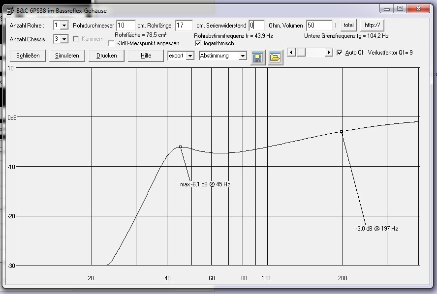

Your simulation looks very close. The differences could even be just measurement tolerances. Well, if I simulate the 'close' B&C 6PS38, however, I come to this:
If you simulate a different driver in a different alignment, you'll get different results.
The t/s parameters of the driver Chris is using work out as per the attachment. Can your program sim in in the slot-loaded box that Chris is considering?

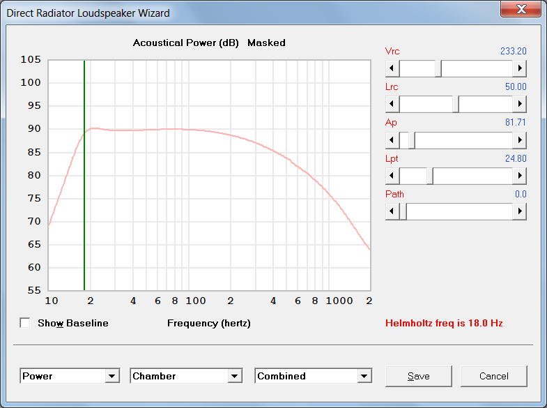

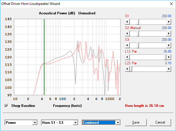

The Hornresp sim suggests that the slot loads the drivers and there's an increase in output all the way down to the 40 Hz corner. See attached - the effect of the slot on the enclosure's output is shown by the grey line. Remove the slot and the response looks at lot like what your sim looks like (the red line), particularly when you consider that Hornresp does not include the effect of box losses in its sims (hence the slightly higher rolloff) and your program apparently does not include the impact of organ-pipe resonances caused by the vent and the enclosure.
It's pretty much the same like this sub here, they say 110 dB SPL (116 dB SPL peak). Well, still 1dB more.
Like most commercial subwoofer offerings, that peak SPL rating is likely a marketing figure. One could as well claim that Chris's design can hit over 120dB peak. That's over 80 Hz according to the sim, but still .
Yes, it does give a boost but that's pretty much over as soon as you leave the nearfield. Besides that, it does not give anything at the lower end and still does not increase the maxspl, that was already in his calculation/simulation included (and you probably noticed I didn't subtract it).
Edit: A boost of over 4dB at ~180Hz? I do not believe that. Not at all. That's more than some BP subs get. Please show me a measurement of a similar box.

Why would that be? The slot and the vent both have the same CSA. I'd assume that their contribution to the overall SPL will remain the same from nearfield to farfield, unlike the case of a standard vented box, where there is usually a noticeable difference in the area of the driver vs the area of the vent.

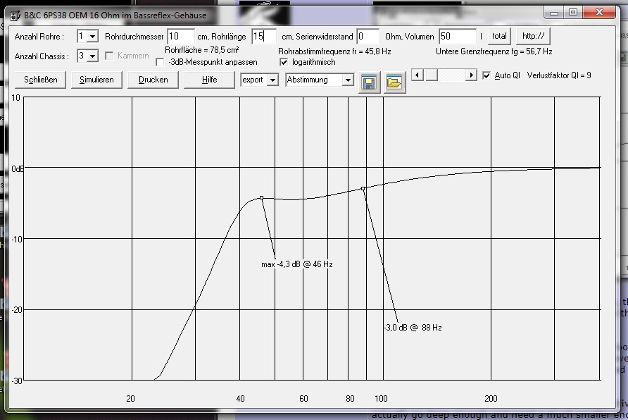

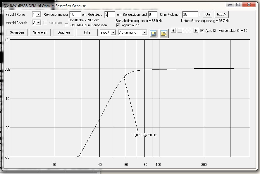

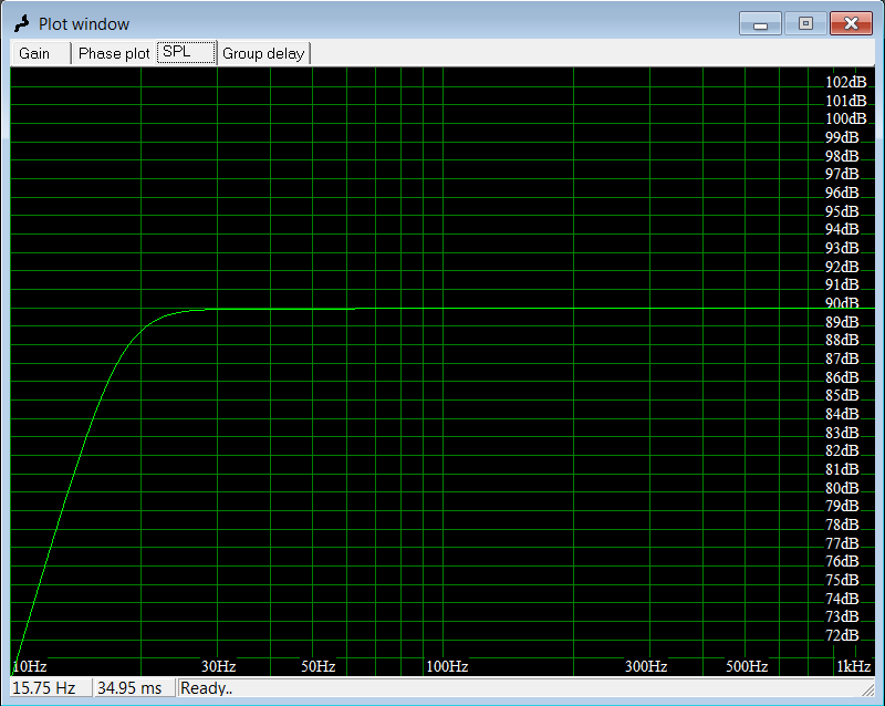

Hornresp isn't very relyable in terms of bassreflex. Use WinISD or BassCADe or similar programs.
Interesting.
Based on the simulation models used in the programs mentioned, I would have expected Hornresp to be the more accurate at predicting low frequency performance.
Attachment 1 shows a bass-reflex system simulated in WinISD. Attachment 2 shows the same system simulated in Hornresp with resonances masked.

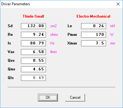

If you read my posts again, you'll see that I've measured the T/S parameters, and posted them.

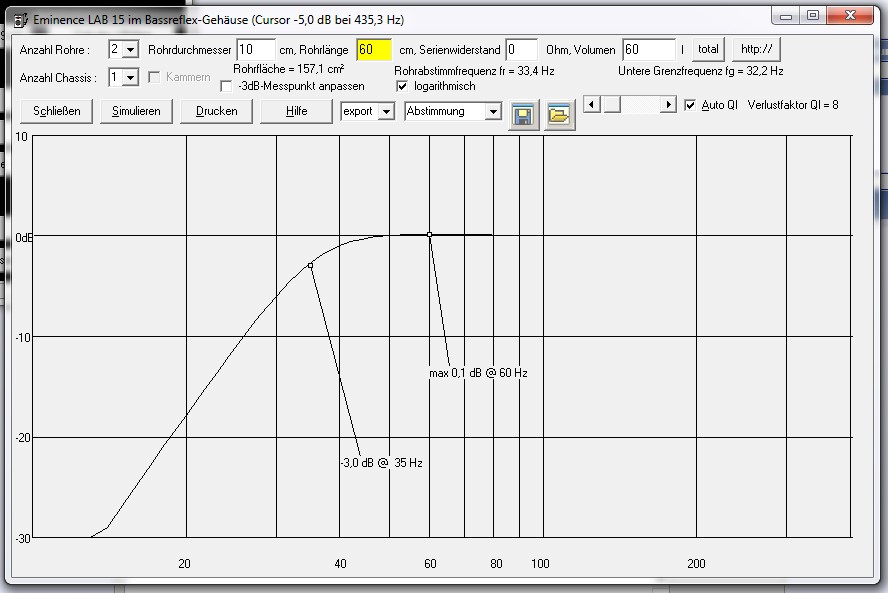

I ran a quick simulation of a LAB12 in a box similar to this (actually, I just dropped the T/S parameters into this box, and then played around a bit). If you double the size of the ported chamber and then apply 40v instead of 30v, you get 6dB more at 42Hz, and 4dB less around 70-90Hz. The response has a big peak at both ends.
So, double the box size gets me more bass. Nothing new there, then, and I'd hardly consider that "destroyed", either.

1 - You never posted the T/S parameters in the first place. No Qts, Qes, Qms, Vas or Fs! I took the parameters Brian Steele posted.

3. The OP stated in post #1 "Output on two faces makes positioning more difficult when they might be used in any venue you can imagine."
The "smaller spaces, or venues where keeping the PA system near-invisible is important" I have worked in, or can imagine working in, don't require, or usually desire subs with more output than what Chris' little 3x6" can provide.
There are in fact 18", 15" and even 12" subs which actually deliver 120+dB at 40 Hz. Aside from that, you said yourself the planned sub maxes out at 65Hz - which other subs do not. And, I have to add, a lot of these subs can be EQ'd on the tuning frequency which extends the low end without exceeding the Xmax.
Data-Bass
You're welcome to try and find a single 12" cabinet that'll do the 125dB "peak" you suggest from 40Hz and upwards, or even the 122dB "program".
Let me try and make this really, really clear, since I don't think you're getting it: all ported subwoofers will run out of excursion above the port tuning frequency when enough voltage is applied.
In the case of the design in question, it's 30v at 65Hz. Every other ported cabinet on the planet has the very same issue. You can go through your own simulations and see for yourself.
Please please go through the simulations and make sure you understand this, because I feel like we're going around in circles and you're missing the point.
A LAB12 in a ported box tuned to 40Hz will do 120dB at 55Hz, and that's excursion-limited.
A Beyma 15P1200Nd in a 40Hz box will do 124.6dB at 59Hz at Xmax.
This box will do 118dB, excursion-limited, at 65Hz.
Note that these figures are only problems if the program material is sine waves at the worst-case frequency, and all the cabinets can therefore be expected to put out a little more SPL when wide-band program material is used.
To answer some of your other points:
- It was a pair of the 10" active speakers, no subwoofers.
- Your LAB15 simulation is at least 70L internal, once you've added the ports, and you haven't included the 2.83v sensitivity. 95dB@2.83v@40Hz, 100dB@2.83v@100Hz to beat.
- I trust B&C's assessment of the excursion limits of their drivers. You can feel the suspension start to lock up as you go past about 7mm of excursion. Talking about the motor geometry misses out a lot of important stuff. You might find that there's 2mm either side of the gap where the magnetic field is 90% as strong - the motor force doesn't switch off as soon as you move a tiny bit of coil out of the magnetic gap.
- I'm not complaining about anything. This is an interesting discussion, but I do think there's a hole in your understanding that I hope you rectify.
Well, I feel I have to answer that one still. Look at their datasheet (PDF). It leaves absolutely no doubt about 12mm winding height and 6mm pole plate thickness. They did not lie. They wrote Xmax, not +/- Xmax. They just didn't write what you wanted to read out of it.
ICG,Well, I feel I have to answer that one still. Look at their datasheet (PDF). It leaves absolutely no doubt about 12mm winding height and 6mm pole plate thickness. They did not lie. They wrote Xmax, not +/- Xmax. They just didn't write what you wanted to read out of it.
B&C told no lies about winding height, plate thickness or Xmax and Xvar.
If you want to believe the B&C 6ps38 Xmax is "wrong", you'll also have to throw out all the rest of their (and most everyone else's) woofer's Xmax ratings.
Deriving Xmax by subtracting the height of the voice coil winding from the height of the magnetic gap and dividing by 2 ignores magnetic and mechanical non-linearities and asymmetry, so has not been much in use since 1981, after which the measured approach started gaining traction. I can still remember when Mark Gander of JBL gave me a "top secret" paper about how to design ported cabinets using TS parameters back then...
B&C does provides Winding Depth and Magnetic Gap Depth on their spec sheets, but Xmax is not derived from those numbers, it is measured according to the AES2-1984 standard, corresponding to a maximum of 10% total harmonic distortion (THD) with a sinusoidal signal.
The “Xvar” value reported by B&C is measured as when the magnetic field seen by the voice coil, or the total suspension compliance, or both, drops to less than 50% of their small signal value.
Xvar can be more, less or equal to Xmax.
