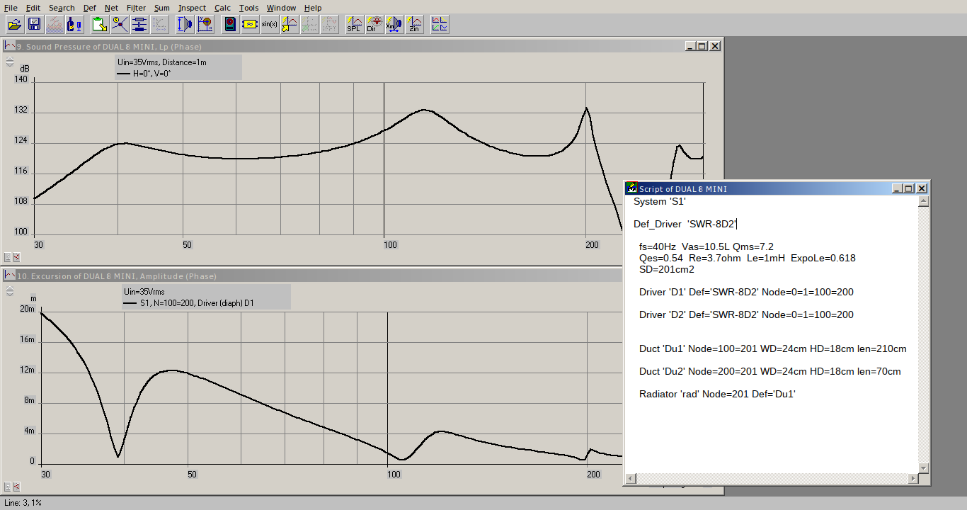

Which simulated pretty well - around 115dB from 40Hz upwards, with 30v into all three drivers in parallel. I liked the square form-factor etc. However, I wasn't so keen on having the port on one side away from the drivers. Output on two faces makes positioning more difficult when they might be used in any venue you can imagine.

Here's what Hornresp thinks they'll do:
That's 30v input, and touching Xvar (B&Cs version of Xmax) at 65Hz. Not a bad little box. Some EQ will be needed to level out the response, since there's 8dB of difference from the top to the bottom of the useful range. That's all easily done, though, since there'll be some form of digital processing available.

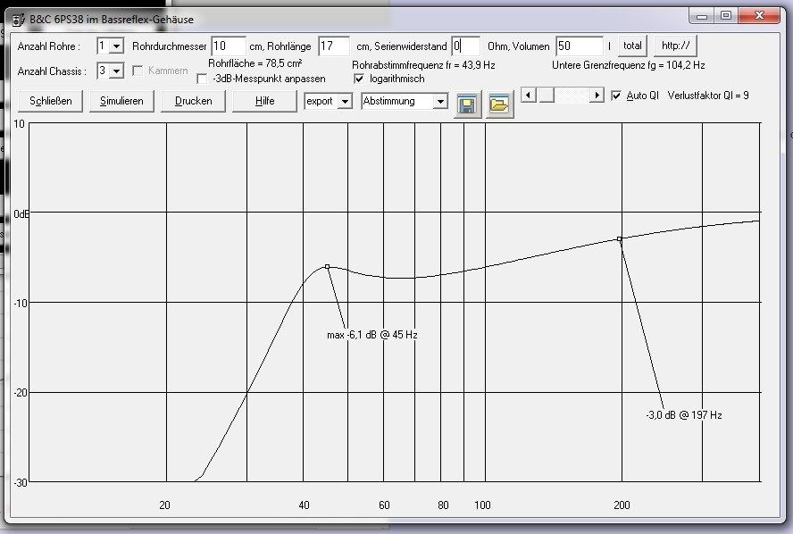

Hornresp isn't very relyable in terms of bassreflex. Use WinISD or BassCADe or similar programs. I doubt you'll get a usable, half-way clean tuning or that spl.
A 8dB difference is HUGE! 😱 It's not the question if it can be done (that's easy), it's the question if that is actually usable (hardly ever, honestly). I'm not talking about the settings, I talk about compression, thd and power-compression.

Uhm, please, please simulate them first. (not in hornresp)
I'm afraid you'd be disappointed.

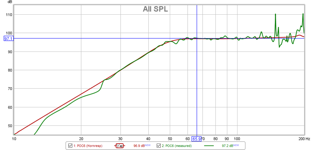

What makes you say that? Every build I have designed using Hornresp has come out close to sim'd, when the effect of losses is taken into consideration. Why would designing a bass reflex via Hornresp be any different?

Experience.
It works as long as you are not using too extreme boxes and as long as you have precise parameters. Both isn't given for this project, a 16 Ohm driver with just 0,26 mH? Similar drivers with 16 Ohm are closer to 0,7-0,8 mH. So yes, hornresp can do that but not with the wrong parameters. Other simulation software solutions calculate it differently and get better, much closer results in such cases.
I don't think any simulation program will give good results if you enter the wrong values for the parameters. GIGO...
While that's ofcourse true, BassCADe & co are still closer and hornresp might create the illusion of having something that would work.
Hmm.. if a simulation generated by one of those programs is "closer" with the use of incorrect values entered for the driver's parameters, I probably won't be using it for long 😉
Hornresp has been accurate enough for my needs. Pictured is the sim'd vs. measured response for my POC6 build, for example. The measured response has some noise in it due to the conditions under which the measurement was performed, but the results are close enough for my needs.
I've only come across one example where measured results don't match the sim. However in that case the sim was only an approximation of the build.

Your simulation looks very close. The differences could even be just measurement tolerances. Well, if I simulate the 'close' B&C 6PS38, however, I come to this:
Do you see that bump at the end? That will get you, that sounds really bad and it becomes much worse with the power compression. And the excursion and the hole in the response/spl above it is no laughing matter either.
I've simulated a whole bunch of variants and none looked even remotely like the hornresp result, none are clean or usable for more than moderate party level. And none of the other PA drivers of that size will get you much better results, they aren't designed to play that deep, they are intended for tops/sat and small enclosures.
You'll get better results with hifi or even car audio drivers and while I'm not a fan of the latter, they will actually go deep enough and need a much smaller enclosure, 70x53,6x20 isn't exactly 'invisible'. I'm ofcourse not any kind of reference but that size and that low max-spl are exactly the opposite of the listed design targets. Just to be clear: I would not use hifi- or car-speakers either, I'd use actual PA subwoofers.
