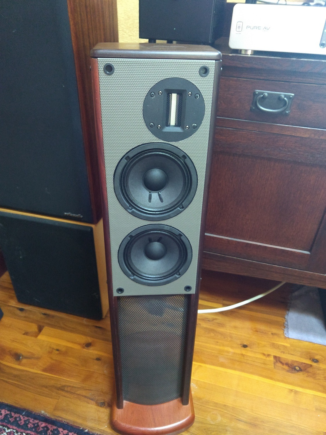

So I've built these speakers three years ago and have been happily listening to them...........so I figured I should post an update.....

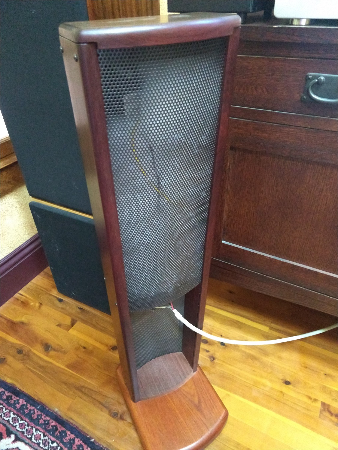

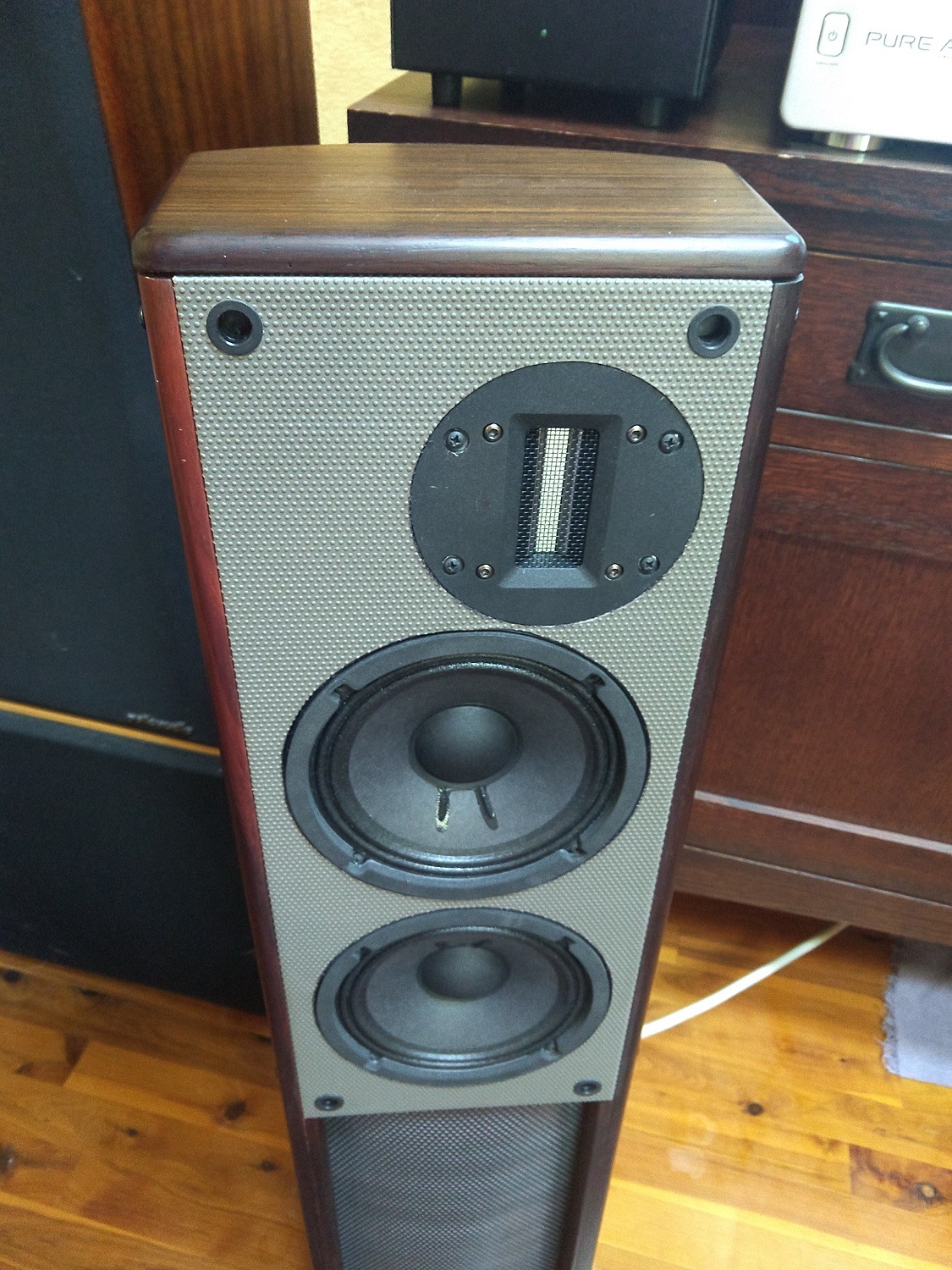

A pair of 16 ohm 6FE200's wired in parallel and a neo CD 3.0 with an open back stuffed with some polyfill.
I'm using a basic MiniDSP 2x4 and crossing them at 5000hz 4th order L-R.......and they image and sound great, better than anything else I've had. I've been playing with other slopes and freqs and I'm now thinking about putting a baffle step comp circuit on the lower driver with the thought that perhaps it could image even better..if that's possible.
I've started playing with rolling off the 6FE200's on the bottom at 200hz/12db since I'm running a sub as well.
As expected, the vertical off axis response is very noticeable; when you stand up the imaging/phantom center is pretty much gone.......I've tried other crossover freqs and slopes but I'm not noticing much difference here.
So I'm open to suggestions to other things to try to get these to sound even better, but again I'm quite pleased with them the way they are.
